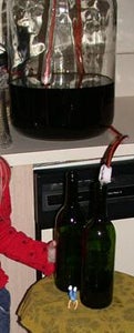

Step 8: Bottling
DAY 28
So you've taken your secondary fermenter (carboy) out of the closet and back onto your counter top. If your carboy is glass you should be able to see the sediment that's fallen to the bottom, and the remainder of the wine is now pretty clear. The most common complaint I hear from people is "homemade wine is cloudy", this is usually followed by a wine snob saying something about "homemade wines have too much sulphite". Wrong. So wrong.
ALL wine has sulphites, it's part of the clearing process. If you are opting to omit the suphite, sorbate, bentonite, or any of the other guys you are asking for cloudy and unhappy wine. Sediment in the bottom of the carboy is a great sign, it means that the chemical bonding of the particles has occoured and your wine will be clear and tasty!
I know I said that the first step of making wine was the most labourious, and I'm not lying. Honest! But if you choose to bottle your wine into 750 ml bottles then you may call me a liar.
That's why all my wine is consumed from 2 litre bottles and sometimes from wine bags!
Regardless of how you choose to bottle your wine the process is identical.

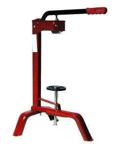

Sanitize your siphon hose, and your bottles. Once you've sanitized everything keep your sanitizing solution around to dump your corks into.
Just like before when you racked your wine from the primary to the secondary, keep the siphon hose from touching the bottom of the carboy as you'll suck up sediment which will turn everyone off drinking the bottle that it ends up in. The easiest way to accomplish bottling is to keep the end of the hose about 5 inches off the bottom and stuff a rag in the neck of the bottle to prevent the hose from creeping down. If you have a second pair of hands they can just hold the hose for you. As you get close to emptying the secondary slowly move the hose closer to the bottom, tipping the carboy to one side helps here.
I'm not going to sugar coat it. Learning to siphon while not touching the bottom of the carboy alone is an art in itself and worthy of an instructable. However difficult it is not impossible, so don't give up.
Bottle, bottle, bottle. Then when you've finished cork, cork, cork. Leave the wine upright for a day to let the corks settle and expand back into place. After a day you should lie them on their side to maximize the airspace in the bottle which helps in aging the wine.
