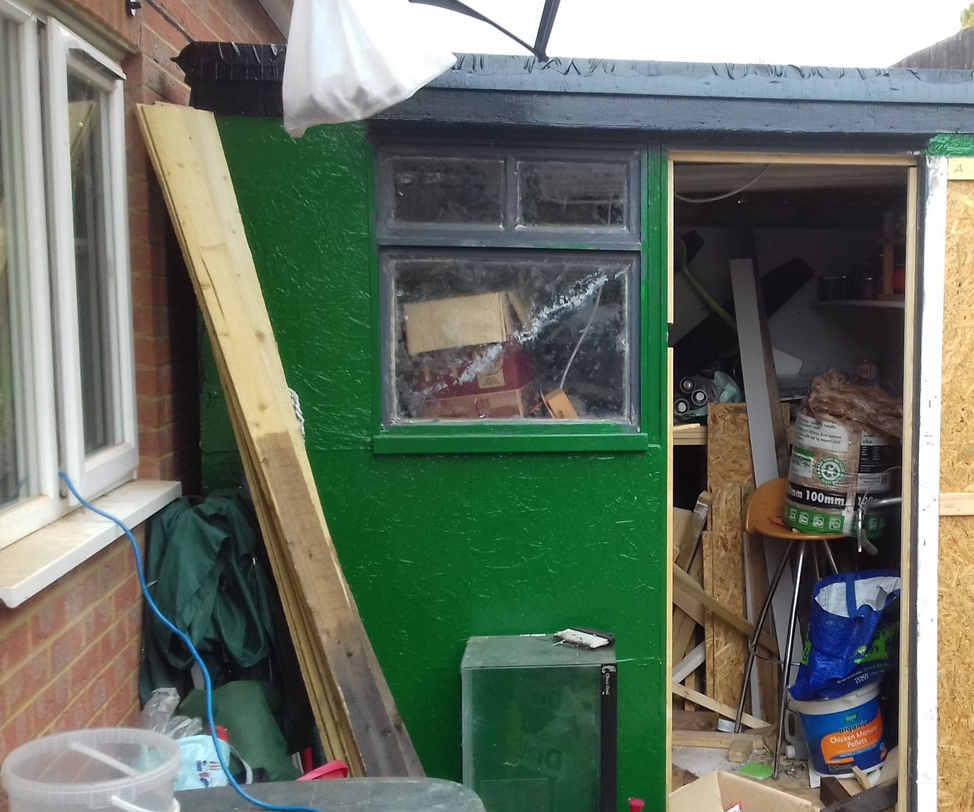

Now if you are using a foot pump car tyres take a lot of getting up to pressure to start with. Even a small one is quite bulky ok if you've got a shed. But is your partner or your mother going to let you keep it in your bedroom or the living room?
The other problem when the pressure drops you've got to stop and pump it up again ok with grit blasting but not with a paint mix that needs using before it sets. It is quite straightforward to fit a second valve to a wheel rim so you can keep it up to pressure with a foot pump as you spray but it is still bulky what is needed is a smaller air tank
