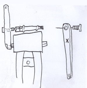

Step 2: Crank Shaft Assembling
You can then assemble the crankshaft into the bottom bracket, as you would normally build a bike.
You can then attach one left crank to one side of the square axle using the smaller screw

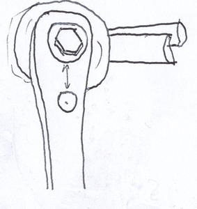

Step 3: Mounting the Second Axle
In the crank installed, drill a hole 38mm away from the shaft with the 8mm drill bit.
Make sure the hole is well parallel to the installed crankshaft. You may need to use the file and saw to get rid of the plastic that's around the crank
You can then, using the longer screw, assemble the second square axle (see the video at the end for clarification).

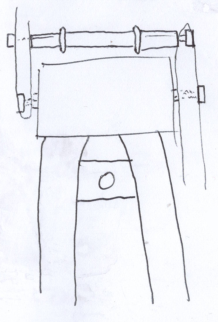

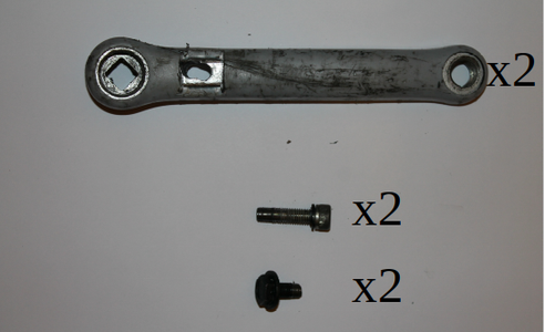

Step 4: Mounting the Second Left Crank
The drill a 8mm hole in the other left crank, 38mm away from the square shaft hole.
Using the two remaining screws, tighten the second crank to the two shafts like shown in the video and drawings

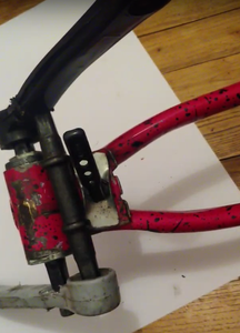

Most of the mechanism is complete, now we just need to hold the metal firmly
Step 5: Metal Attach Point
Using the kickstand and the saddle collar bolts and nuts, pass through the normal kickstand attaching point of the frame.
The build is now complete :D
