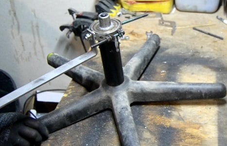

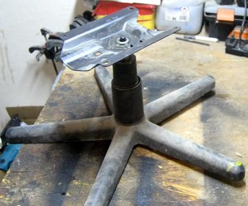

Remove all unnecessary parts of chair. Everything that must remain are the legs, the actuator, and the seat support.
Step 2:

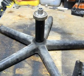

Lock the actuator so that it does not rotate and mount the bearing on the chair's armrest.
Step 3:
Mount the phone holder arm on the bearing, along with the counterweight attachment. Both components need to be balanced to rotate freely.

Cut a circle out of OSB board and screw it centrally to the seat of the chair. Cut and screw wooden legs to ensure stability.
