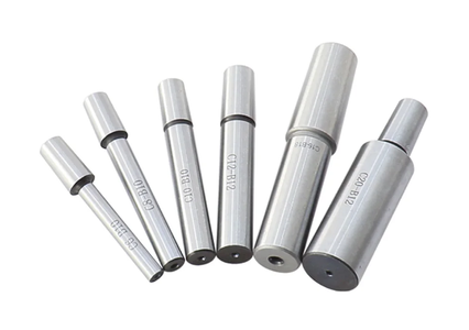

  • Drill Shank of your choice
  • I used a C12 to B16 Shank from AilExpress
  • https://www.aliexpress.us/item/3256801824401498.html?spm=a2g0o.order_detail.order_detail_item.3.1538f19cBTHmwv&gatewayAdapt=glo2usa4itemAdapt

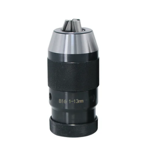

  • Drill Chuck of your choice
  • I used a 13mm B16 Chuck, it's a bit heavy so I should change it out to a 10mm B16 at some stage.
  • https://www.aliexpress.us/item/1005001971160009.html?spm=a2g0o.order_detail.order_detail_item.5.1538f19cBTHmwv&gatewayAdapt=glo2usa

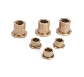

  • Brass Bushing
  • I got a used a 12x18x10-24x3mm
  • https://www.aliexpress.us/item/1005004265918464.html?spm=a2g0o.order_list.order_list_main.387.5ae41802dZDgGz&gatewayAdapt=glo2usa

On a Stanley Brace, the shaft is just over 11mm in diameter. Now unless you are lucky enough to have a lathe it's easier to drill the Brace out to the diameter of the new shaft rather than turn the shaft down on your non-existent lathe.
The shaft I purchased was 12mm in diameter so I carefully drilled the brace and gear out to this size.
You can now test fit the shaft into the Brace, make sure to insert the brass bushing so it takes the load when applying force onto the Brace.
The shaft is most likely too long and will need to be cut to length, mark the shaft and trim to length. Now sand, file, and polish the cut until it's smooth and flush with the Brace.
Now while test fitting the shaft in the brace mark the shaft where the pin goes through the gear. Centre punch the shaft and carefully drill a hole through the shaft so the pin fits in tightly. You can now fully assemble the brace, be careful to make sure the pin aligns with the gear teeth.

You can now tap the new chuck onto the shaft and your Brace is ready to take modern drill bits. As I mentioned at the start a 13mm chuck is really a bit too big and heavy and I should have bought the 10mm one as this will still fit the large hex shanks of modern auger bits.
