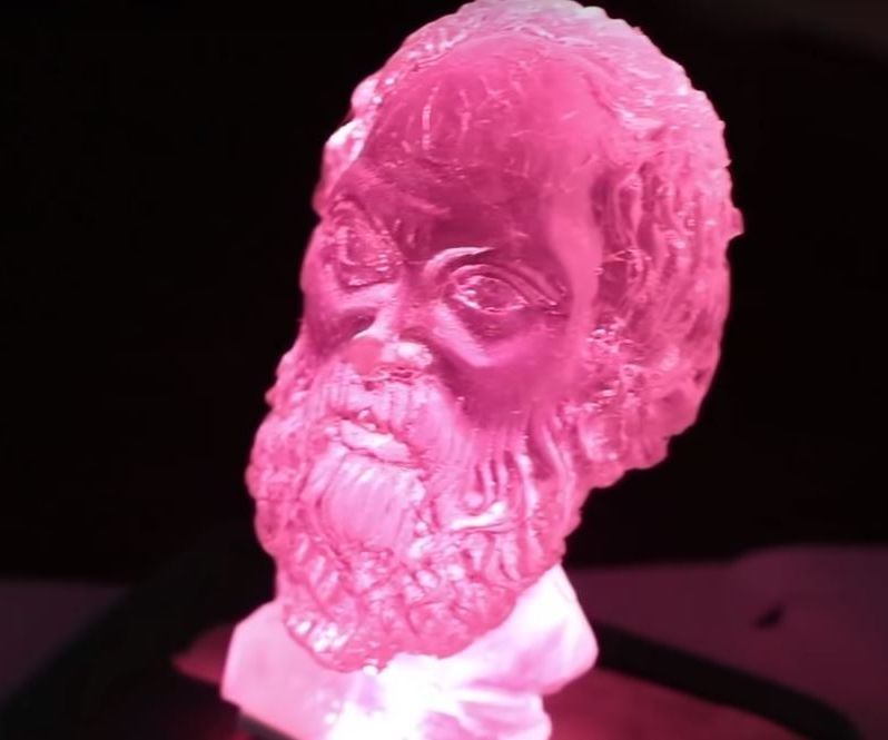

Step 9: Voila - the Cast Is Ready
Once the cast has solidified, slowly pull it out of the mold . Extra care if it is still humid. You might want to keep it to dry for a few hours ( I used the oven - Its faster and gives a crisp brittle bone dry feel )
Step 10: Paint and Add Some Gloss
Now is the fun part . Relax and pour in your imagination. Paint on it .
Once done, add a coating of clear acrylic onto the final piece. I used the acrylic spray. Its much easier that the liquid acrylic paints. Two coatings will give a good finish.
Step 11: And That's It !
You are done once the acrylic sets . ( it usually takes around 15-20 minutes ) .
And this is how the final product looks like !
