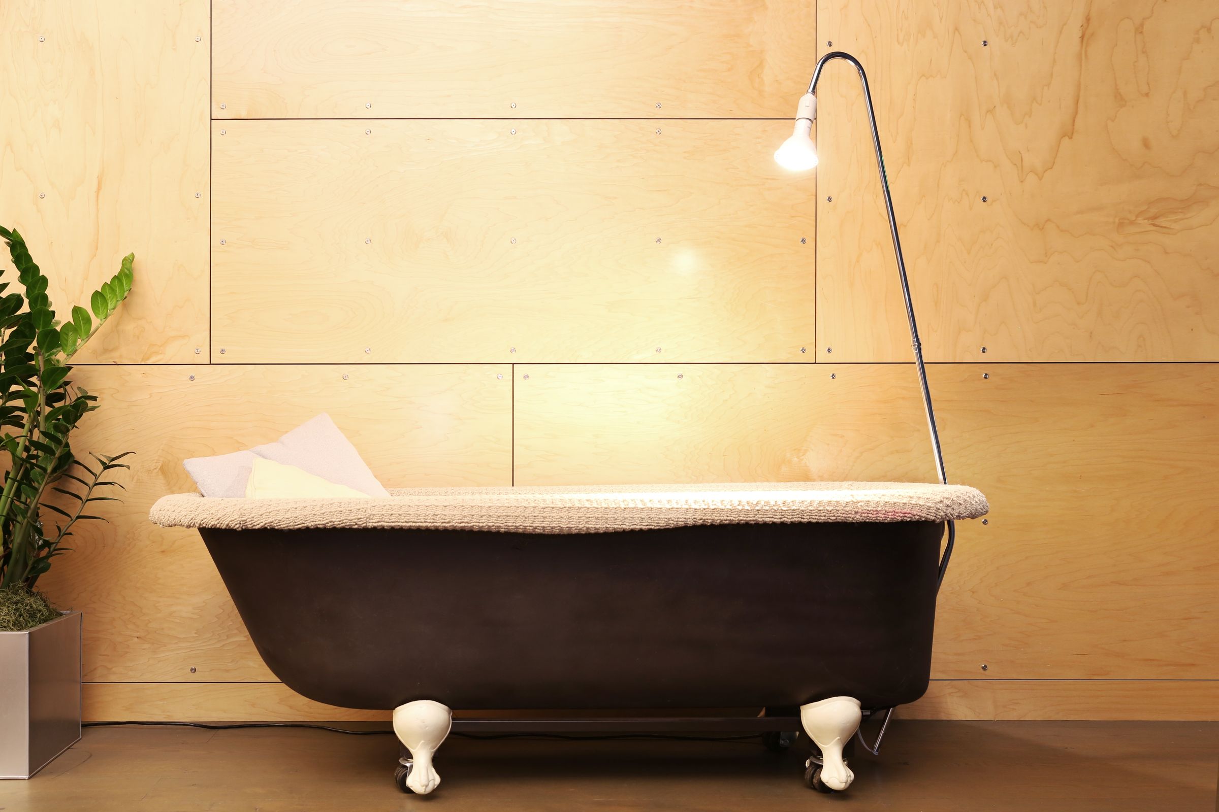

Introduction: Nap Tub
Take your napping to the next level by transforming a claw foot tub into a relaxing day lounger, combining two favorites into one: style, and napping.
The classic aesthetic of the claw foot tub shouldn't just be relegated to the bathroom, but celebrated out in the open for all to admire. This real cast iron bathtub was transformed from a stationary soap suds station, into a rolling relaxation retreat, complete with an operable light that looks like a shower head.
The entire inside has been carpeted, and there's an electrical outlet in the drain to plug in your electronics, keeping them charged while you rest and recharge. Take the comfort of falling asleep in a tub, but forgo getting wet.
Follow along and I'll show you how I took an almost abandoned classic claw foot tub to a unique piece of furniture that everyone is envious of.

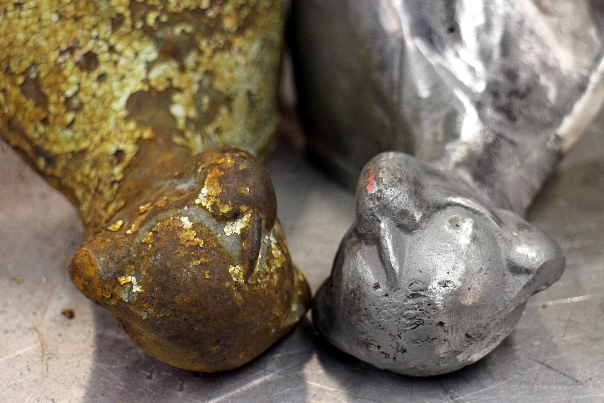

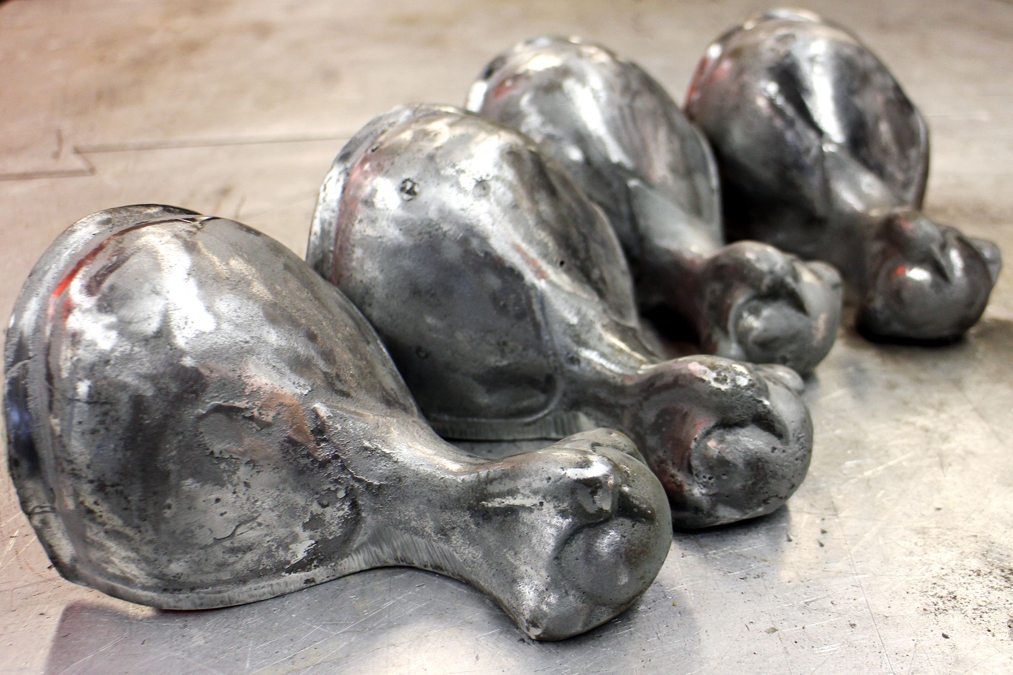

Step 8: Clean Feet
The claw feet that came with this tub had been removed when I bought it. The owner was smart and kept them inside the tub while it was in storage. Unfortunately the feet suffered the same damage as the rest of the tub being exposed to weather and time, and were in terrible shape.
Using a similar method as cleaning off the outside of the tub, I used a combination of wire brush, abrasive pads, and conditioning discs to bring the feet back down to clean metal.
Here's all four feet after they had been cleaned.

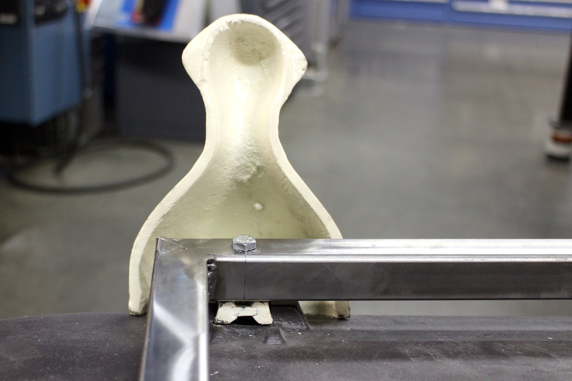

Step 11: Fit Feet + Measure Frame
Being cast iron, I'm guessing this tub weights about 300 lbs. Wanting this tub to be easily movable I decided to put it on heavy weight casters, making it easy to be rolled around by hand. To do this I built a frame to go under the tub, inside the feet, which would hold the casters and obscure them from view.
The feet fir into slots on the underside of the tub. The bolt that I drilled out would have been inserted into the opening and tightened, holding the feet firmly in place. Instead, I plan on using these openings to attach a square tube frame.
With the feet inserted into the slots I took measurements to create a rectangular frame that would fit in behind the feet.

Step 14: Place Frame / Measure / Drill
The claw feet were slid back into the tub and the frame placed over them, squaring the frame up to fit directly over each foot opening.
The location of each opening on the claw feet were transferred to the steel frame using an indelible marker.
There's no room for error here. If a opening is drilled into the frame and it doesn't line up with the opening in the foot the bolt will not be able to hold the frame to the foot and tub. In the image above you can see the first marking I made was slightly off, a new line was marked showing the correct location to drill.
Once marked openings were drilled in the frame. I used a tap to thread the opening in the frame and screwed in a bolt. The bolt was held in place by the threads, and the end of the bolt, threaded through the foot opening) held the foot in place because of a retaining lip on the tub.

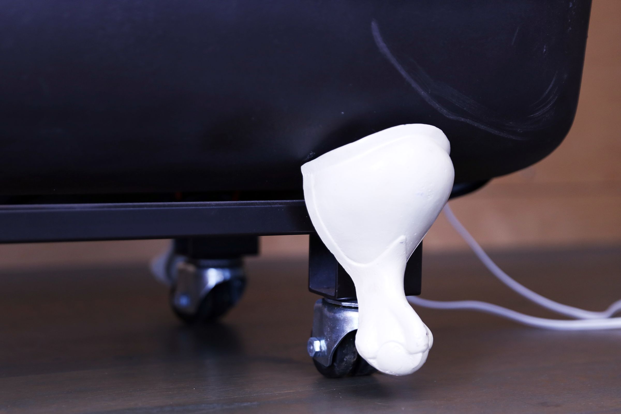

Step 20: Flip That Tub
With the casters on the bottom of the tub was complete. The tub needed to be flipped in order to start work on the inside.
In order to flip the tub safely I needed help, both physically and with a mechanical advantage. I got a few strong friends together to help me flip the tub over, using a block of wood as a ramp to allow us to gently ease the weight of the tub over.
The wood had an additional benefit of not damaging the finish of the tub during flipping. Once it was right side up the inside of the tub could be worked on.
Step 21: Goof Around With Rolling Tub

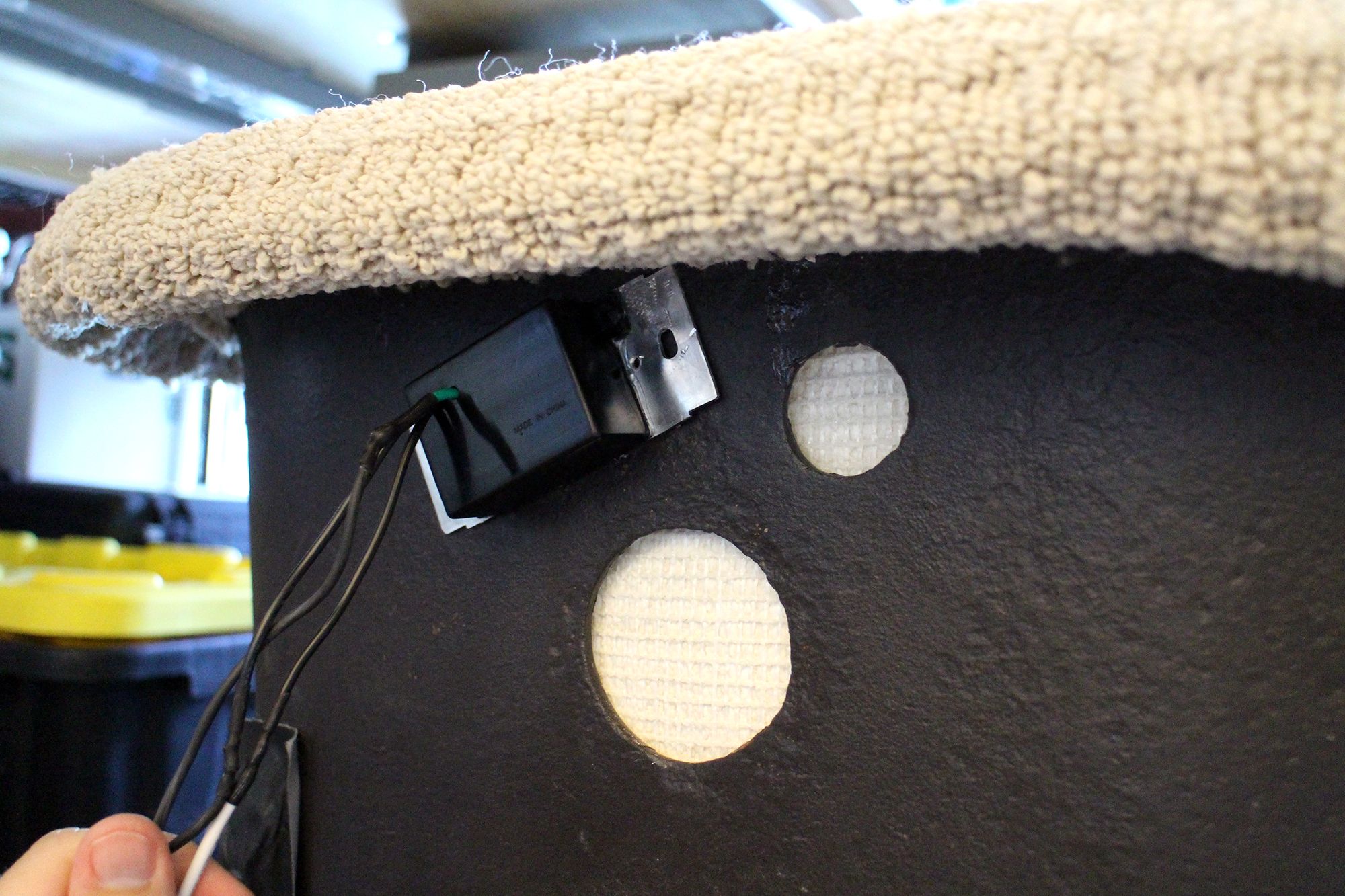

Step 32: Electrical Diagram
Once the glue had dried and the carpet was securely installed in the tub I could focus on the electronics. For this project I wanted to have a power outlet in the drain of the tub, and a light dimmer that would control an overhead light disguised as a shower head.

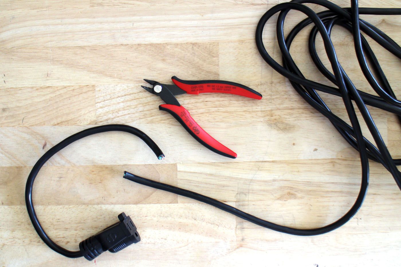

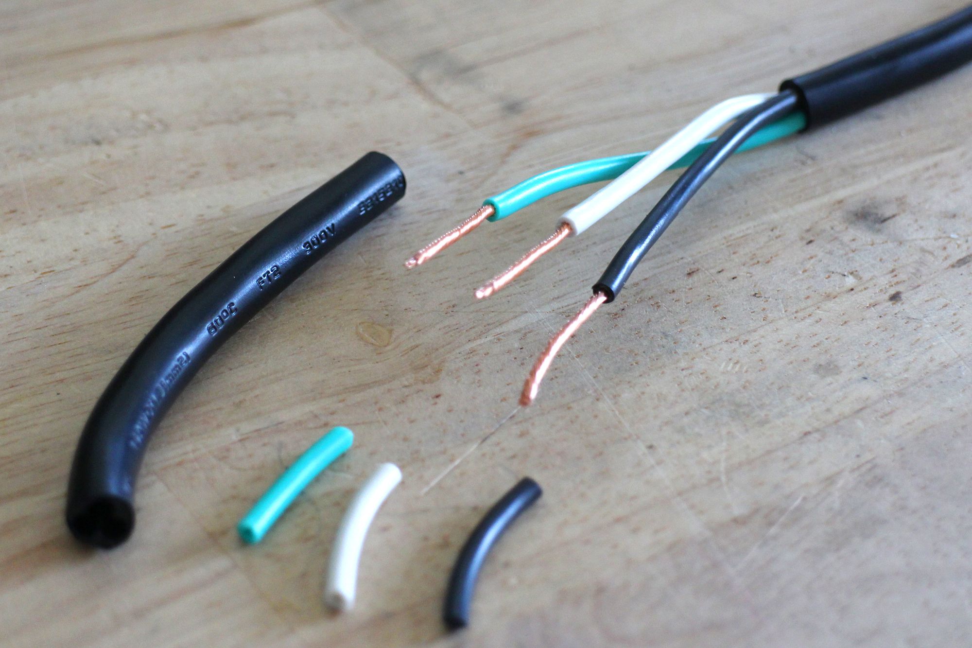

The electrical is fairly simple for this build. An extension cord is clipped and wired to the outlet and the light dimmer, the dimmer then controls the light bulb through the shower riser. All grounds are grouped and wired back to the extension cord.
With the end of the extension cord clipped the end of the wires were stripped.

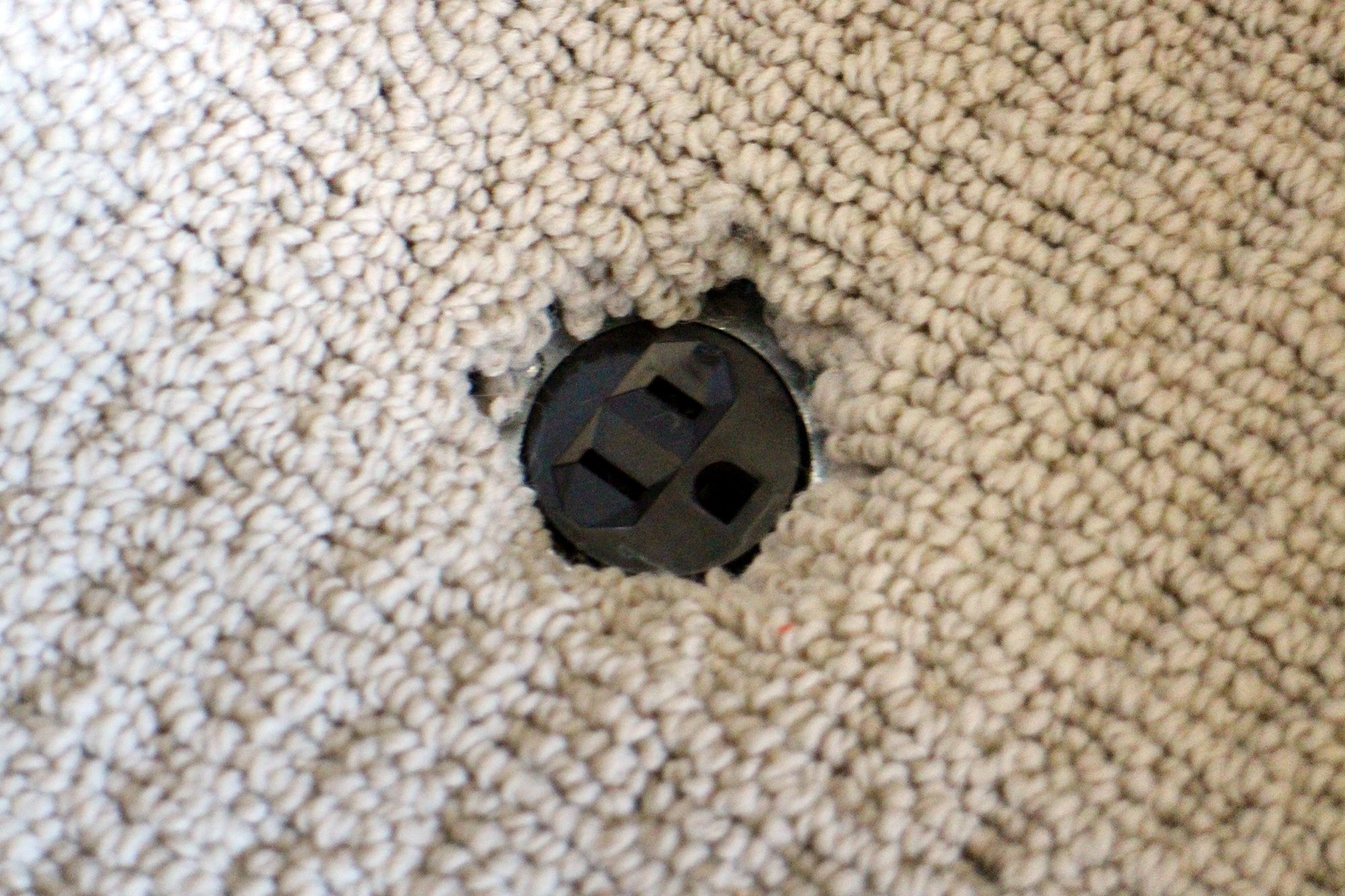

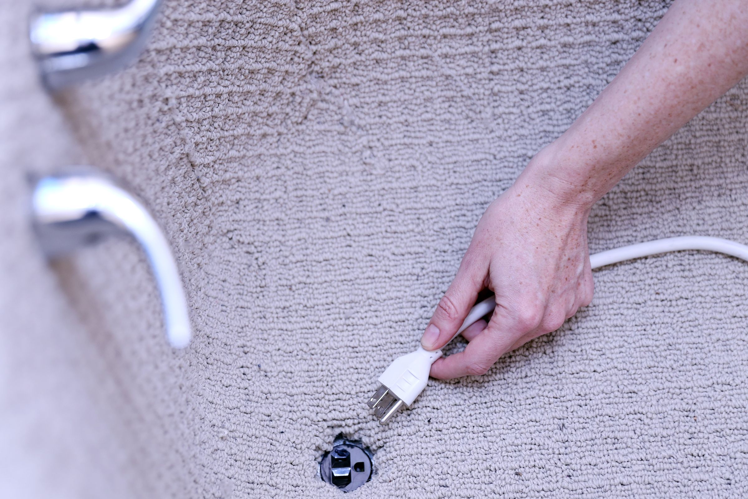

Step 33: Drain Outlet

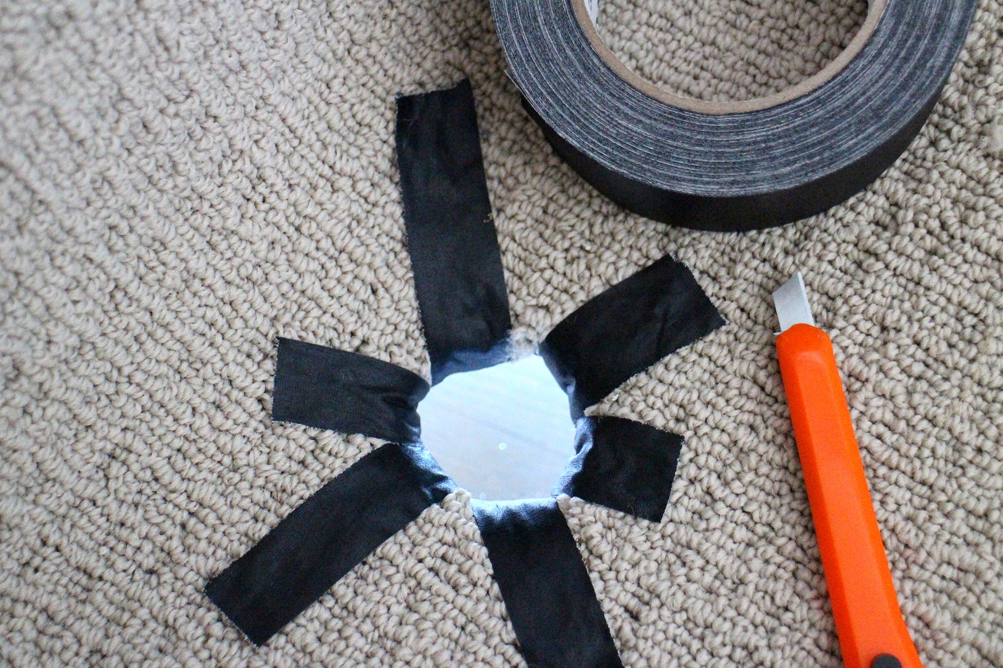

Locating the drain hole in the tub from underneath, I pierced the carpet with a sharp hobby knife.
From the top side of the tub I cut into the opening like I was cutting a pizza, making triangular cuts. The idea is that these cuts can be folded back to the outside of the tub and leave a nice roundover edge.
The round electrical receptacle I used has a nice large flange around the socket.
This flange was glued to the underside of the tub with E6000 and held in place overnight until the adhesive had cured.

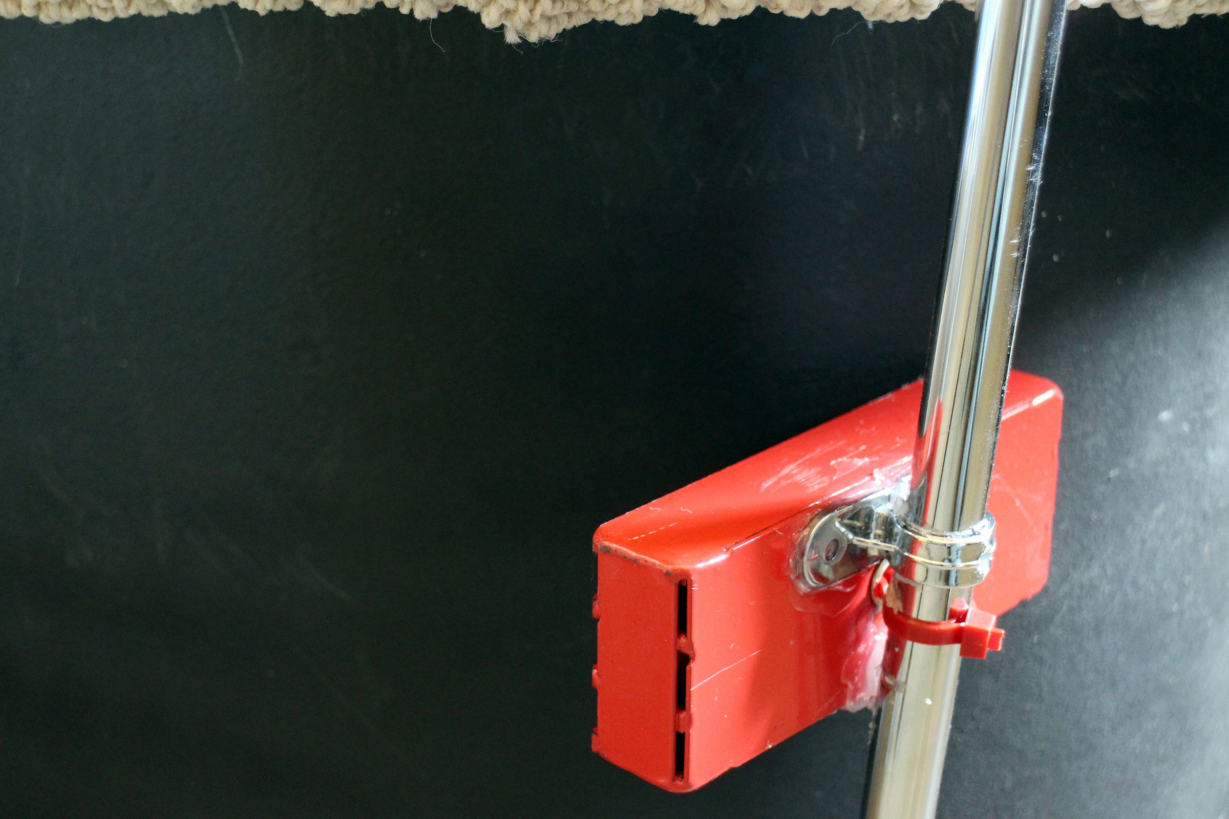

Step 34: Shower Riser Light

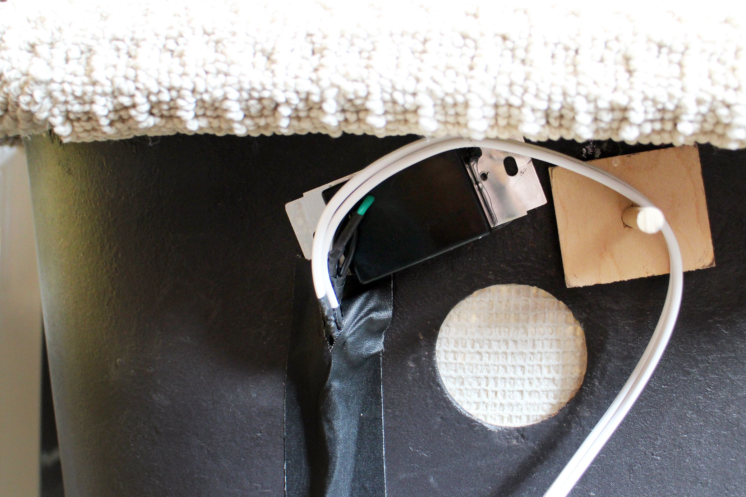

Using a standard light socket power cord, the plug end was cut off and the wire fed through the shower riser. I went with a large white LED bulb, more for aesthetics than lumens.
Instead of mechanically fastening the shower riser to the tub I decided to make it magnetic, allowing the ability to move the riser wherever you wanted on the tub to suit your needs.
I found a heavy duty magnet that would stick perfectly to the cast iron tub. This magnet has a threaded insert which would allow the shower riser to be attached.
Though not a pretty connection, a metal bracket combined with plenty of E6000 made the shower riser stick to the magnet. After curing, the shower riser magnet was easily peeled off the tub and can be repositioned anywhere on the tub body.

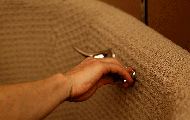

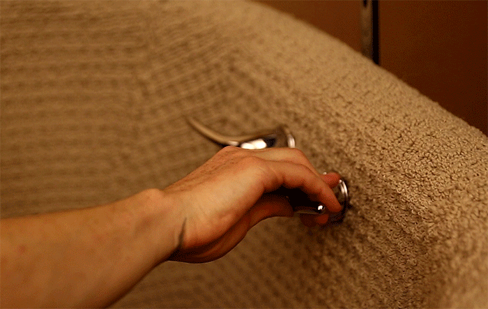

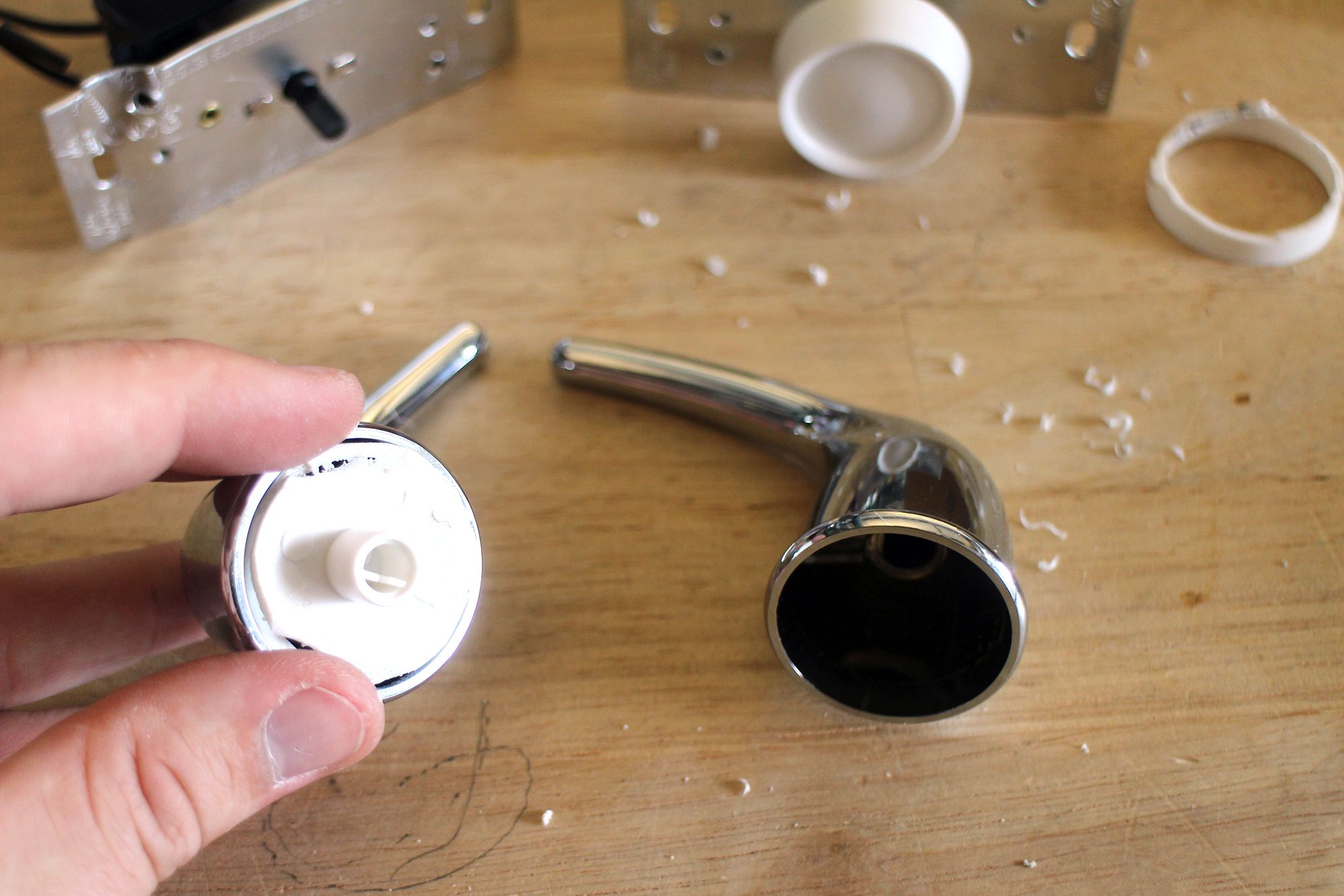

Step 35: Dimmer Switch Tap

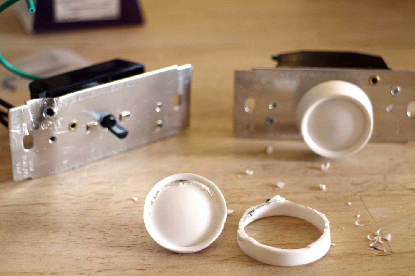

To operate the shower light I installed a dimmer switch in place of the hot water tap handle. The knob of the rotary dimming switch was removed the dimmer unit stripped down of its housing.
The knob of the dimmer switch was trimmed down to match the diameter of the faucet handle, then was fit snugly inside the handle.
More E6000 was used to bond the knob to the inside of the handle.
With the knob drying, the dimmer housing was glued to the outside of the tub where the tub faucets would be located. A small hole was made in the carpet to allow the dimmer switch post to protrude through.
The dimmer switch was clamped in place until the glue cured completely. The electrical wiring was then completed linking the dimmer switch to the power cord, and the shower riser light to the dimmer.

With all the electrical complete the nap tub is ready for the first visitor. I put some extra pillows in the tub to add comfort for those with bony bottoms. When the tub is plugged in, here's the tap dimmer switch in action.
A powered tub means you're able to work on your laptop in the tub and relax while answering emails. If you're laptop is running low on juice, just plug it in!
Being on casters means that this tub can easily be rolled around wherever it's needed. If the location doesn't have any power outlets the extension cord is wrapped up and hidden underneath the tub on top of the frame, tidy and out of reach.
To really help the ambiance of being in a tub I used a bathtub soap caddy, which is actually a small moveable shelf that hooks onto the tub ledge.
This tub is now a staple in the office, and we have people from other departments coming over to take turns for a quick nap. Why sit in a boring lunch room at work when you can lie down and get comfortable in a tub?
With or without the shower riser light, this tub looks great anywhere you put it.
The nap tub was a lot of work, but totally worth it for a unique piece of furniture that delights all who climb inside. I'd love to hear your thoughts on this build, and if you're brave enough to try it yourself please share your results!
