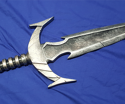

Take your raw resin cast and use a knife to remove any excess resin from the seams. Mine mostly had some excess resin along the blade back and along the pommel. Go over the whole thing with some higher grit sandpaper and clean up any bubbles or bad semas with some body filler, and recarve the details lines if needed on the pommel. Give it a coat of primer and then it's time to give it a battle damaged look, it's meant to be an old used blade from ancient times so lets make it look like one. Mark some lines on the blade, pommel and hilt with a sharpie and using either a cutting disc on a rotary tool or a file, cut some damage into it. Make some of the blades edge chipped, scratch the surface, make it look like it has stopped a blade or 3.
Now I took some help from Punished Props when they did their own painting of a Nordic Dagger Kit, it is a very helpful video and the techniques can be applied on most other projects:
Sand up to around 400/600 grit, another primer coat and spray on a base colour coat. I used black but a dark brown works fine too, just make sure you seal it with a clear coat or lacquer (I used matt spray) to protect the paint. Now to dry brush on some metallic paints, I used some different silvers, bronze, and copper to make it appear a little 2 toned. Take a frayed brush, dip the tip into some paint and wipe most of it off with a paper towel. Lightly brush that over the black to give it a metal-like sheen, swapping paint colours and stroke direction every so often. Eventually you get to a point where the cuts and groves are still black while the rest of the prop looks like an aged metal. Spray that again with some clear coat to protect it and now we can finish off with the handle.
Take some rough sandpaper and scratch up the handle a bit, we need it to be rough so the glue and leather/fur can adhere to the plastic. I super glued a small amount of fake fur to the end of the handle and just below the hilt, wrapping it about 3/4 around it. This is so we can glue the leather strip to the plastic itself to ensure it stays attached. Glue a tiny bit of leather to one end, and carefully wrap it around the entire handle, making it somewhat tight so it doesn't come loose (you can glue parts of the handle to the leather so the whole thing stays down). Finish up at the other end, cut the end of the strip used on an angle so it 'blends' into the end of the handle and you are done!
