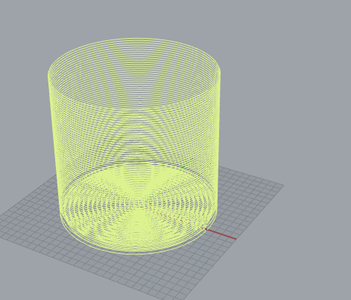

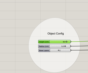

I started with the first grasshopper example and increased the height. I also reset the range for the radius slider so it could have a little wider vase

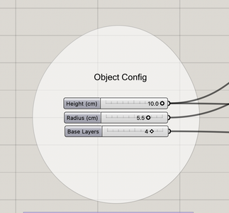

I set the dimensions to 10cm height and 5.5 radius to start. I increased my base layers to 4 after hearing that other students were finding that a thinner base was hard to get off the bed.

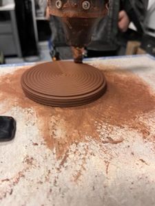

To print the work, we first connected to the ethernet. It took a while to figure out how to manually set up the ethernet address. But once connected I typed in the IP address to bring up the potterbot software. I also placed a ware board on the bed and clamped it in place so I was not printing directly on the potter bot bed. I then zeroed the z axis and adjusted manually so that it was barely touching the ruler. I then needed to press Home all axis (I believe that was the button). Yanchen graciously helped me with this part. I then uploaded my gcode and pressed start.
I asked for a 4 layer base, but as we were printing we found that the potter bot software doubles it. So it was a really hefty base. But I needed it because i had a lot of trouble getting the base to stick, so the extra layers gave me time to baby set and adjust the extrusion rate to get it to stick.

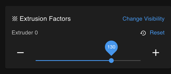

At first the clay wouldn't stick. We sprayed the bed with water, but it kept curling up. Some possible reasons could be the dryness of the clay that I loaded the tube with. But what really helped fix the problem, was when I increased the extrusion factor. I think it was at about 100 or 110 when i was starting out, we went to 120 and then to 130. baby stepping and being careful when zeroing the z axis are very important, to make sure we have right amount of compression that the clay sticks.
