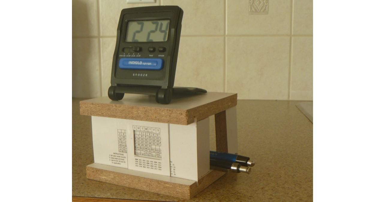

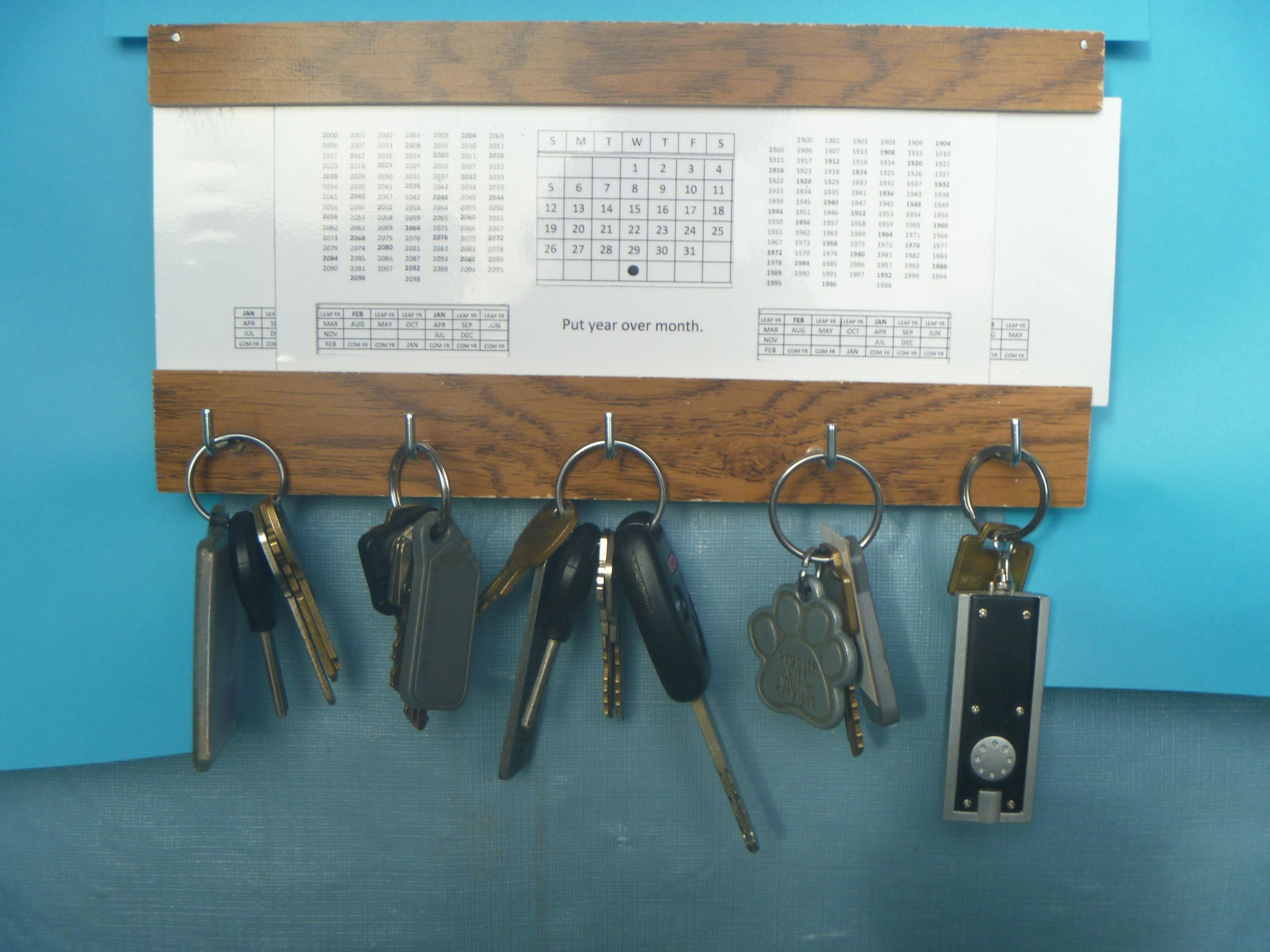

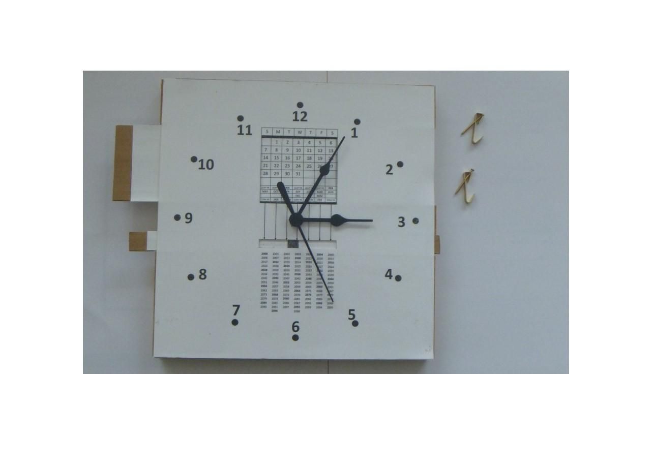

This design can be adapted to make a pocket calendar. A calendar based on this design can be part of a planner, a photo holder, a key holder or a clock. I have also designed perpetual wall calendars that have a sheet for each month. My designs are documented in my book “Practical Perpetual Calendars – Innovative, Convenient and Green” by James R. Saltvold. You can view a pdf copy of it free of charge at https://archive.org/search.php?query=saltvold . My website, www.jamessaltvold.com , has a few designs that I have developed since my book was published in 2017.
