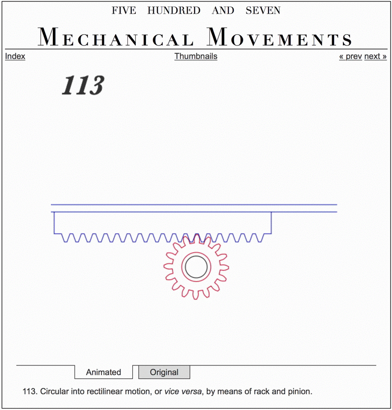

507 Mechanical Movements is an encyclopedia of common mechanisms from the 1860's that serves as a good reference for this kind of thing. This mechanism is bases on Movement 113, "Rack and Pinion".This is going to be a long project, so if you've got a specific mechanism you'd like me to make, feel free to make a request in the comments!

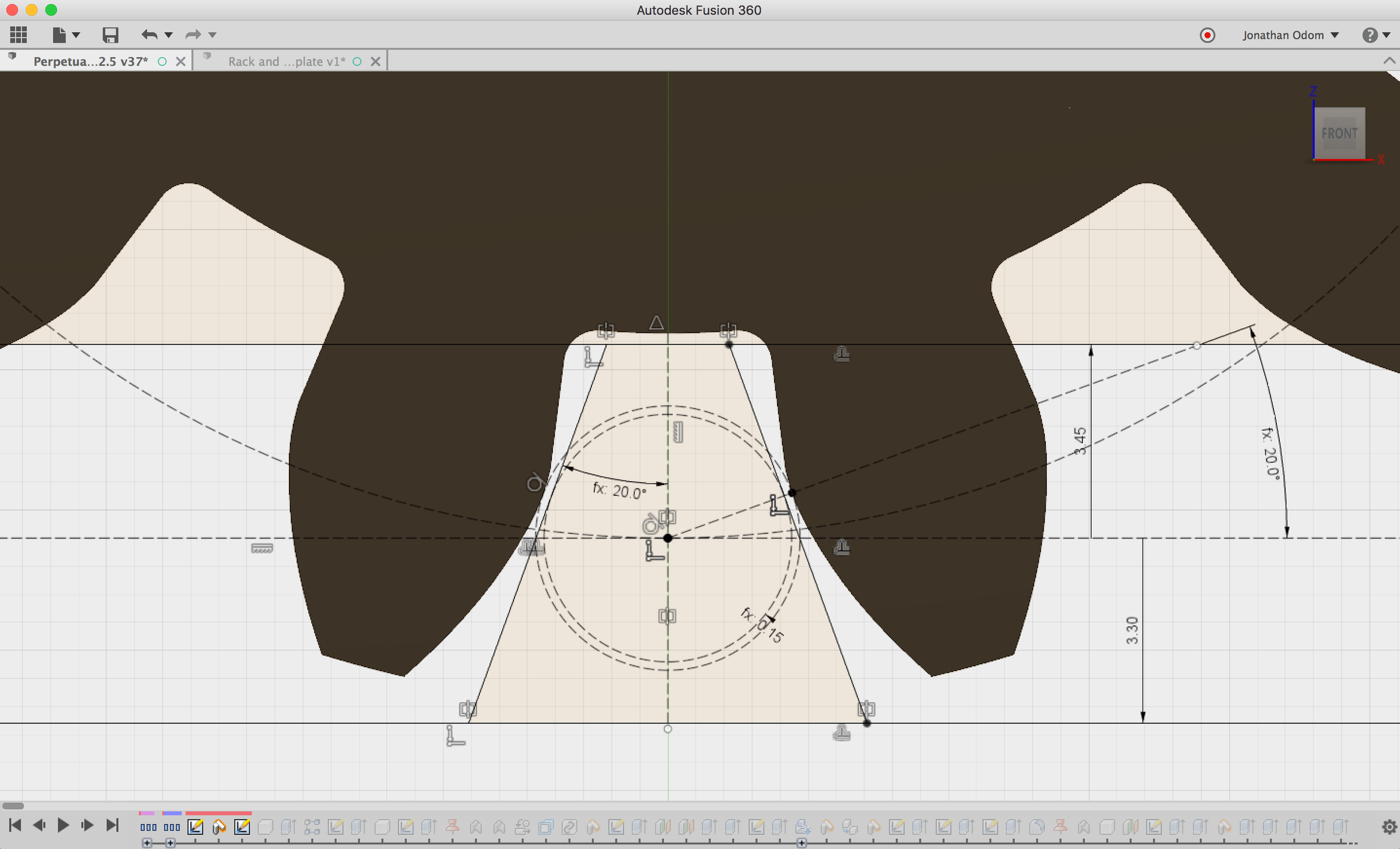

The hardest part of the design to figure out was the rack and pinion gear assembly. The math for gear design can get pretty complicated (in fact, there are engineers who basically only design gear assemblies for this very reason), but based on a great Youtube tutorial by Rob Duarte, I made my own template that works with the latest version of the Spur Gear add-in for Fusion.
The video above walks you through the process of making the rack and pinion assembly, but if you want a more thorough tutorial, please join me for the Design Now Hour Of Making in Motion webinar on April 5. If you miss the webinar, it'll be recorded and I'll post the video here.

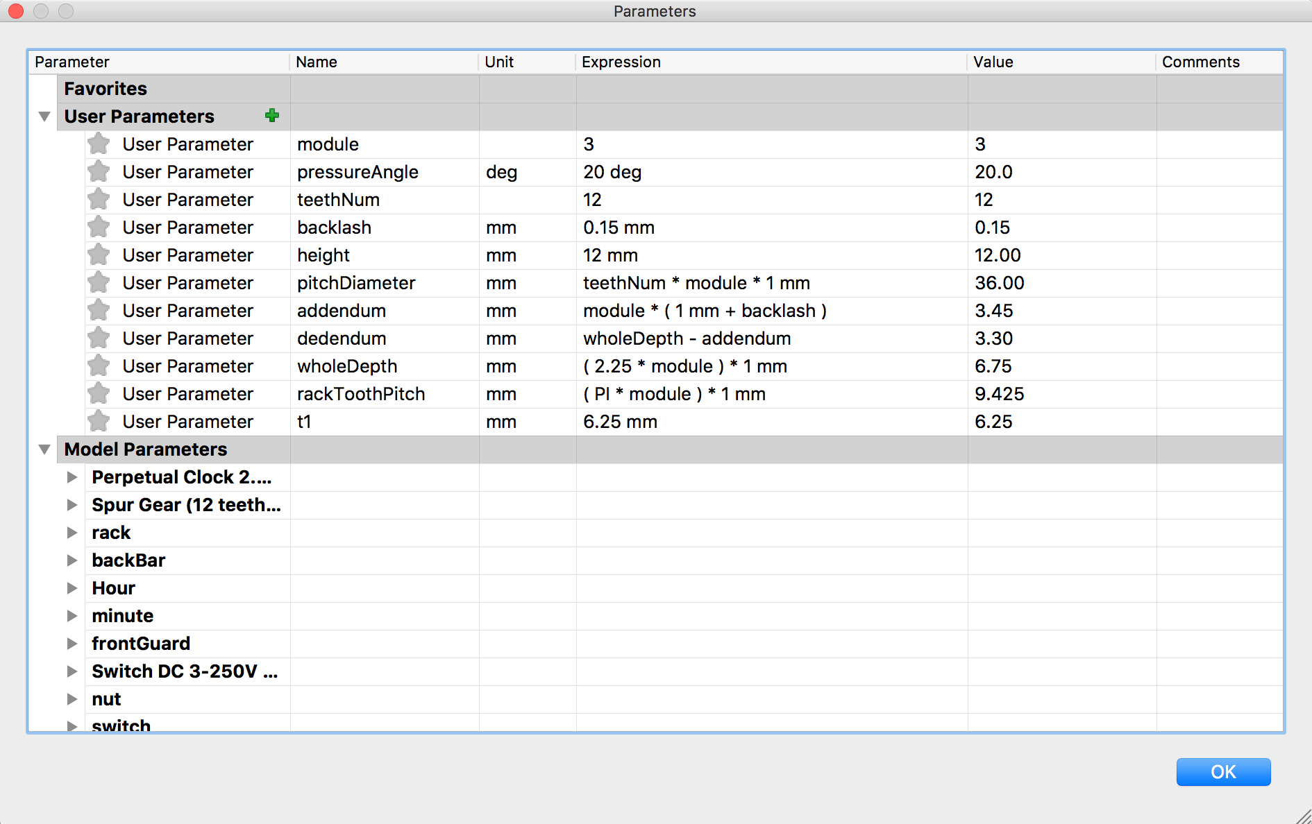

The template (link below) has all of the parameters shown above already entered. I won't get into the math here, but if you follow the instructions, it should work for you.
Use the Spur Gear add-in by going to ADD-INS > Scripts and Add-Ins... > Spur Gear > Run. When you get the window shown above, enter the parameters. Number of Teeth won't let you use a parameter for the value, so just make sure it matches the teethNum value if you change it. You also have to multiply the named parameters by 1 as shown above.
Keep in mind that once the gear is made, you can edit it just like any other object in Fusion.
As shown in the video demo, this is an example of how you'd construct a tooth profile using the parameters.
Here are the links to the template you can use to make your own rack and pinion in Fusion:
Template with parameters:http://a360.co/2oeT5El
