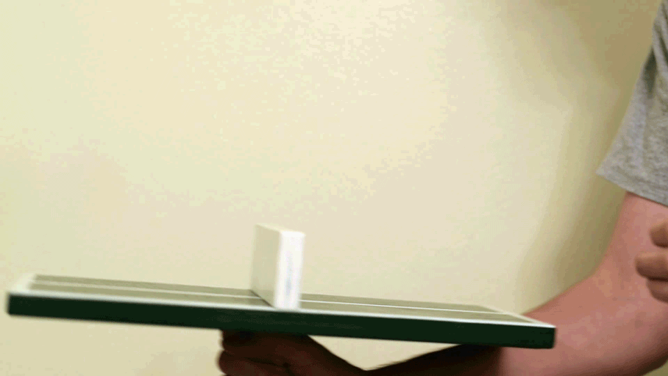

Then look no further than Personal Ping-Pong! Whether you are playing outside or in this summer, on vacation or at home, It's cheap, simple to make, and doesn't require anyone else!
Step 1: Parts
You will need the following:
- 8 x 16 x 3/4 inch Plywood
- 8 x 2 x 3/4 inch Plywood
- 6 x 1 inch diameter wooden dowel
- Three Screws
- Paint
- Ping-Pong ball
Step 2: Drill Hole for Handle
Find the center of the ping-pong table by marking from corner to corner. Drill and countersink a clearance hole for the screw to hold the handle in place.
Step 3: Attach Handle
Drill a pilot hole as close to the center of the dowel as possible. Using a three inch screw, attach the handle to the ping-pong table.
Step 4: Attach 'Net'
Drill and countersink two clearance holes in the center of the ping-pong table. Clamp the net in place and drill two pilot holes. Attach using screws.
Step 5: Finish Sanding
Using some wood filler, fill any imperfections in the edge of the plywood and sand smooth.
Step 6: Primer
Cover the pieces in primer to get an even coat of paint.
Step 7: Paint
Cover the handle in black, net in white, and the ping-pong table in green paint.
Step 8: Tape Off Lines
Using painters tape, cover everything other than 1/2 inch strips along the edges and down the middle.
Step 9: Paint
Cover the top in paint and once dry, remove tape.
Step 10: Assemble
Using screws, assemble the table. Go and be great!
