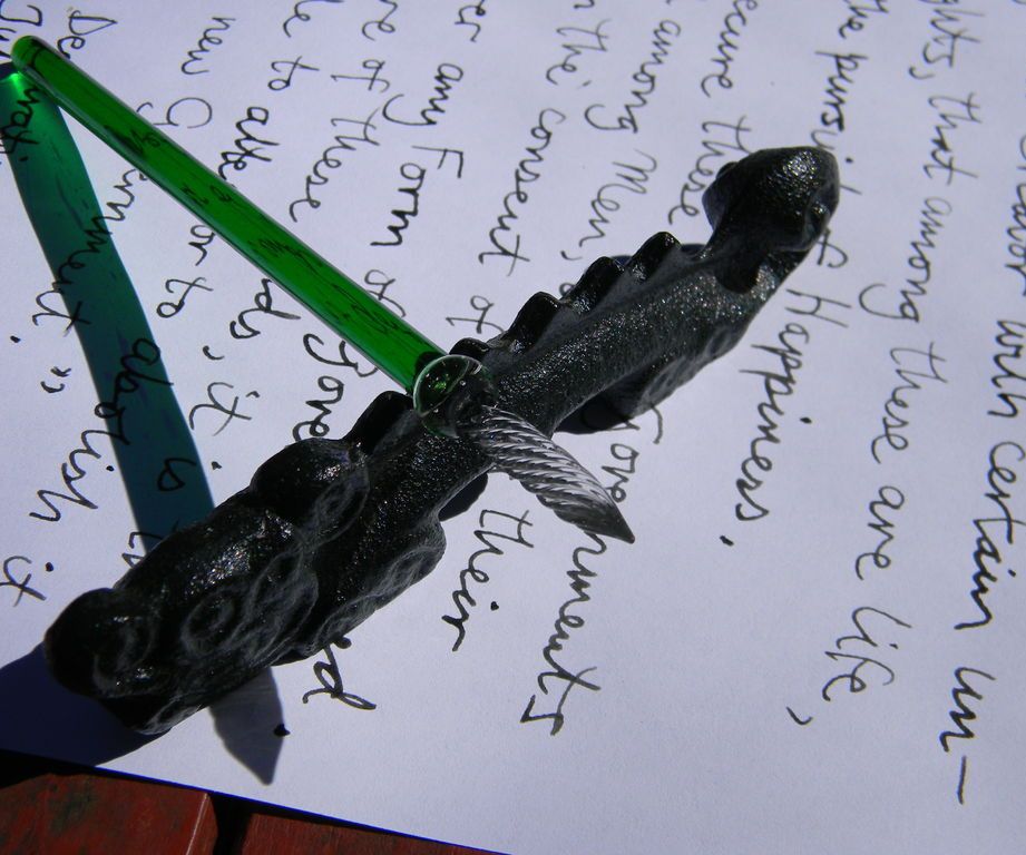

Step 6: Make Some Writing Samples
Materials Needed for Step 6
  • Paper
  • Dip Pens
  • Your finished ink!
This ink is usually dark at the outset and ready to use. It may darken further as it ages in the bottle after a few weeks. Like any iron gall ink, it will go down somewhat pale initially, and then darken as it dries and oxidizes. How much it darkens and how fast it does this will depend on the type of paper you write on and the type of writing instrument you use (metal nibs will cause a chemical reaction with the acid in the ink, making it blacker). Experiment with different combinations. Test its waterproofness. Play!

    what kind of pen do you have in the photo green handle and spiral tip
    0
    InkMakerNC
    InkMakerNC
    Reply 1 year ago
    Sorry, I didn't see this question sooner. It is a J. Herbin glass pen.
