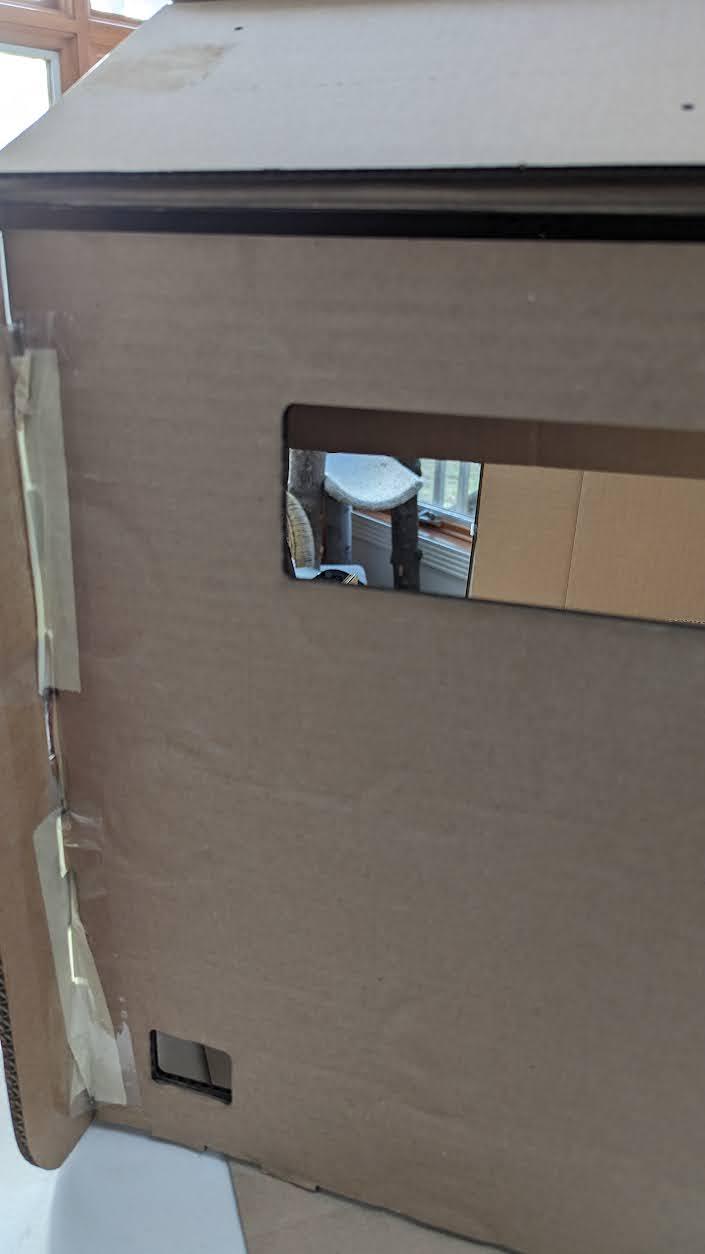

Note above that we have an Arcade control Panel and in the previous step a side wall. For this project, there were several factors to take into account. The laptop screen had to be held in place, so there are two rows of slots needed for the front frame, and a supporting rail behind the screen. Those were not in the original plans. It took two iterations to get the spacing correct.
For the control panels, we needed the buttons to be above where the keyboard would be (down at an angle), but the buttons couldn't hit the keyboard. We were able to cut a couple different designs, mount the buttons in the panel and see how they would interact with the keyboard.
Step 3: Finding Problems
In this picture, you can see that the panel doesn't go all the way to the top. Somewhere in the design where I was changing measurements, I didn't add something in. The prototype showed me where a mistake was. Instead of costing me a whole piece of plywood, it was just some free cardboard.

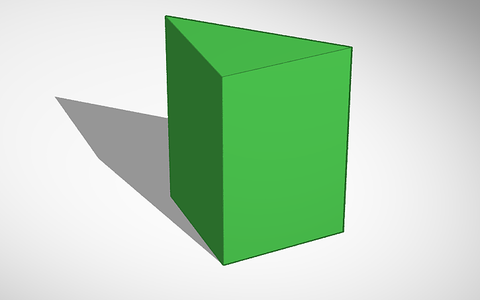

Taping and gluing the cardboard together works for many prototypes. But a student needed something that was a bit more sturdy to be able to test the fit of a monitor. So we created a quick wedge in Tinkercad https://www.tinkercad.com/things/1GbyG2sf8jl-prototype-brackets and printed batches of 6 at a time to use as brackets between pieces of cardboard.
We had the Ender 3 v2 at Makersmiths going full time for half a day to get a bunch of them printed. Hot glue ot wood glue work depending on your adjustment vs set time. Hot glue is going to be pretty unforgiving, but you don't have to clamp it and sit there for a while.
