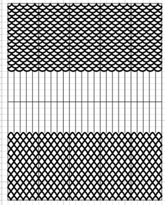

I decided to make my bookmarks 5x16cm, with five strips of fringing. First I used Cricut Design Space to draw and group the four inner strip cuts - I decided to make two rows of bookmarks, meaning I could make two sets of fringing with one set of cuts. I used the position tool under the 'More' dropdown menu to position my cut lines.
After I'd positioned all the inner short cut lines, I drew three horizontals (top of first row of bookmarks, middle one to separate the top row from the bottom row, and one at the very bottom), and six verticals, to cut my five columns of bookmarks.
As a bonus, I added some debossing patterns for the non-fringed parts of the bookmarks: mermaid scales for the top row, and dragon scales for the bottom. I've not included the instructions for how I made these patterns so as to keep things short, but if you want to know how I designed these in Inkscape, drop me a comment and I'll make a mini tutorial and link it. :) I did two layers of the same debossing designs, so that when I ran it through the machine it would go over the same lines twice for a deeper impression.
I grouped everything and clicked 'attach'.

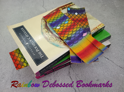

Step 5: Outlining and Painting
I used a pen filled with black leather dye to outline the debossed scales on each bookmark. In future I'll also experiment with a) automating this using the Cricut machine, and b) playing around with products that will get into the debossed bits, and wipe clean on the raised bits.
I then mixed up some leather paint with a touch of mica powder, to make it pearlescent, and painted some random scales. I left it to dry for a few hours.
Step 6: Top Coat and Done!
Finally I gave each bookmark a coat of carnauba cream. You can use whatever top coat you like, but bear in mind that anything oily might damage your books.
