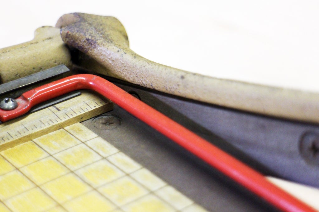

The paper cutter I got was in okay shape, but had warped from age and had seen many years of use and abuse. Some highlights of areas to fix were:

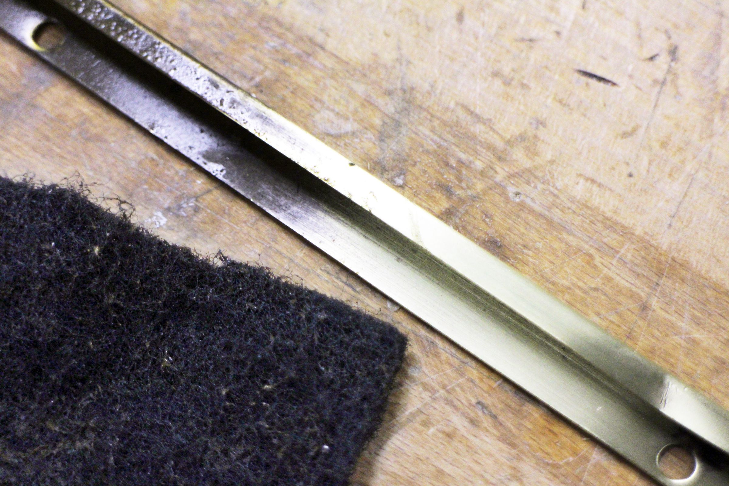

Tarnished cutting blade and plate. Debris and age had turned the metal a dark brownish grey and the blade action was sticking in some areas. Where the cutting arm attaches to the base there's a spring which was in good shape but not tensioning properly. This entire junction where the arm meets the base, blade meets plate, ruler, cutting guide, and spring assembly was a constellation of problems that needed the most care and attention.

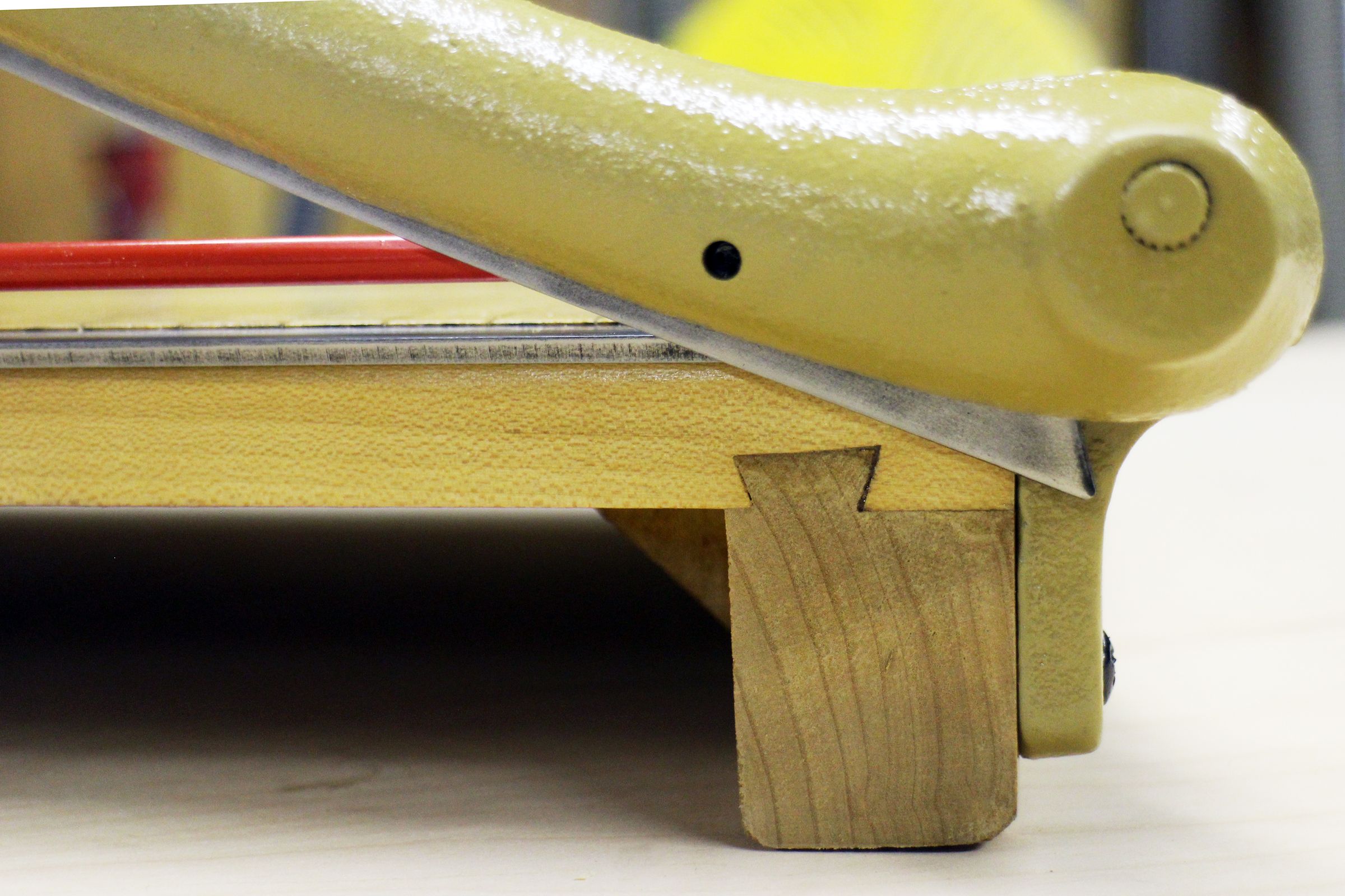

The struts that gold the base had an attractive dovetail dado and key that had warped over time. After some investigation it turned out the strut was bent and not the maple base, which would have been much more work to correct. Both struts were warped, and a different wood than the maple base. The strut wood was a softer variety (I guessed Spruce) which would be the area that would warp more.
Worn ruler and bent metal alignment guide. The ruler was legible, but worn and smeared in some areas (see the numbers 7 and 8 in the picture above). There is a brass alignment guide above the ruler, I'm not sure exactly what it's for but there's a dent near the screw head and the entire guide had a patina.
Paint worn away, in some places missing completely. The handle, seeing the most action, was by far the worst. Since I was investing in paint I decided to apply new paint in a few additional places from the original manufacturer to give this paper cutter a fresh new look.

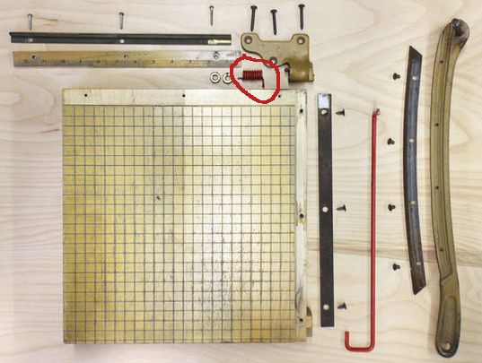

Removing all the pieces is the only way to go when restoring old tools, it allows you access to hidden parts and allows you to really inspect the work so there's no surprises later on.
The maple base is what holds all the components for this paper cutter. The cutting arm is held on by a cast iron retainer with 3 screws, the arm and tension spring can then be removed from the retainer. Once the arm is off the ruler and alignment guide were removed, allowing the red safety bar to come loose. Lastly, the cutting blade and plate could be unscrewed.

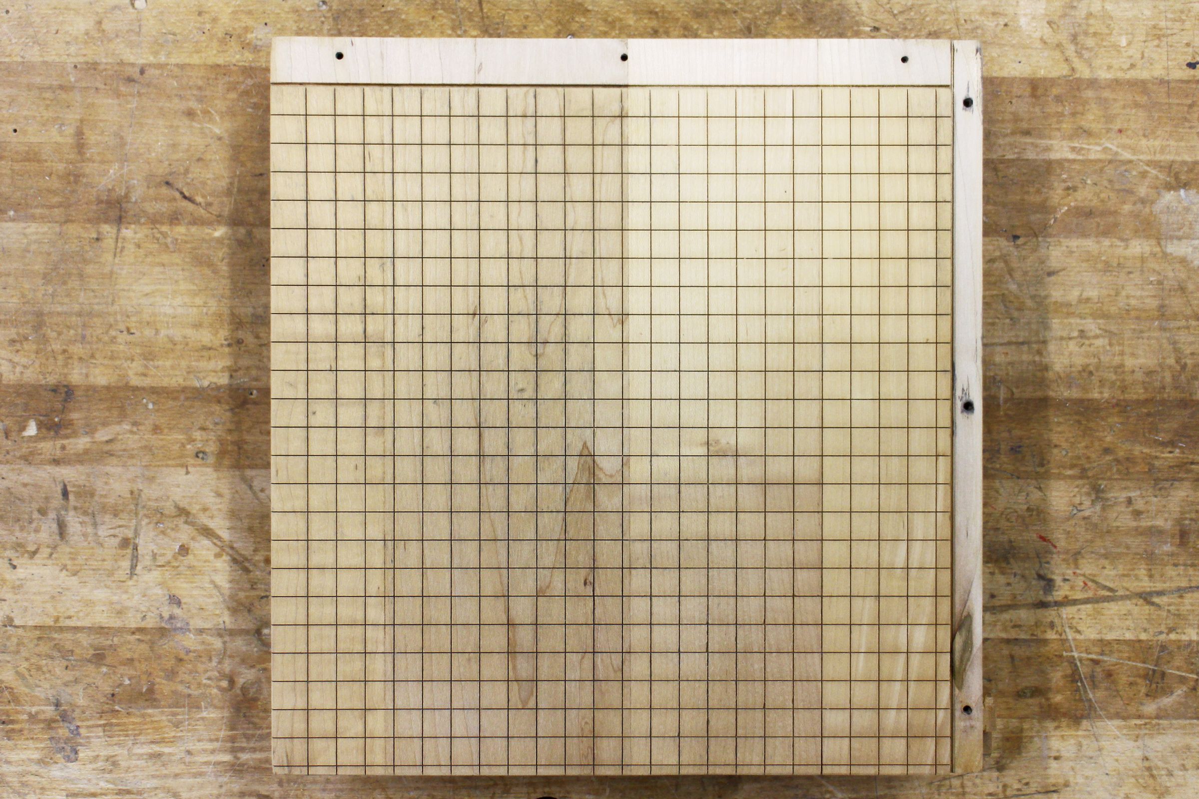

Step 5: Sanding the Base
As discussed in the sanding lesson of my Woodworking Class (did I mention free?!), go from coarse to fine when sanding. I started with an 80 grit pad on a random orbital sander and blasted off whatever coating was on the maple base and got down to fresh wood. I continued with a coarse grit over the entire surface of the cutter until it was all down to just wood.
The only part I decided not to sand was the very front face that had the Ingento logo. I liked the way it looked, and since it wasn't damaged chose to leave it alone as a reminder of what the cutter used to look like.
After rough sanding I stepped up the grits to 180. I decided not to go further since there's really no need.

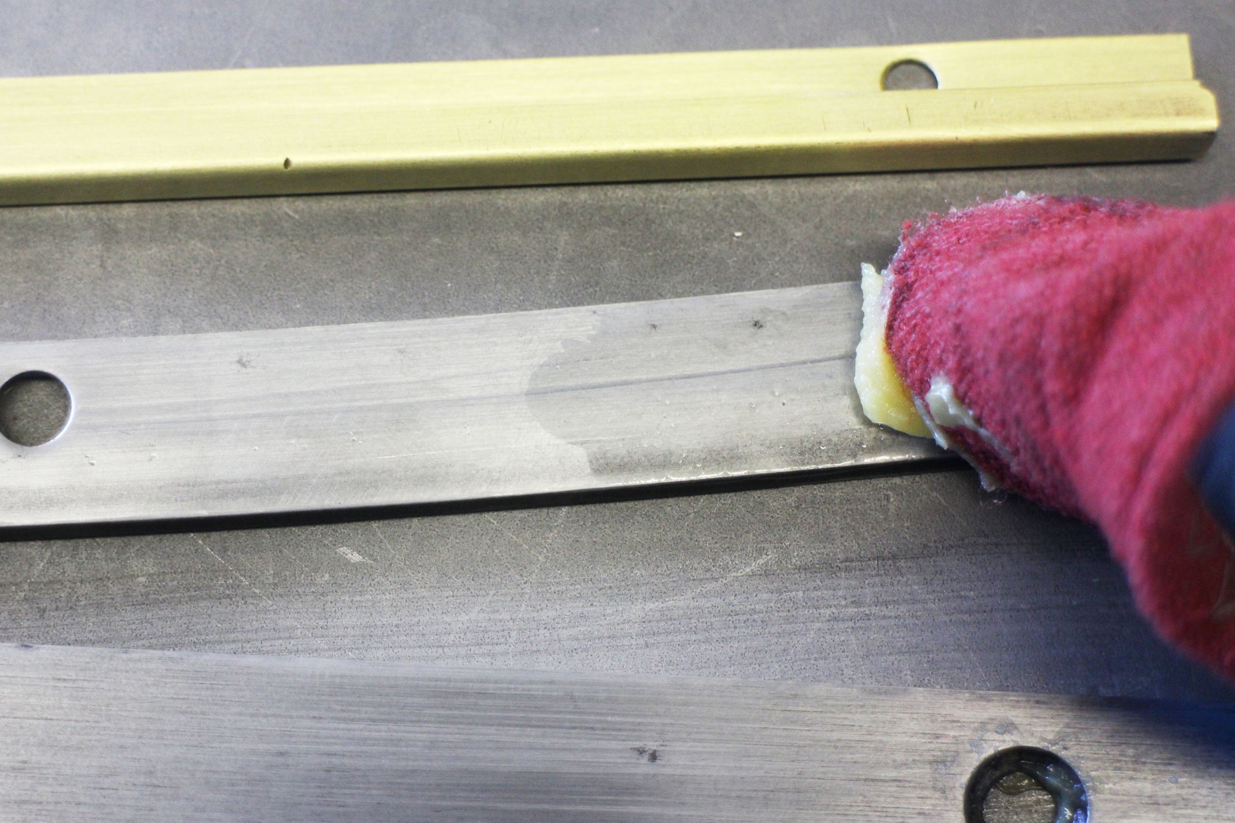

To seal and protect the metal parts of the paper cutter I used a metal wax. Though this isn't necessary I think adding a protective coat will help provide a few extra years against abuse that these parts will endure.
You can apply the wax directly to the bare metal with a shop rag and just rub it in, but to ensure smooth and even coverage I decided to heat my metal pieces up slightly with a heat gun.
Each piece was gently heated with the heat gun on the lowest setting. The aim here is to relax the metal and allow the wax to easily be applied to the metal and melt into every groove and pore evenly.
With the metal warmed a gob of paste wax was applied to each metal part. Since the metal was warm the wax melted and was easily spread evenly over each metal surface. The metal parts were then allowed to cool and then buffed with the same shop rag used to apply the wax.

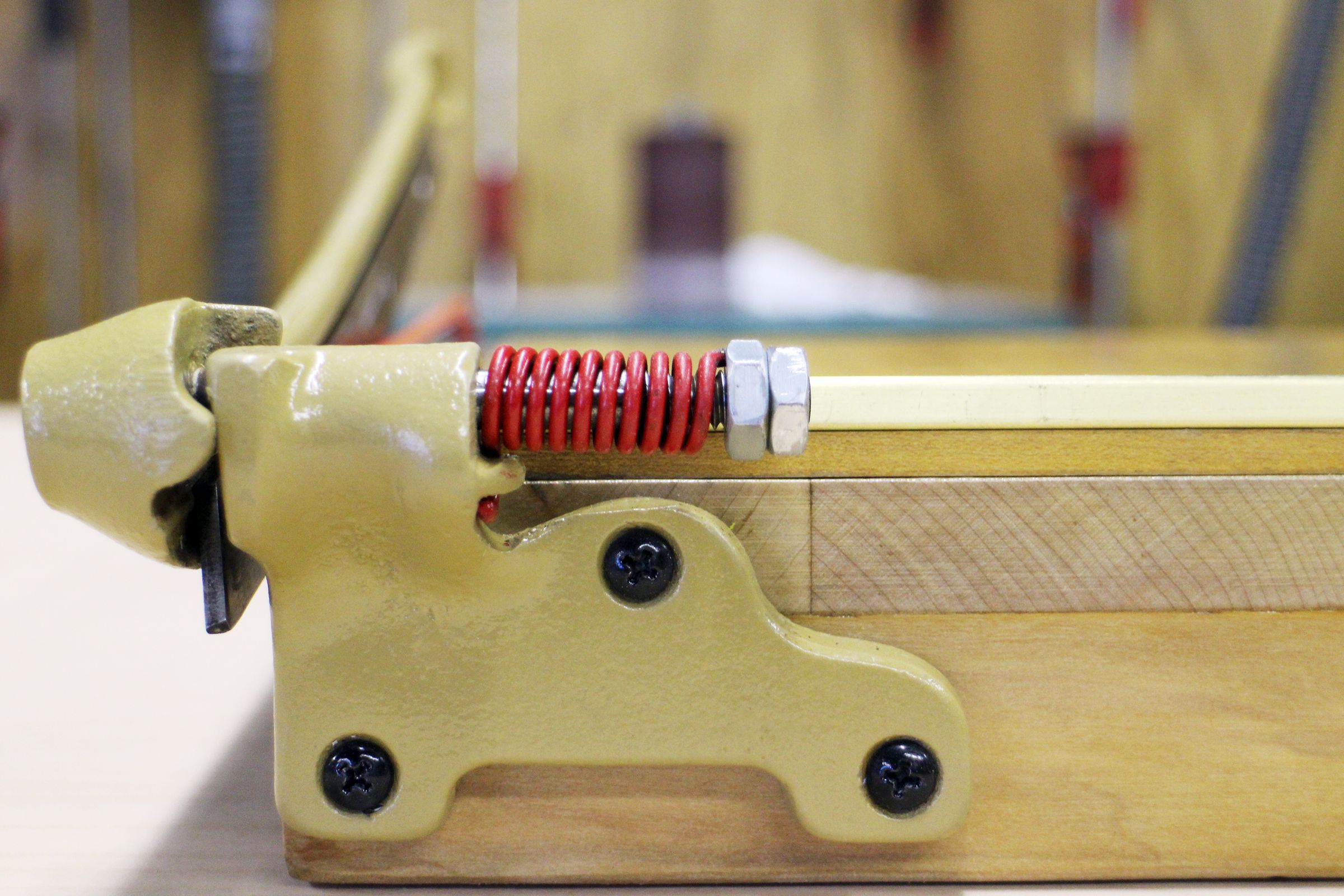

Here's the cutter after all the parts have been repaired except for the ruler, I decided to do the laser etching of the ruler after this picture was taken. I had reassembled the cutter and realized that the original ruler lacked the same style as the newly refinished cutter, so decided to add those laser etches after.
The cutter was reassembled the same way it was taken apart, using a hand screwdriver to secure each screw and ensure that they wouldn't be stripped.

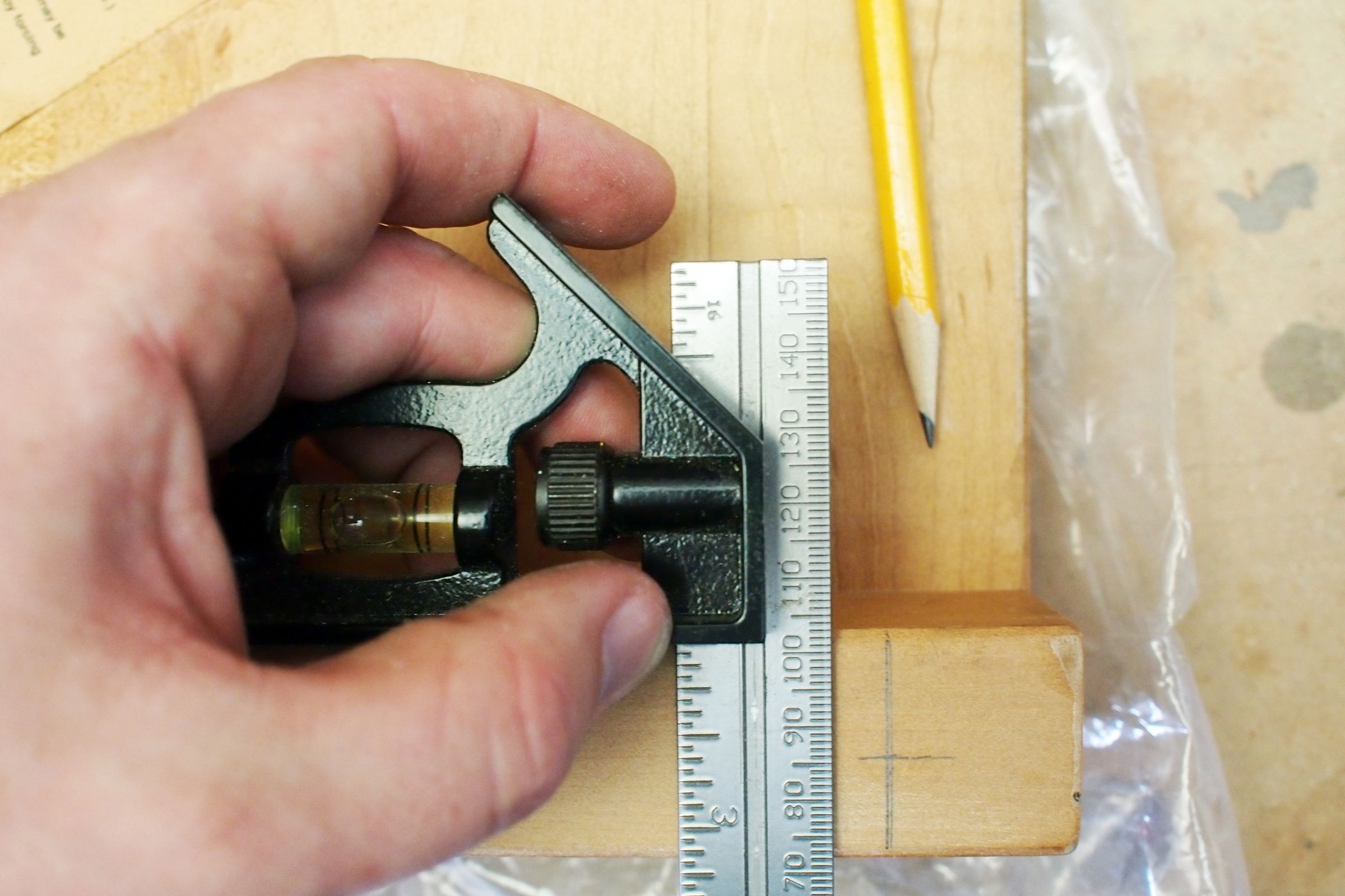

Turning the paper cutter upside down so the bottom was accessible, I measured the center line of both struts and marked them with a pencil, then measured in from each end about 1" to and made another pencil mark of where the rubber foot would be placed.
Since these feet are screw on, I drilled a pilot hole at each pencil marked intersection to a depth of about 1/2". There's a few tricks to drilling holes straight and square, and you can learn all about it in the Drilling Lesson as part of my Woodworking Class (it's free!).
Lastly, each rubbed foot was secured with a screw tightened by hand as not to over-tighten and stripping the screws.

Where can you get hinge spring?
0
bowlturner58
bowlturner58
Reply 2 years ago
Hi
Did you ever find a new spring for your cutter ?
0
nathanielh20
nathanielh20
Reply 2 years ago
Sadly no. About the only option I could find would be custom-made, but that would be costly and I have no idea what the specs for such a spring would need to be...

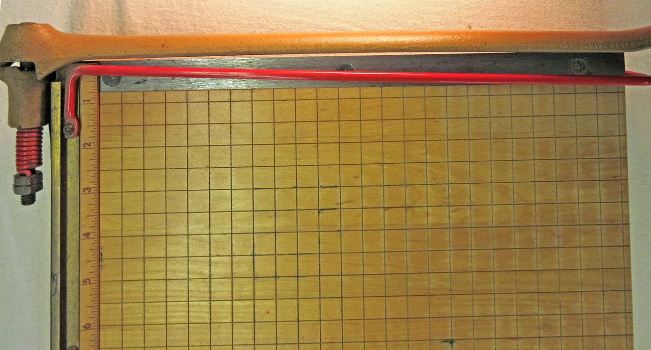

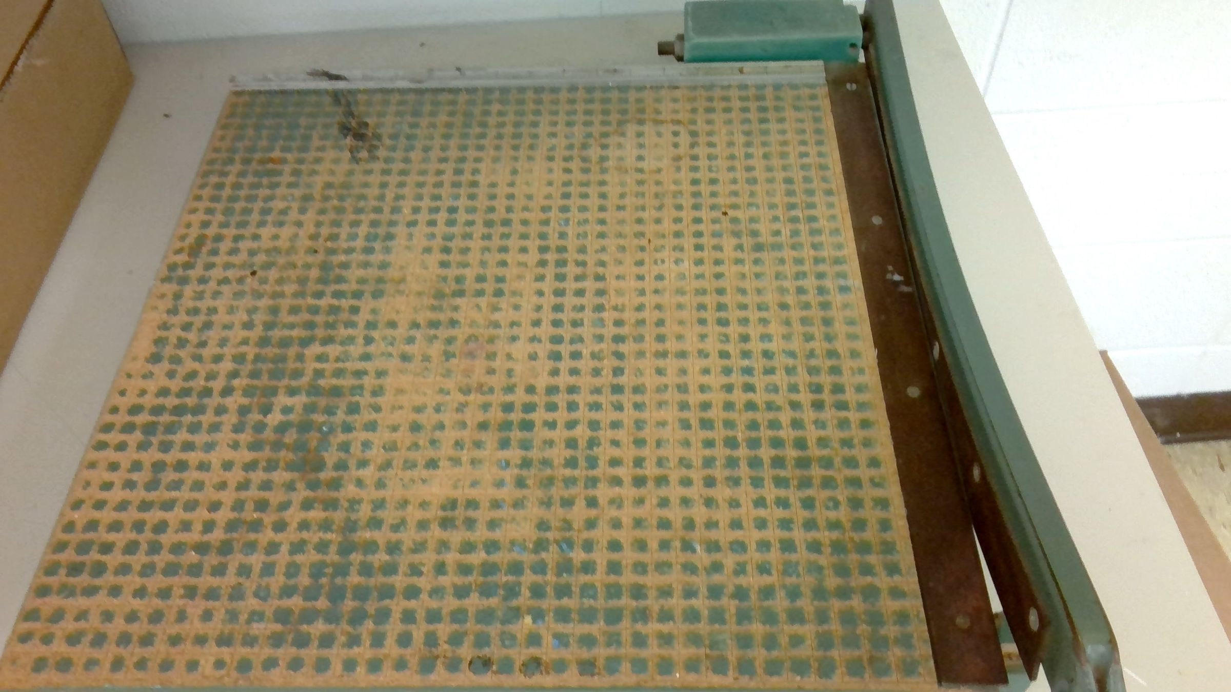

I feel confident to refurbish my paper cutters in my art rooms, but both of them cut slightly "off" (not at true "square".) Any tips before I begin the process? Thank you!
Here is a picture of the first one:
0
mikeasaurus
mikeasaurus
Reply 2 years ago
Try tightening the screw holding the blade to the base, any slop here will cause issue. Next, make sure the metal plate on the base that the blade cuts against is flat, since that's what defines the cut edge on your paper.
Good luck on the restoration! I'd love to see the results and any tips you might have to share.

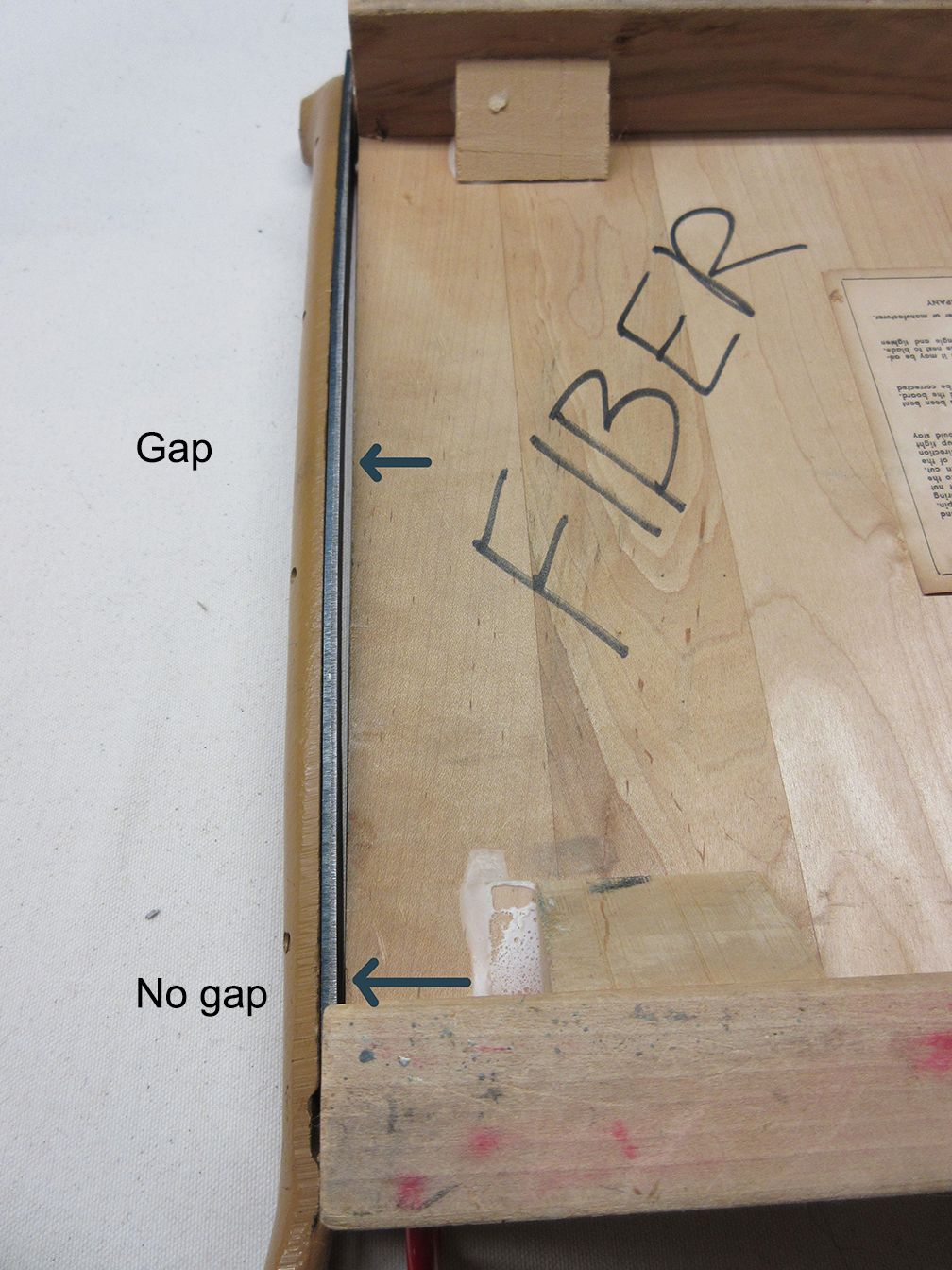

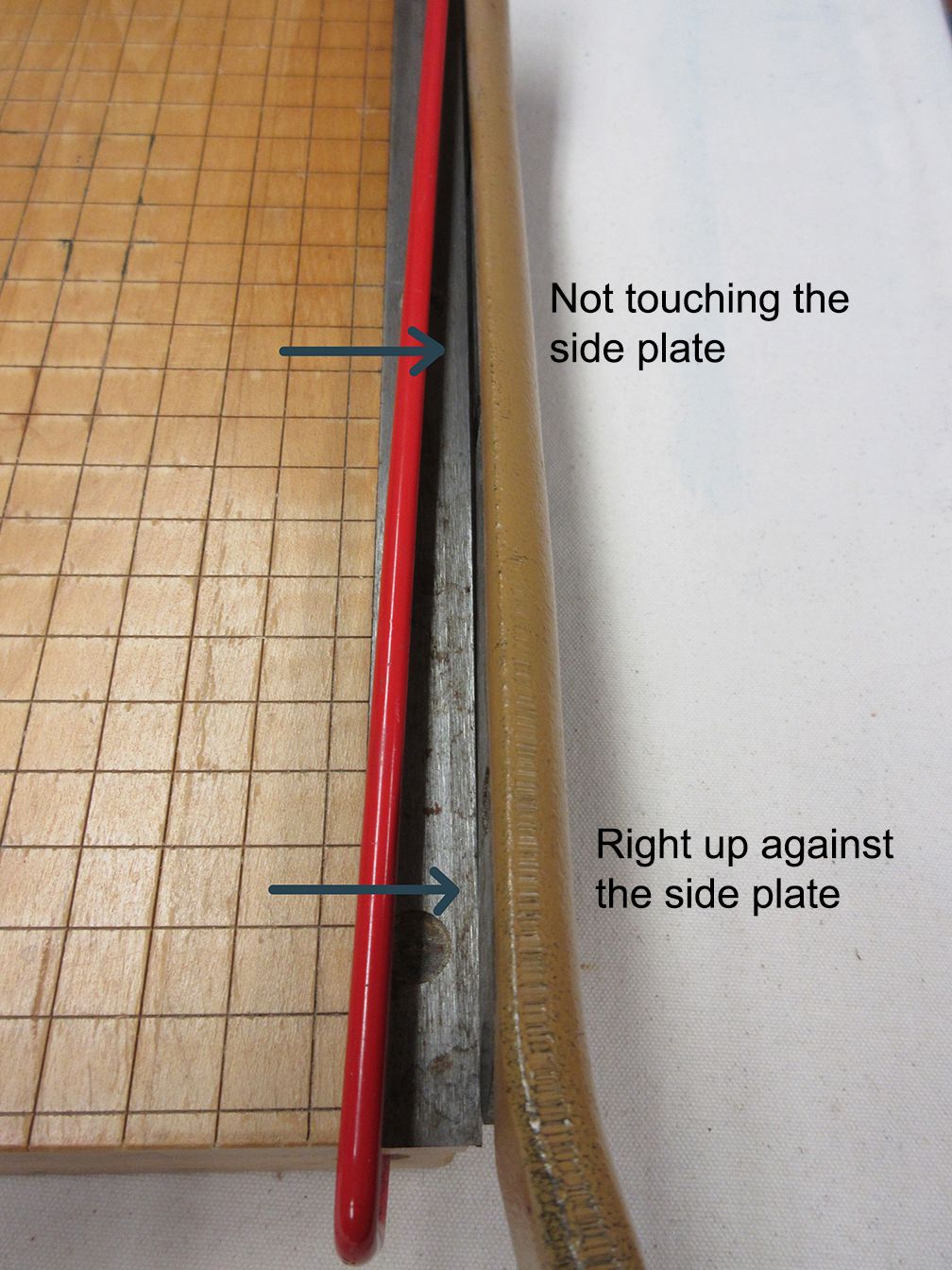

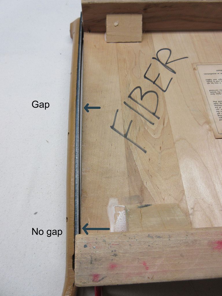

I have this same cutter and noticed recently that the blade is not perfectly parallel to the side plate. I plan on getting the blade sharpened. Should I get the side plate "sharpened" as well since it seems to have a slight curve to it. Thanks for posting this info. It's very helpful.
0
mikeasaurus
mikeasaurus
Reply 3 years ago
There's supposed to be a bend in the blade, bowing with the apex of the bow away from the cutter.
Lift the blade, when lowering watch where the blade meets the cutting edge - The blade should make contact the entire time it's being lowered.
If the side plate is bend then that will need to be straigtened. There's no need to sharpen that edge.

Thanks very much for the info Mike. The blade meets the cutting edge if I pull to the left slightly. The side plate is not bent but very slightly scalloped out. That's what I meant by "getting it sharpened". Here's a third pic. Should the gap look like this?
0
mikeasaurus
mikeasaurus
Reply 3 years ago
Mine look similar. What should happen is that the blade should be contacting the edge during action at one point, that point will move from the spring towards you as you pull the handle down. Like scissors the cutting only happens as the blade is closed, so it doesn't need to lie completely flat, only when the two side slide past each other.
It's not easy to explain, but should make sense when you watch the slicing action on your cutter.

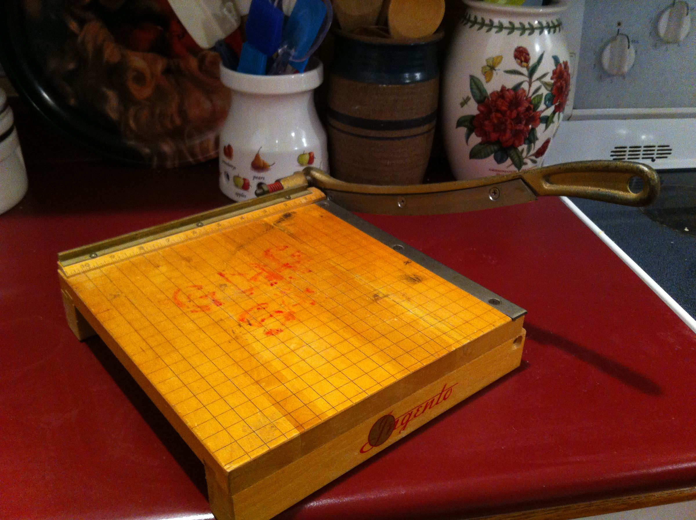

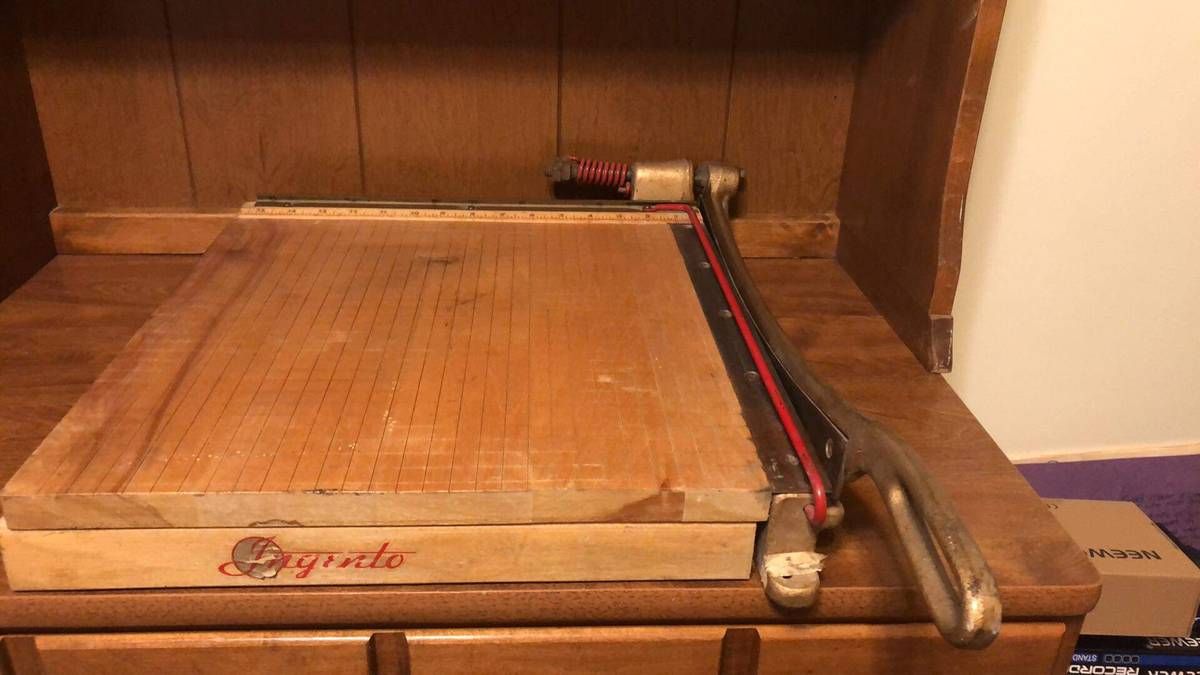

Question 3 years ago on Introduction
Hello,
Wow, you did an amazing job! Excellent work, and wonderful tutorial! I found you/this because I just found a similar cutter on Craig's List. The folks that are selling it live in a super nice area, haha, which makes me hope it is nice enough. I've emailed and they wrote back telling me they think it will work for what I need it for, which I explained "is cutting 140 lb (300 g/m squared) to 300 lb+ watercolor paper. I doubt all people know exactly what that means...? Oh, I also described the paper as being "quite thick".
I just wrote back asking if they had used it to cut "any paper" recently, and if they knew of any issues such as warping. Okay, haha, she wrote back and said:
"I'm I can get my daughter or husband to check things out for you tomorrow, but I am not too sure how picky they will be, lol.
Both of them aren't available this evening but i can message you by tomorrow early afternoon if that works for you." EDIT: This is just a portion of what she wrote, but it makes more sense if I explain that she has just broken her back and is unable to check it out herself. Also they are selling it because they are moving. END EDIT
So I am just trying to research a little. You may not get this in time...etc. But if I do purchase it, I will share about it here :-) Anyway, it looks like this; there is only one photo posted. I haven't yet been able to find another one that looks exactly like this one. Do you have any thoughts? It is only $20.00, they live real close to me, oh, and it is 15". Thank you!!!
0
mikeasaurus
mikeasaurus
Reply 3 years ago
All the parts appear to be there (the blade spring is of particular note). I think the largest issue with warping would be along the axis not shown in this picture, as that's where the dovetail dado connects the legs with the top. For reference, here's what mine looked like from the tutorial (https://cdn.instructables.com/FIM/XMAO/IVO4OHNS/FI...)
Ensure this connection is straight is what will give your cutter a true base. The legs need to be straight, and also in symetrical to avoid any slant or helical warping. Most cutters are fine if they've had any kind of servicing, or have been stored in a dry place - I say this only to advise what to look out for :)
Happy salvaging. For $20 it's worth it to try out your skills and bring life into a classic. Please keep me updated!

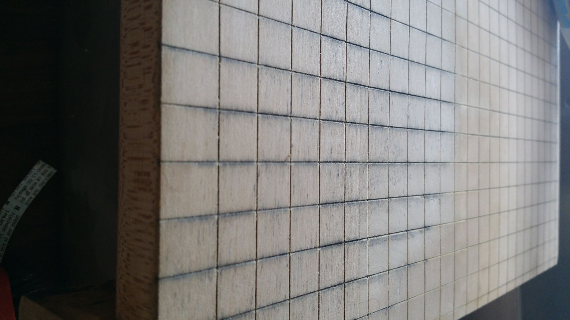

The problem is, one corner of the surface had [what I thought was] spilled ink. I figured I could sand it down easily enough, but it turned out to be [what I think is] the original ink/dye used between each half-inch score mark. At some point the surface of the ink must have been compromised, and with liquid, it seaped into the grain of the wood.
I've tried all kinds of bleaching agents, including hydrogen peroxide, an oxi-clean solution, a Clorox bleach pen, Clorox spray cleaner... And nothing does anything.
Any other ideas?
0
mikeasaurus
mikeasaurus
Reply 4 years ago
If the ink is into the grain of the wood then you're likely going to have to live with it. Any treatments applied to the surface could have unintended results.
If you're really brave you can surface plane the top to remove the wood to a clean level, then remark the grid lines. That seems like a lot of work. I'd say embrace the ink and make it part of the story of your vintage cutter :)
