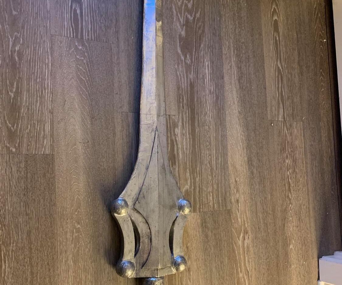

Step 1: Start With the Foundation
The first step was to drill holes for the wires, and mount the flange.
Step 2: Just the Tip
Next I wanted it to look more like a rocket. I used my Dremel with a metal cutter to remove the rounded top. I then sculpted a new pointed top and baked it. I need to coat the clay parts in epoxy for added strength. I also sculpted out the fins in black clay (baked them too) which you will see on the next step.
Step 3: Wire It Up and Test Assemble
Before fully and permanently assembling its good practice to test assemble. I did complete the wiring, wiring the base lamp and candlestick base to the lamp cord. The lamp cord is running through the wooden base and through the metal pipes.
The Fins were sculpted in clay and then fiber-glass resined to add strength, then epoxied to the base lamp.
Once I was confident about the build and wiring, I set up for painting.
Step 4: Painting
I used basic silver spray paint.
Step 5: Finished and Go for Launch!
I fully assemble all of the finished parts and turned it on!!
