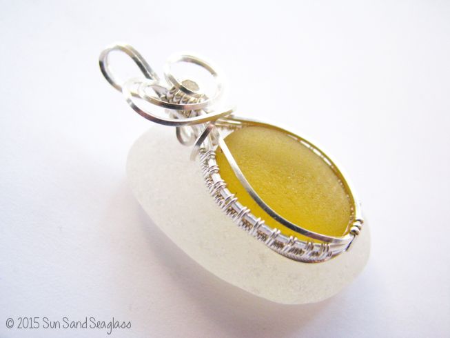

Introduction: Sea Glass Fish Pendant Tutorial
About: I love creating jewelry. I generally use genuine sea glass and sterling silver. For the last few years I have been focusing on wire wrapping but I would now like to learn to silversmith.
Have you been wanting to create something with your sea glass (or possibly a cabochon or rock)?
Well here is a tutorial for a super cute, sea life inspired sea glass pendant. I have used a piece of smooth green sea glass to create this adorable fish.
For this tutorial I have provided written descriptions, images, and animations, to help demonstrate the key processes.
The basic wire weave technique used in this tutorial is a little tricky to show, especially when working with silver on silver. This is why I made sure to include brightly coloured images and animations.
I have also included a troubleshooting and tips section (step 12) to help you master this project.
I hope you enjoy the tutorial!
