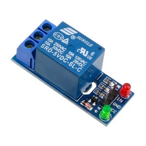

  • 1 Relay

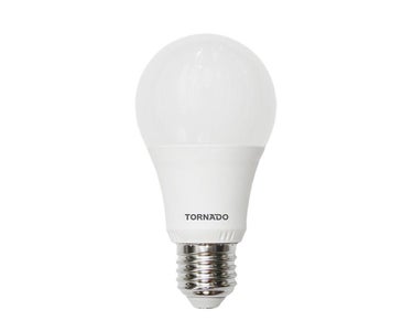

  • 1 Bulb
  • 1 Screw cap

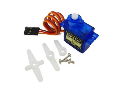

  • 2 potentiometer
  • 2 servo motors

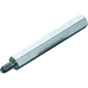

  • Spacers

Step 1: Test the Circuit
I write the code on Arduino programming and make the circuits by using these steps :
  1. Connect the Arduino to the breadboard by putting the positive (5v) and negative (ground) pins on the (+) , and (-) on a breadboard
  2. Put the LDR on the pin (4) on Arduino and (+) (-) on a breadboard
  3. Put (ultrasonic ) (echo ) on pin (2) (trig ) on pin (5) on Arduino and (+) (-) on a breadboard
  4. Put the potentiometer on one of them on the (A0) and the other on (A1) on the Arduino and (+),(-) on the breadboard
  5. Put the servo motor on pin (11) on Arduino and the other on (9) and put the other weirs on (+), and (-) on the breadboard

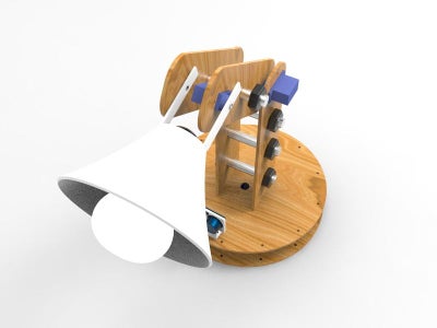

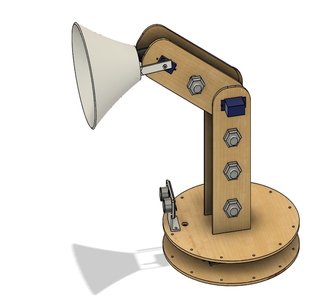

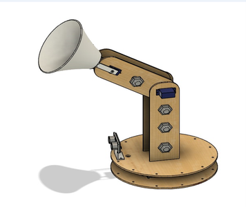

Step 2: CAD Design
I used fusion software to design a smart desk lamp and I used some tools to design it like Sketch, offset, projection, Extrude, revolve Joints, and Filet
The CAD process of the project
1. I design a drawn circle to make the bases of the lamp by using offset and extrude.
2. make a rectangle to make the arms in this step by using the sketch and offset
3. use a joint tool to join the parts of the design and the part of the lamp I used to make it revolve, extrude, and filet
4. I port nuts and nails to make the hole in the arms
Put Arduino, relay, ultrasonic, and servo motors

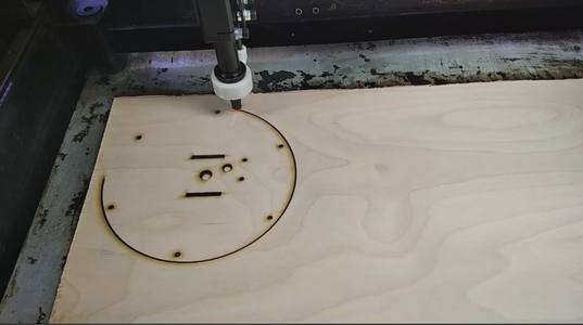

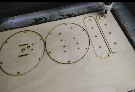

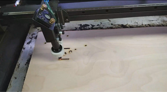

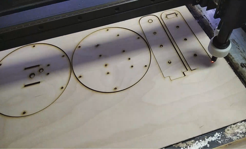

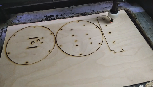

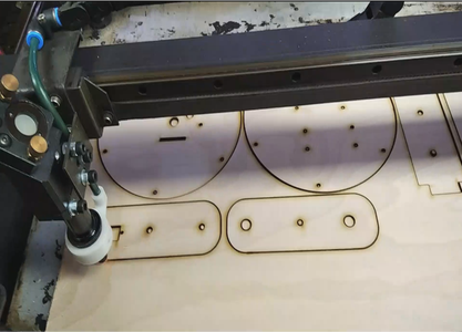

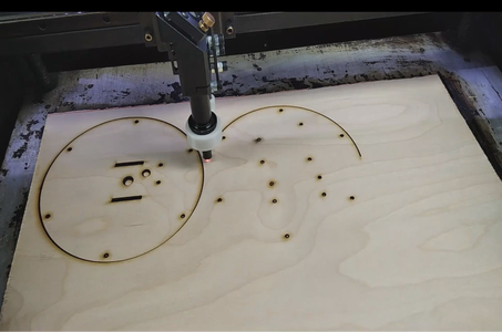

Step 3: Fabrication
I designed the shape of the desk lamp on fusion and I used a laser cutting machine to cut the two bases            and the four arms
I used 3D printing to print the part of the lamp and the part of ultrasonic
