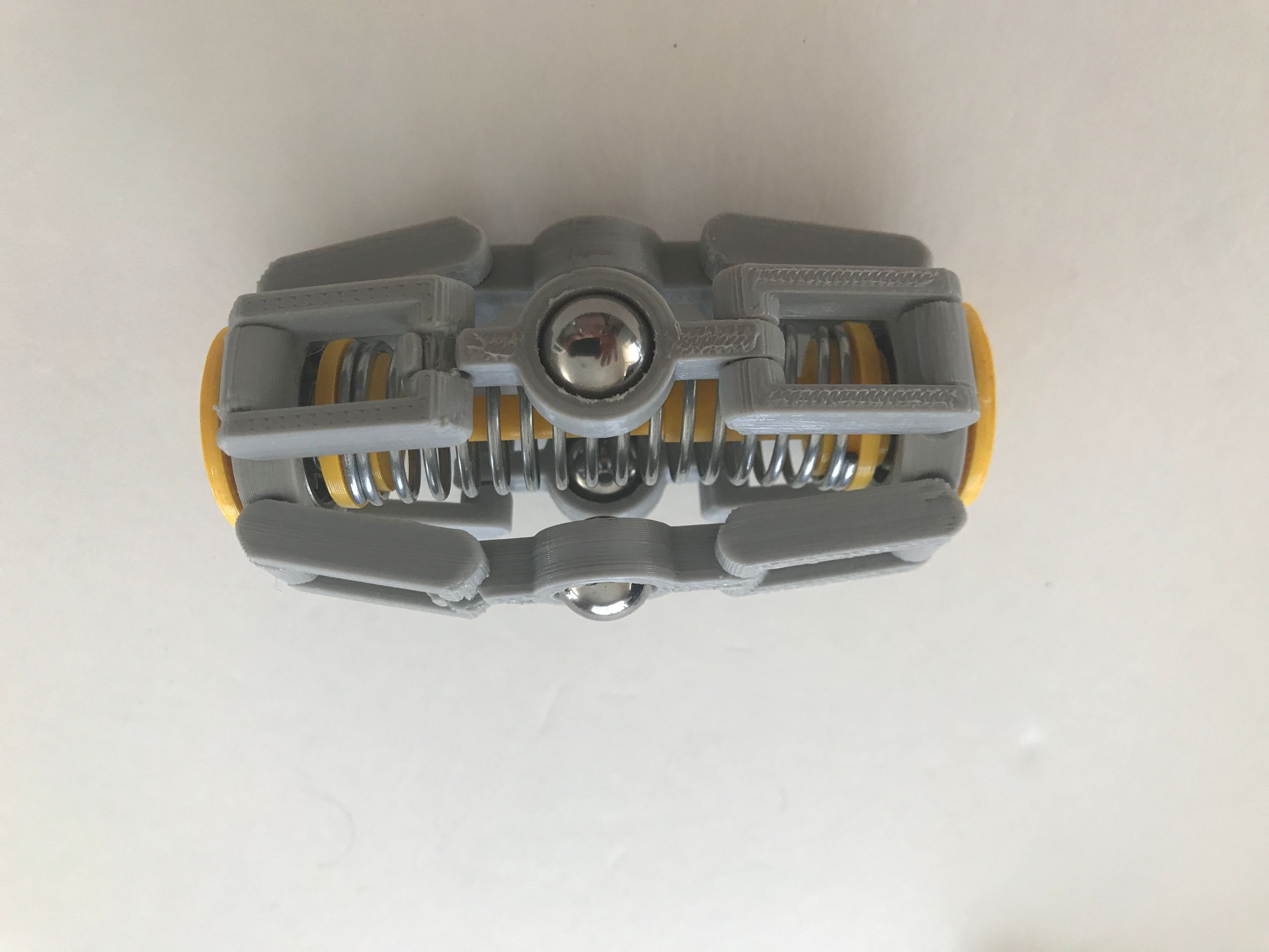

I designed the (gray parts) top housing as 1 part with enough clearance for the arms to rotate, and the bottom housing the same way with 4 hooks to snap together with the top housing. If you attempt this do not get discouraged if the parts don't fit exact, as I mentioned not all printers print exactly the same way. Play with the settings and you will be able to print it in one piece as it was designed to be.
Then came the (yellow parts) spinner end caps that are made to slide into one another to keep the spring located as it should be, while allowing you to completely compress the spring without having the spinner buckle in the middle.

Next step is to install the bearings, gentle push the bearing into the top and bottom housings as seen in the pictures. You may need alittle force as they were a tight fit when I did it. Then comes the 4 ball bearings. I used a pair of pliers to help install them, if you installed them correctly they will actually pop into place as the holder was made so they would snap into place. If you have the ball out one side more than the other then it is not fully seated. All I can preach here is patience is you friend.
Step 3: Continue Assembley
Take the yellow pieces that support the middle and assemble them to verify fitment as seen in the first two pictures. They should be installed end cap, spacer, then spring guide. The top and bottom are different but they will only fit on one cap each as they have different size holes.
You may have to clean them up some to get a nice fitment. Once they fit nice lets install them on the actual housing to verify they fit those also. Once on test spin them to see if you have any binding. If they are very sluggish or harder to turn make sure the spacer is installed after the bearing before the spring guide. I have included a short video of the assembly. While I was assembling it the first time I also applied a little super lube to any plastic pieces that had to move such as the two middle shafts.
