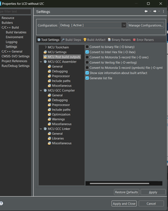

Step 6: Creating .Ioc File
  • Select the file you working on (from the left side)>right click on it.
  • A option box appears>select properties.
  • Then the dialogue box opens >select the C/C++ Build (from left side of it).
  • Select settings>MCU Post build Ouput
  • Choose the options shown in the image.
  • Then apply and close.
  • The .ioc file is created

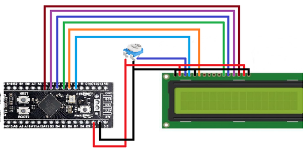

Step 12: Breadboard Connection
  • Connect the LCD with STM32 Black Pill similarly to the given connections.

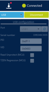

Step 13: Connect the STM32
  • Connect the STM32 Black pill with Laptop.
  • Connect it with STM32CubeProgrammer by USB.
  • BOOT the STM32 to connect it.
  • After connecting click on Connect
Step 14: Download the File
  • Goto Download>paste the copied of .elf file here also
  • Click on Start Automatic Mode.
