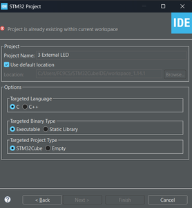

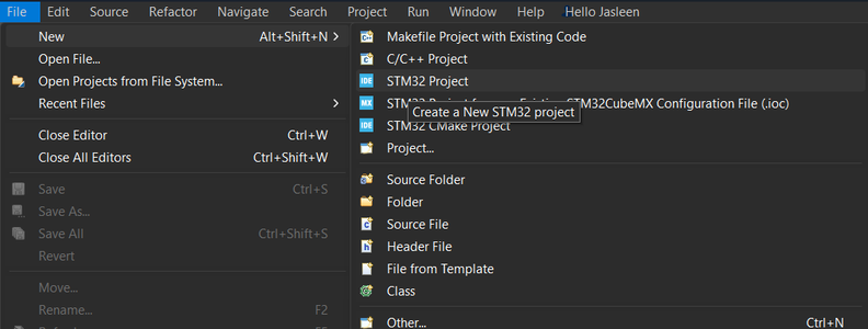

Step 1: Creating a New Project
  • Open STM32CubeIDE>Goto files>click New>select STM32 Project
Step 2: Adding MCU/MPU Selector Features for STM32 Project
  • Enter the Commerical Number of STM32 you want to work with( used Commerical Number in this project:STM32F401CCU6)
  • Select the required type of configuration of STM32.
  • Then click next.
  • A dialogue box appears >type the name of the project
  • The project file is created to work on it.

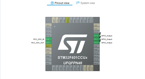

Step 3: Pinout Configurations
  • Select RCC from System Core.
  • Select the Cereamic/crystal response in High speed clock.
  • Some configurations wlll be added ,i.e,RCC_OSC_IN & RCC_OSC_OUT ON STM32 board of cubeide.
  • Select the Pins for output .(here I used PA10,PA11,PA12).

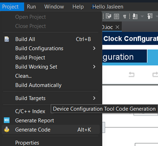

Step 5: Generating the Code
  • Select the project from dialogue box.
  • Select generate code option from it.
  • The code gets generated.

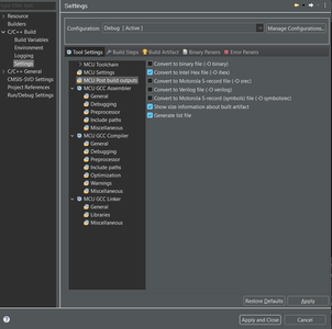

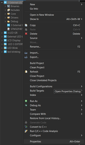

Step 6: Creating .Ioc File
  • Select the file you working on (from the left side)>right click on it.
  • A option box appears>select properties.
  • Then the dialogue box opens >select the C/C++ Build (from left side of it).
  • Select settings>MCU Post build Ouput
  • Choose the options shown in the image.
  • Then apply and close.
  • The .ioc file is created.

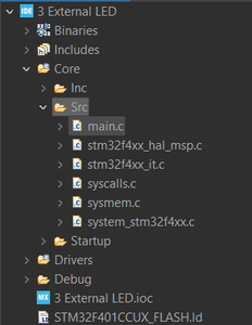

Step 7: Main.c
  • Select the core from the File .
  • Go to Src>select main.c.
  • Main.c gets open to write code.(A code is generated already to help you in the configuration and to identify pin numbers you selected as output pins)

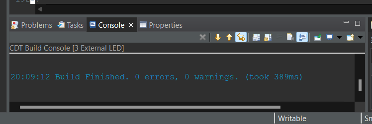

Step 9: Debug the Code
  • Select Build >select option 1.debug

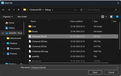

Step 10: Copying the Path Of.elf File

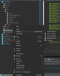

  • After debuging the ;if any error arises then remove all the error and if no error comes then go to .ioc file.
  • Select .ioc file right click on it ,a option box appears.
  • Select show in>system explorer.
  • Files will be opened.
  • Select the .elf file and copy its path.
Step 11: Adding the .elf on STM32CubeProgramer
  • Open the STM32CubeProgrammer.
  • Select the Open file option >paste the path copied of .elf file there.
  • File is added.

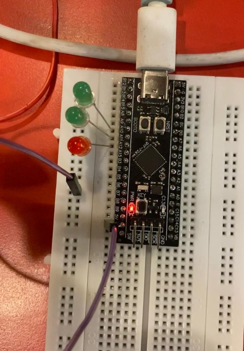

Step 12: Breadboard Connection
  • Place the Stm32 on breadboard.
  • Connect the LEDs with STM32 by the pins given in STM32CubeIDE.
  • Ground the LEDs with the ground pin from STM32.

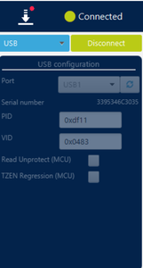

Step 13: Connect the STM32
  • Connect the STM32 Black pill with Laptop.
  • Connect it with STM32CubeProgrammer by USB.
  • BOOT the STM32 to connect it.
  • After connecting click on Connect
Step 14: Download the File
  • Goto Download>paste the copied of .elf file here also
  • Click on Start Automatic Mode.
Step 15: LEDs Start Blinking According to Combinations
  • Disconnect the STM32.
  • Then connect again and you will see that the LEDs are blinking in the combination of 001,010,011,100,101,110,111.
