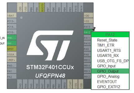

Step 3: Pinout Configurations
  • Select RCC from System Core.
  • Select the Cereamic/crystal response in High speed clock.
  • Some configurations wlll be added ,i.e,RCC_OSC_IN & RCC_OSC_OUT ON STM32 board of cubeide.
  • Select the Pin number for output .(here I used PA12).

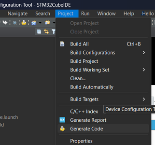

Step 5: Generating the Code
  • Select the project from dialogue box.
  • Select generate code option from it.
  • The code gets generated.

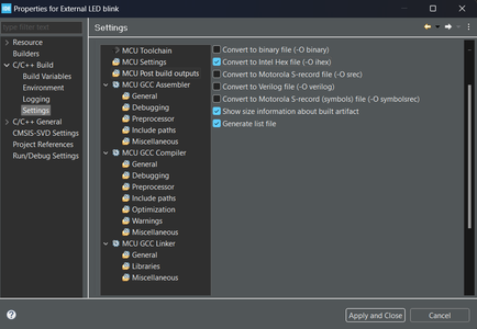

Step 6: Creating .Ioc File
  • Select the file you working on (from the left side)>right click on it.
  • A option box appears>select properties.
  • Then the dialogue box opens >select the C/C++ Build (from left side of it).
  • Select settings>MCU Post build Ouput
  • Choose the options shown in the image.
  • Then apply and close.
  • The .ioc file is created.

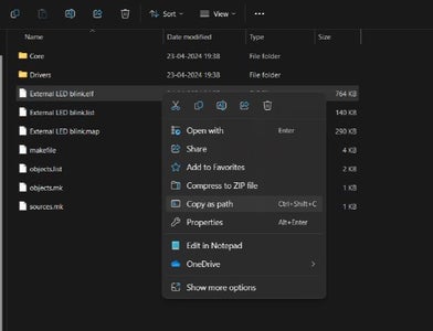

Step 10: Copying the Path Of.elf File
  • After debuging the ;if any error arises then remove all the error and if no error comes then go to .ioc file.
  • Select .ioc file right click on it ,a option box appears.
  • Select show in>system explorer.
  • Files will be opened.
  • Select the .elf file and copy its path.

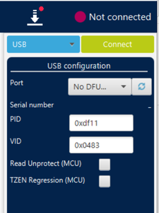

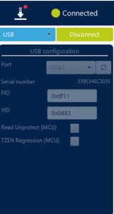

Step 13: Connect the STM32
  • Connect the STM32 Black pill with Laptop.
  • Connect it with STM32CubeProgrammer by USB.
  • BOOT the STM32 to connect it.
  • After connecting click on Connect.
