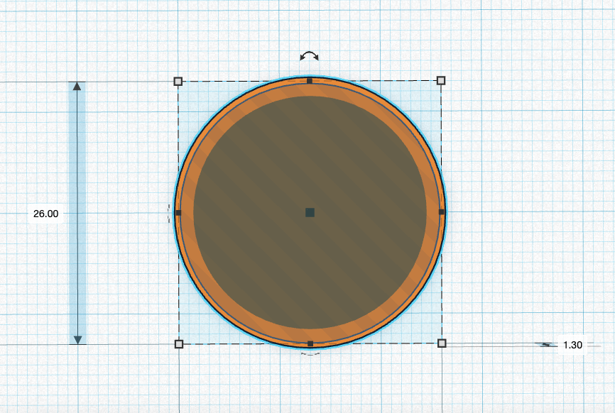

I created these designs using Tinkercad and I started with the basic size and shape of the earring. I ended up with a 26mm cylinder with a cutout of 22.5mm and a thickness of 1.30mm (about 6 layers)

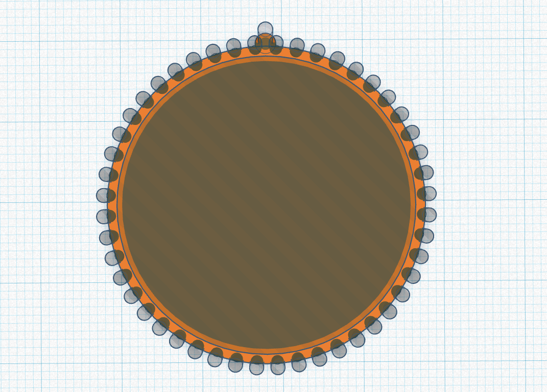

Next, I needed to create the cutouts where the strings would loop around. I made cylinders that were 1.52mm in diameter. I knew I wanted them in increments of 3 in order to get the pattern I wanted, but I found it was easier to evenly place them in even numbers, so I started with just two and put them evenly spaced up and down. I grouped these 2 cylinders are together.
Now that I had two, I could copy and evenly rotate them.
Once I had 6, I had my increment of 3, so I grouped these 6 together and copied and rotated them until I had as many holes as would reasonably fit around the circle.
Center everything to make sure everything is evenly spaced.
Group them to cut out. Once I cut them out, I knew I wanted a space on the top for the loop so I rotated it so I had a space between holes on top.
Now with my space on top, I created a loop for attaching the earring. I used a cylinder that was 2.40mm in diamter with a cutout that was 1.52mm in diameter.
Group it and you'll have your earring.
I repeated this process for the necklace but since it was much larger, I had many more cutouts going around.
Dimensions for the pendant include: 38.50mm cylinder with a 35.00mm cutout and is 1.3mm thick.
Small cirlce cutouts at 1.52mm.
2.40mm diameter loop with a 1.52mm cutout.

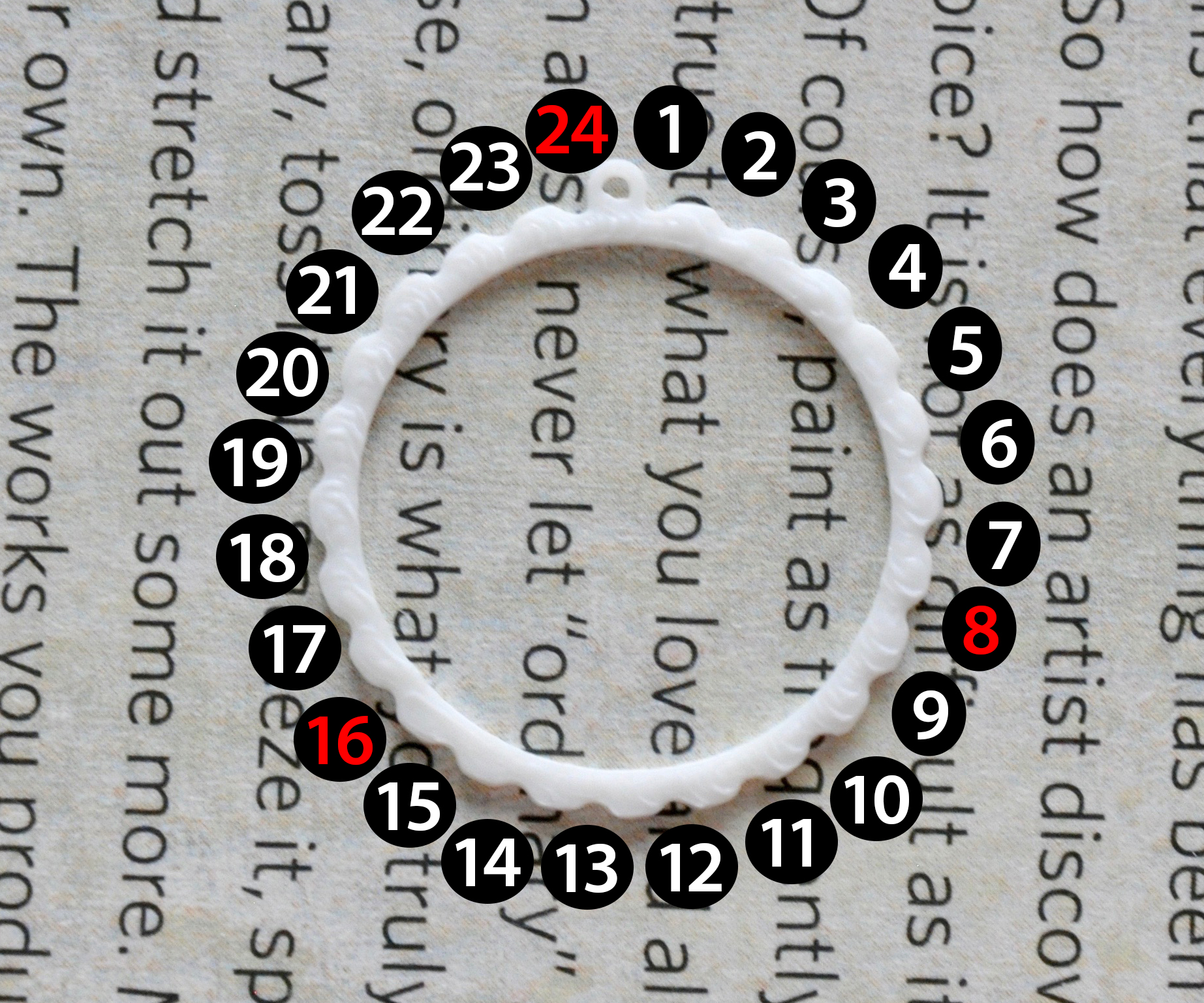

The wrapping can kind of get confusing. To try to make it easier, I did a little number chart on this white one for reference.
For this part, you need your printed piece, string, tapestry needle, and glue.
I'm going to give you the number pattern, but the important thing is you hit the 3 first numbers 24, 8, 16 and then just shift to the right one as you go around.
So to start you need to have the end of the of your string in the back and have it hang behind 15. Keeping it in back, bring it up to 24 and wrap it around to the front.
Bring it through the center of the circle so you are at the back again and bring it around the outside to the front of 8.
Bring it through the center of the circle and bring it around to the front of 16.
Bring it through the center of the circle right away (make sure you always bring it through right away so it goes behind the other strings, this will be more apparent as you get more strings going) and bring it around to the front of 1.
This is the point where I glued down the string behind 15. Let it dry before you finish threading the string. You can glue it down behind 15 right away, I just found doing the first round of wrapping helped hold things in place.
The rest of the order is: (glue behind 15, 24, 8, 16, 1) 9, 17, 2, 10, 18, 3, 11, 19, 4, 12, 20, 5, 13, 21, 6, 14, 22, 7, 15, 23, bring through center and to the back of 8
Glue the string down behind 8.
