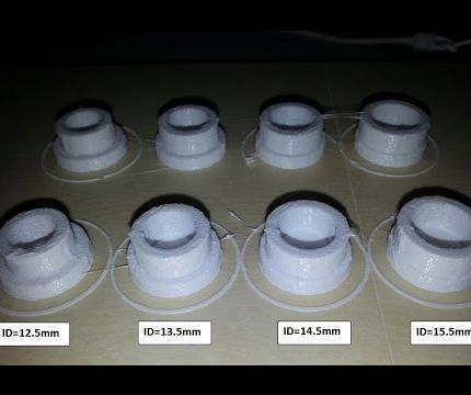

Step 1: Overview
Hot End Temperature: 195degC
Print Bed Temperature: 70degC
Filament Material: PLA
Slicer: Simplify3D
As you can see, benefit of printing on glass is that the base is extremely flat and smooth with a mirror-like finishing.
Always remember to include tolerance in the 3D design before printing, othwerise require a lot of sanding and even lubricant to assemble the components together.
