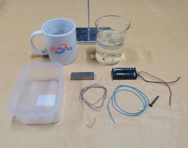

Experimental Equipment:
Regular cup
rope
transparent plastic bag
small magnetic needle
rectangular box
glue gun
steel balls
5 square magnets
