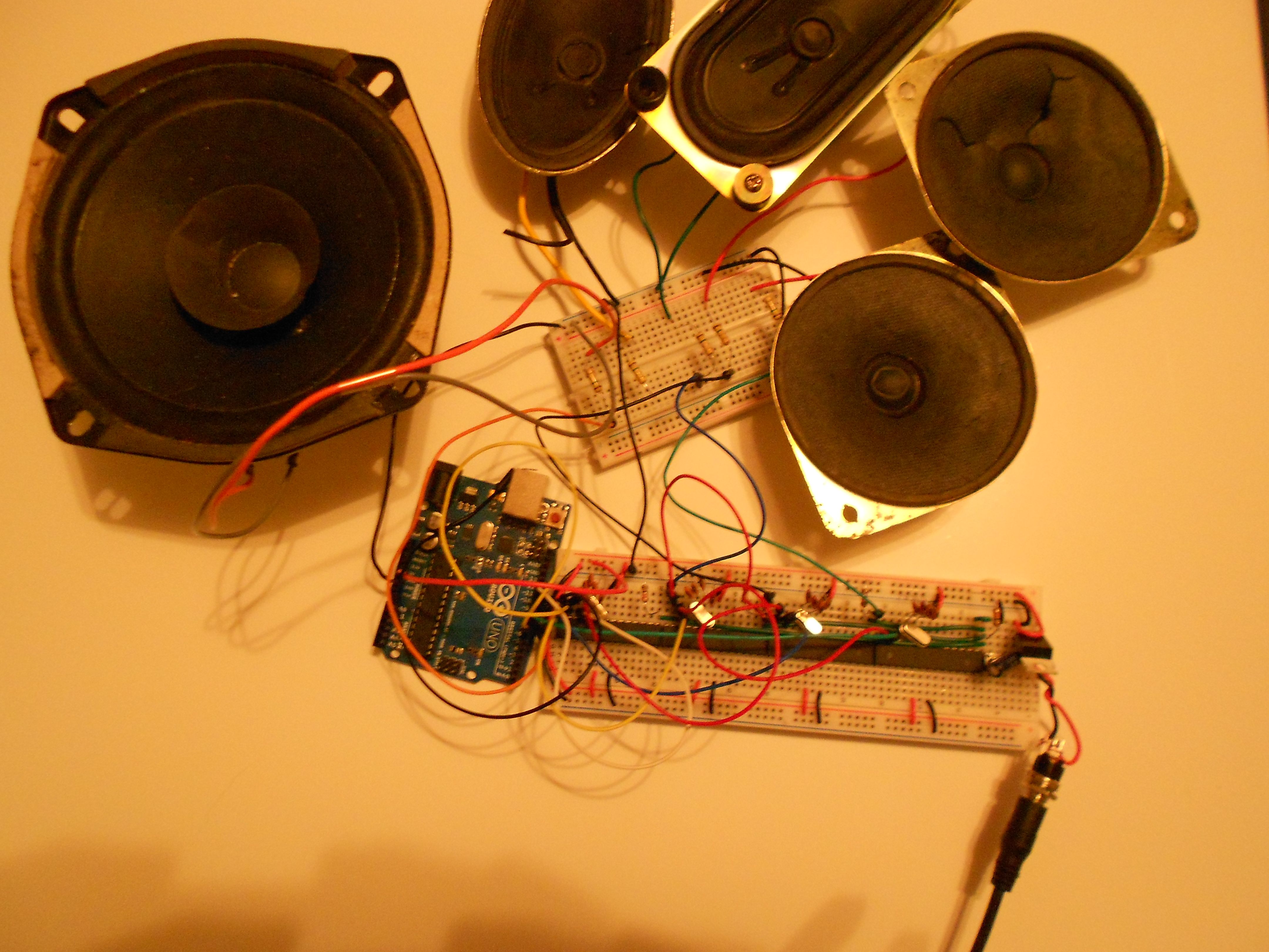

Step 3: Circuit Prototype
It's good to check that the code gets along with the hardware. I like prototyping every step to make sure I know what works and familiarize myself with the circuitry.
Copy the code in this pastebin and paste it into the Arduino software:
http://pastebin.com/iVrpuhkm
Upload it to the official Arduino.
Set up the circuit in the image.
The resistor is just there to make sure that the button stays at ground. An open pin will read a whole bunch of weird voltages from charge floating around and building up around it.
If you press the button between 1 and 10 times (inclusive), the speaker should purr the same number of times. You just entered the first digit of the first number (10 presses for 0). You can repeat this up to 9 times for 9 digits, after which it will start squeaking at you. Also, the button and breadboard don't like each other in my experience and the contacts aren't always solid. If it still gets some presses but too many or too few, it's probably the connection.
If you hold the button until it emits a low purr, you move on to the next factor. Enter digits the same way.
If you hold the button until it purrs again, it should purr out the product of the two numbers you entered as a set of purrs for each digit followed by a pause. Yay, it works! There is currently no protection against overflow errors. You'll just have to deal with the fact that if the product is over 4,294,967,295, you'll get some wonky numbers.
If it does a high-pitched squeak, it's an error code. You either pressed the button more than 10 times, tried to enter too many digits, or you tried to multiply without entering a number.
If you read, "Yay, it works!" and said, "No, it doesn't," then that's sad. Try resetting the Arduino. Make sure the button is actually in the board, as it sometimes gets pushed out. Make sure the button is in the correct orientation. The legs should be sticking out of the top and bottom rather than side to side.

Step 4: Circuit Prototype Again
Okay, let's make a clone Arduino do it. If you are okay with sewing a real Arduino and proto-shield into your tribble, then you don't have to do any of the steps about a clone Arduino. I just don't have a bunch of Arduinos lying around.
This is a schematic I use all the time when making Arduinos on breadboards or PCB: http://www.fiz-ix.com/2012/11/schematic-of-a-breadboard-arduino/ I don't have a reset button in mine. It resets automatically when the power gets cut.
The easiest way to program an ATmega chip is to put it in the official board, upload, then pull it out again. There are ways to just wire up a board without a controller, but it still involves pulling chips off. Be careful not to break pins. Use a tiny flathead screwdriver to pry it off. Make sure you line up the end of the chip with the little notch with the notch in the IC header of the Arduino.
Once the chip is programmed, build it into the circuit below. (Watch the polarity on the capacitor. It's fun to pop them, but not good for anything else.)
It should do the same stuff as last step, still. If not, double check. Watch the button as it likes to pop out. Look at the datasheet for the LM7805 to make sure it's wired right. Make sure you put the notch in the ATmega is facing the right way. If you put it in wrong, you may have to re-program it. Check that one resistor goes to power and one to ground, as it's easy to mess up. (I'm going to pretend I didn't accidentally do all of those things.)
