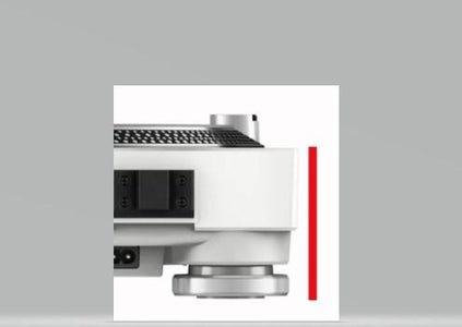

Step 1: Measuring
The main measurement you'll need is the height from the surface on which the turntable is placed to the top surface of the plinth, as indicated by the red line above. This should ideally be the height of your platform. Note that this measurement needs to include the height of the turntable's feet plus that of any isolation platform or similar that you may be using (unless you plan to park this device on it as well) but should exclude the height/thickness of the turntable platter, which can be matched using the sweep arm's height adjuster. The adjuster will probably have enough range to also allow for a platform that falls very fractionally short of the ideal height. This is the case here, but check first if necessary. When properly set up the arm should supposedly lie horizontally parallel to the record, but in reality a very slight tilt in the direction of the brush can help to keep it in contact with uneven or warped discs, which can be contrived if the arm has an adjustable counterweight.
