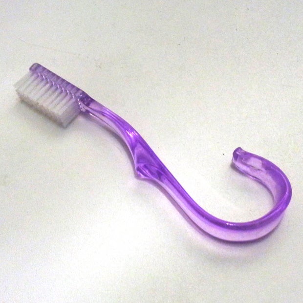

I created a hooked handle for my toothbrush by heating a polypropylene toothbrush over an electric stove and bending it around a bottle neck. Making your own hooked toothbrush is easy!
Here's what you need:
tools:
| materials:
Step 1: Toothbrush Bending
- turn heating element on high
- prepare an ice bath using a large bowl filled 2/3 with water and fill with ice cubes, set aside
- put on thick work gloves to protect your hands from the heat
when element is hot, slowly rotate toothbrush handle over element
DO NOT TOUCH TOOTHBRUSH TO ELEMENT - after about 20 seconds the toothbrush handle will become soft and pliable
- wrap handle around mandrel to create desired hook shape, hold in place for 10 seconds
- submerge hooked handle into ice bath and let sit for another 10 seconds
- repeat steps 4-7 to refine the curve if required

Step 3: Further Reading: How NOT To
My first attempt to make these hooked toothbrushes followed this Instructable on how to make a toothbrush bracelet which involves using boiling water to create a large radius bend in a toothbrush. After boiling my toothbrushes for about 10 minutes I removed them with kitchen tongs and bent the toothbrush handle around a mandrel to create a small radius bend in the handle. Unfortunately the bend radius I wanted was too small and I snapped all my toothbrushes.
The boiling method may be good for making bracelets (wide radius curve) but doesn't work so well for making hooked toothbrushes (small radius curve).
Step 4: Final Thoughts
The hooked toothbrush works well and is really fun to use. A minor complaint would be that the handle is a little short, allowing only 2-3 of my fingers to grip the handle. This isn't a big deal as it's not uncomfortable and you don't really need to have all four fingers on your toothbrush anyway.
