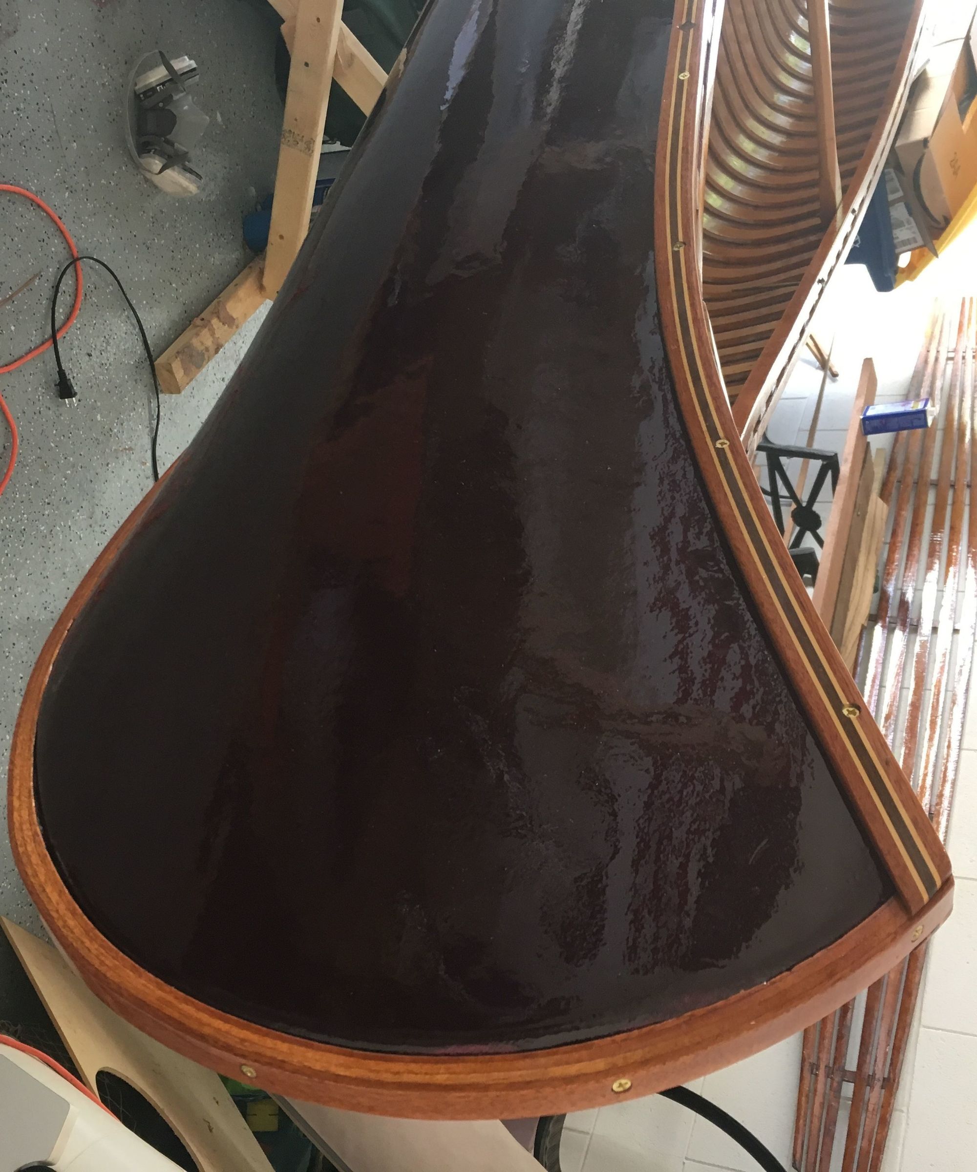

    It works beautifully. For sure the quietest boat I have ever paddled! I take it on a mountain lake in Colorado and 1.5 years after finishing it up it looks as good as the day I finished it. Definitely worth it to use high quality varnishes and paints. As far as things to do over I would make sure to re-clinch ALL the ring nails that attach the outer planks to the ribs...I had an original nail loosen a bit recently and I can see it as a little bump under the canvas skin. Hard to re-clinch now as hammering through the canvas skin isn't a great idea

    Thanks so much! I did a weight test today and the boat came in at 66.3lbs and is 16ft long. Mine is for sure heavy, The decks, seats, and rails are hardwood and could probably be switched for a lighter material (Though I did specifically go for a lower density mahogany on the rails).I think this is actually similar to your average fiberglass boat but far heavier than the amazing composite canoes being built today which I believe are in the low 30lbs. With that in mind though, I have heard of quite a few wood canoe owners doing hundreds of miles and portages in the Boundary Waters and other places.
