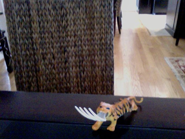

Step 2: Soldier Fork
The head of the soldier will be replaced with the fork head, a portion of the handle will be located inside the hollow cavity of the soldier body. This toy soldier had several screws located in the back, take a small screwdriver and disassemble the torso.
With the torso open, position the head of the fork in neck opening of toy soldier. There will be an optimal position in the neck opening depending on where the fork neck tapers into the handle. After the fork head has been positioned, mark on fork handle where the hollow torso ends. The excess fork handle will need to be removed in order to fit inside torso cavity.
