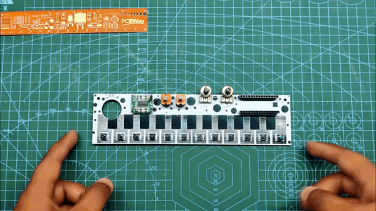

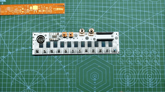

Step 4: PCB ASSEMBLY

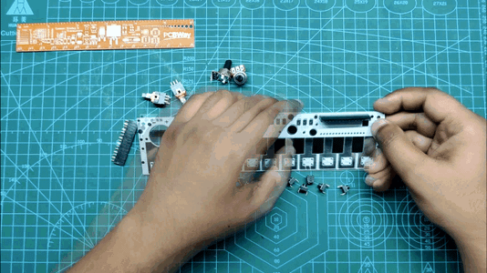

Before starting the PCB Assembly, we need to gather all the components we will use in this project.

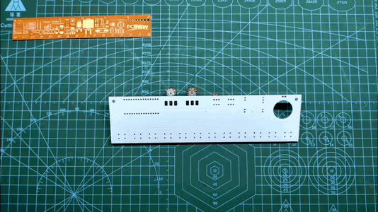

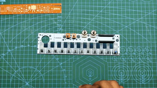

Step 5: Adding Header Pins, Switches, and Pots
We start first by adding Header Pins for Arduino Nano, switches, and pots in their place.

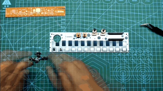

Step 6: Adding Push Buttons
Next, we add 12 Push Buttons in their place one by one.

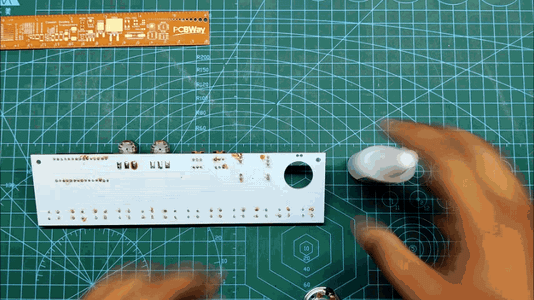

Step 7: Soldering the Components
After placing all the switches and header pins in their place, we solder their terminals to the PCB by using a regular soldering iron and solder wire.
Step 8: Adding PAM8403 Module
Next, we add the PAM8403 Module in its place by using some male header pins, we add male header pins on the PCB and then add PAM8403 on the header pins.
at last, we solder the pins and secure the module in its place permanently.

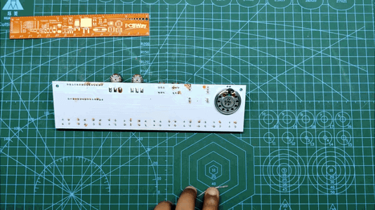

Step 9: Adding Speaker
At last, we add a speaker in its place.
I added a hole on the PCB, the goal here was to add a speaker from the backside through this hole. Speaker is glued to the PCB and then we connect the terminals of the speaker with PAM8403 CON2 Port through two jumper wires.
After doing this, the PCB is completed.

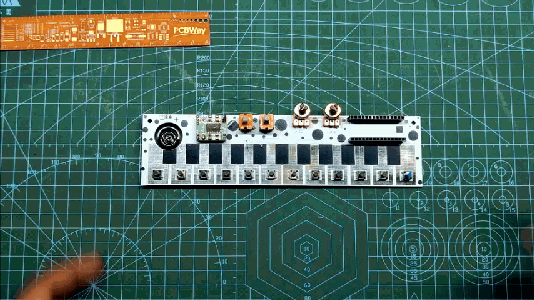

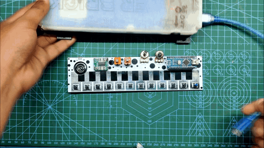

Step 10: Result of PCB ASSEMBLY
Here's the result so far, all the components are soldered and the board is completed. It looks pretty much like an Arduino Nano Sheild or addon board.
The next step is to add Arduino Nano to this board and flash the main sketch into the MCU.

We first add Arduino Nano in its place and then flash it with the code, result will be a working synth playing random humms, we can alter the sound by pressing buttons or modulating the potentiometers or ON/OFF Switch.
Step 12: RESULT
Here's the overall result, watch the video for the demo.
