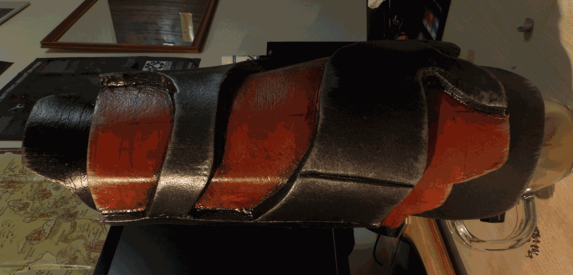

Step 9: Bonus Step: Extended Tutorial on Forearm Armour
The forearms are comprised of 2-3 overlapping layers, with the grey sections forming the outermost layers, and the orange lying underneath the top half. The orange section makes use of two score lines on the inside to achieve sharper bends, and is bevelled on each side to help it merge with the outer layers (Prevents sharp edges inside).
The two black rectangles were cut out, sunk in, and re-glued to avoid making any un-necessary cuts.
The sketches for the right forearm shown in the first image are approximations of the original dimensions, since they change when bent or heated, so they serve as a rough outline, The lettering system I used isn't strictly designed to show where 2 points meet, but does show how far around the wrist each part should be, for example: Points labelled "A" will be on the left side of your right arm as it is held out infront of you, points "C" will be underneath, points "D" will be on the right side and point "H" is at the top. The 3 sections on the lower page of sketches all join up edge to edge to form a complete circle, although I fitted the underarm and orange sections together first to test the fit on my arm.
