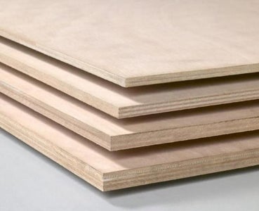

  • plywood of choice (12mm for this particular drawing in the Instructable)

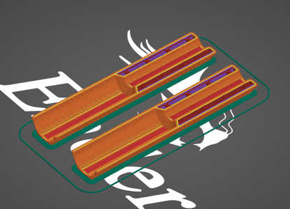

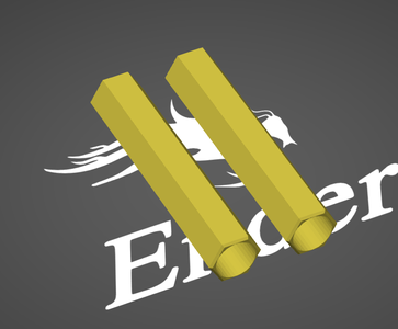

To easily attach the shelf to the wall, I modeled a hexagon shaped insert that is directly screwed in the wall and enables the shelf to be shoved over two of them. These are 3D-printed with preferably a tough material.
The 3D model can be downloaded at this step.
The wall I attached it to is made from a thick wood plate material so I was able to screw directly into it after correctly marking the center points. Use wall plugs if your wall material requires.
If you're using the DXF from step 2, the center points of the plugs are spaced 474 mm apart. Make sure the holes drilled or center have the same distance as the holes in the wood have. Use a laser or a level to make sure they are nicely horizontally aligned.
Two screws are inserted in them en tightened half trough the part, as far as it goes. If the inserts are properly attached, align the holes over the them and shove it all the way down to the wall. Make sure there is no play between the wall and the shelf to have the best support.
