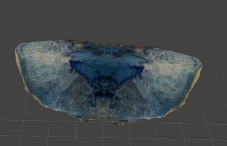

Step 3: Cleaning Up Scan in Meshmixer
Steps:
  1. Import .obj file from scaniverse into meshmixer
  2. Use select tool to get rid of everything in the file except for the geode
  3. Use the inspector tool to fill in any holes in the geode

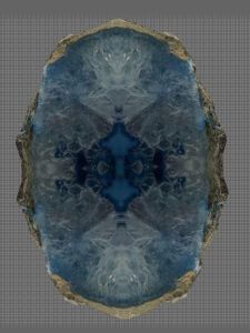

Step 4: Creating the Shape You Want
Steps:
  1. Find the side of the geode you like the most
  2. Still in meshmixer, use the mirror tool to create a longer geode
  3. use the mirror tool again to create a full circular geode
  4. Make sure it is to scale
  5. Export as an .obj file
