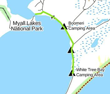

Step 6: On the Beach for a Stroll
Testing the range was done on a beach.
Two of us walked 400 metres in opposite directions and then reception was tested.
To my surprise reception remained clear.
At 3 kms apart, one of the walkie talkies was held horizontal while the other remaind vertical. This resulted in a distant loss of reception and clarity. So keep both vertical for better reception.
Testing both the aluminium and wire counterpoise didn't appear to make a difference as reception remained clear until 4 kms apart when it became poorer. I walked up a 20 meter sand dune and reception became clear again. On coming back down to the beach, reception still remained clear. The beer can reflector was tried at one stage but got blown around a bit by the wind.
One of the walkie talkies lost connection during the tests. It was later found the channel had accidentally been changed. To prevent this from reoccurring, the 'lock' button was pressed.
After walking 2 kms in different directions (4kms total) on soft sand in the heat of the day it was suggested future testing could be done by driving to increase distances.
Step 7: Around a Bay
The next morning another distance test was performed by driving from the camp and checking reception.
After 1.2 km reception became unclear, probably due to the terrain.
After continuing travelling around the bay, reception improved and at 3.3 km was crystal clear. The map shows the line of transmission would have been across the bay.
