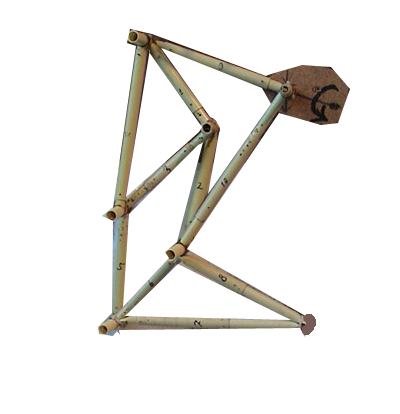

Try with pvc pipe.
Here is a template i made for the strandbeest designs
