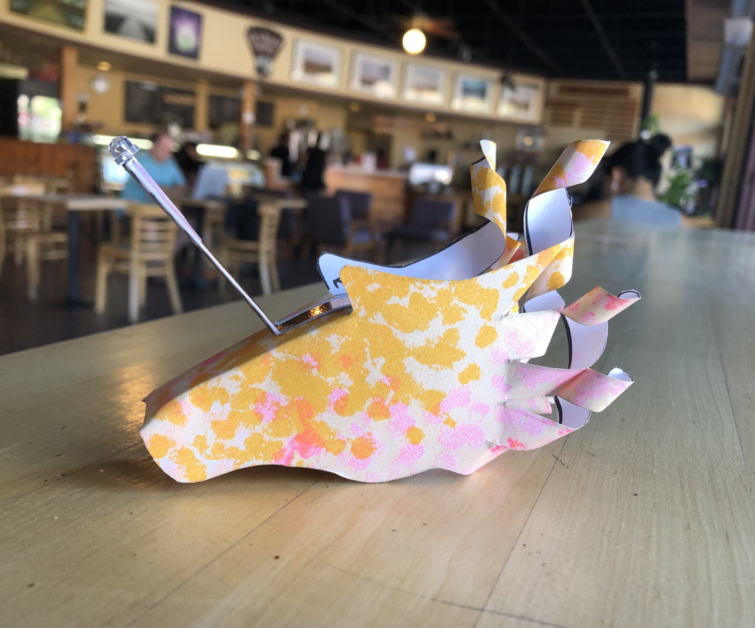

Use permanent markers (like Sharpies) to draw the design you want on a piece of shrink plastic, remembering to make it 2-3 times larger than you want it to be after shrinking, and cut it out. (I drew thick black lines on my pieces to make them easier to see)
The front piece will be what you attach the LED to, and usually has the most decoration.
The back piece can be whatever shape you like, often it's the same size and shape as the front piece. Punch or cut a hole (about an inch in diameter) in the center to make room for the LED legs. If you prefer power tools (or if you forget to make a hole beforehand), you can drill a hole after you shrink the back piece.
The side pieces can be designed however you like, I've created them to be just the size to fit a 10mm LED. If you cut three 1.5-1.75" squares, they will shrink to about the right size.
Pop em on a tray into an oven or toaster oven (a microwave won't work) and watch them shrink. Wait til they have stopped curling, have flattened out and stopped shrinking, then carefully pull out the tray, letting them cool for a couple minutes before removing them.
The curling that happens during the shrinking process will usually fix itself, so wait for it. On larger pieces, there's more of a risk that the sides will stick together. If this happens, working quickly, pull the tray out and use pliers to gently separate the stuck edges, then pop it back in the oven until it flattens.

Once you have all of the pieces, it's time to assemble them.
Apply a glob of hot glue to the front piece, and press in the end of your LED til it's cooled enough to hold it. The other small side pieces are glued at points around the LED. For the back, run a line of glue along the top of the side pieces, slide the LED legs through the hole and press it together. Tada! You have a 3d shrink plastic shape! See what other kinds of shapes you can make.
Step 5: It's Aliiive! (Adding Power)
At this point, you can simply slide a coin cell battery between the legs of the LED and tape it in place, or you can build a slot to hold the battery. See the photos for my method of making a battery pocket. I used pliers to bend the LED's negative leg underneath and its positive on top of a gap for the battery. Since I needed for the positive leg to get to the top without touching the bottom of the battery and shorting the circuit, I used a bit of hot glue to insulate that part of the leg. The pocket is completed by glueing on a small strip of unshrunk plastic to keep the battery in place. Pop the battery in to turn it on, push it back out to turn it off. If you come up with another method, please share in the comments, or in your own instructable.
