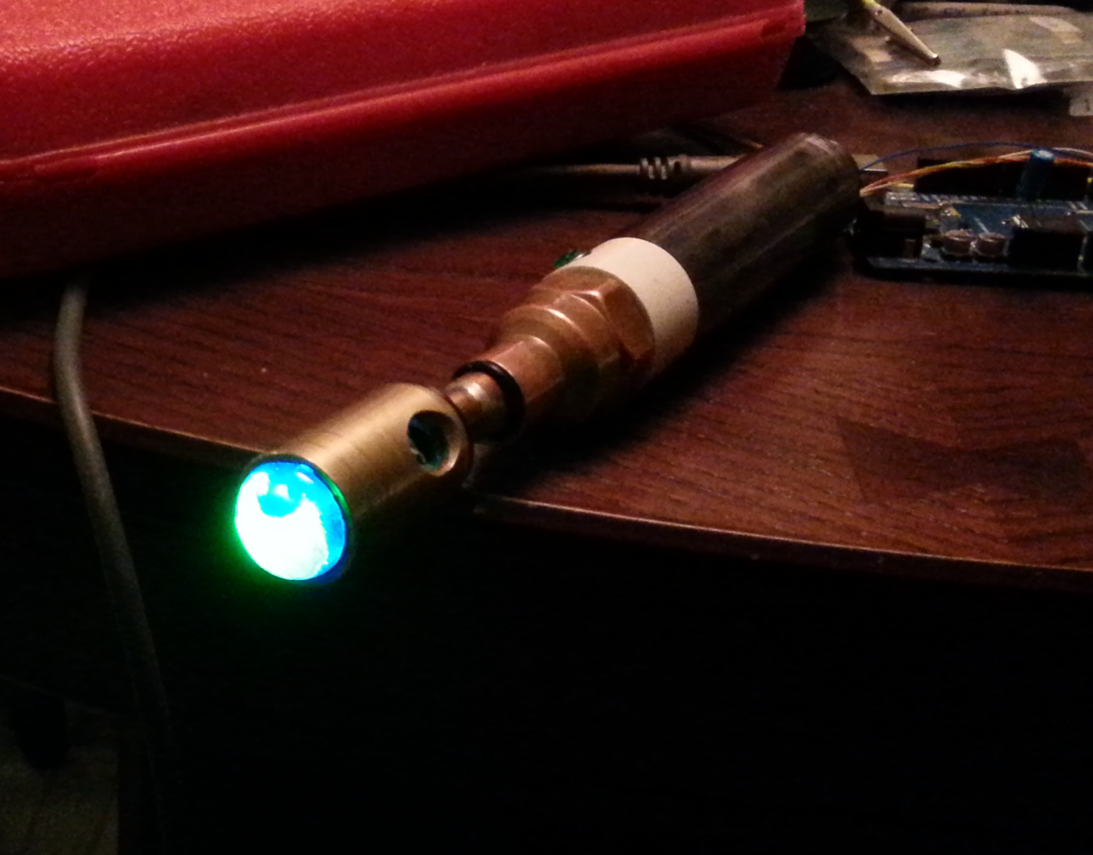

The battery compartment of this sonic consists of a piece of 4" black pipe with an aluminum sleeve around it, a brass flare nut with a battery contact soldered in (see sonic 3.0), and a piece of plastic derlin at the top with a second battery contact to isolate the positive connection. This type of battery compartment is quick and easy to build and better instructions will be included with the next sonic I post.
Step 3: The Front End
The front end of this sonic is a piece of brass tube with a floral bead epoxied on that slides through a custom cut piece of aluminum. The aluminum was cut on a lathe. Behind the marble sits a white led and an IR led to light up and turn tvs on and off.
