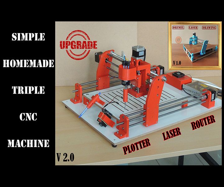

Step 1: Let's See Previous Project
Some of you will remember the CNC machine we have done before. You can check this link on instructable or above video. Watched 40 K times. We were very happy. Thanks for your all good words and wishes. We have received very nice feedback for the CNC machine that we have made from our valuable followers.
So we think what can we do like this project, maybe again you love it...
