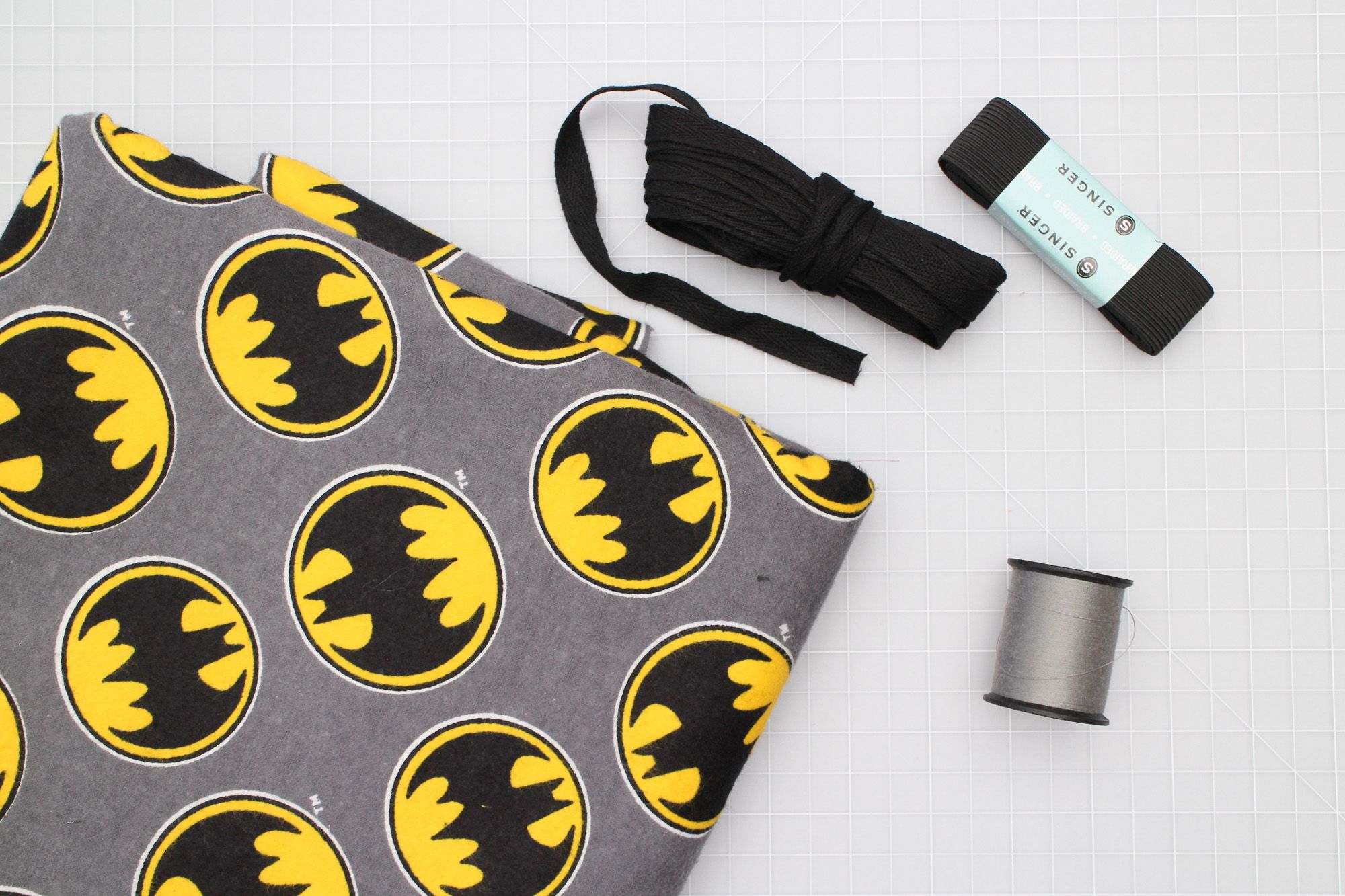

Materials:
- Fabric: 3 yards flannel, small scrap of fusible interfacing
- Materials: matching thread, Pajama Pants Pattern, 30" - 40" of ¾” wide elastic for waistband (depending on waist size), 2 yards cord, ribbon, or twill tape for drawstring

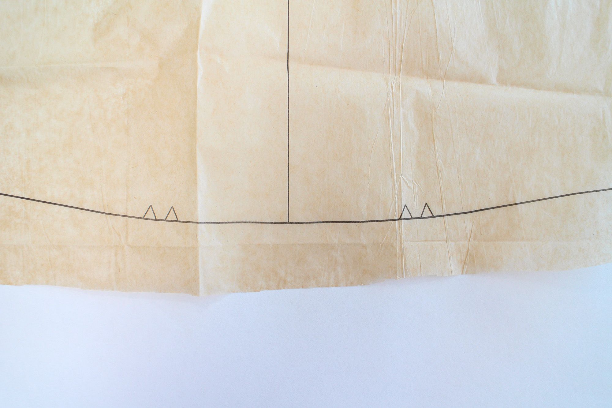

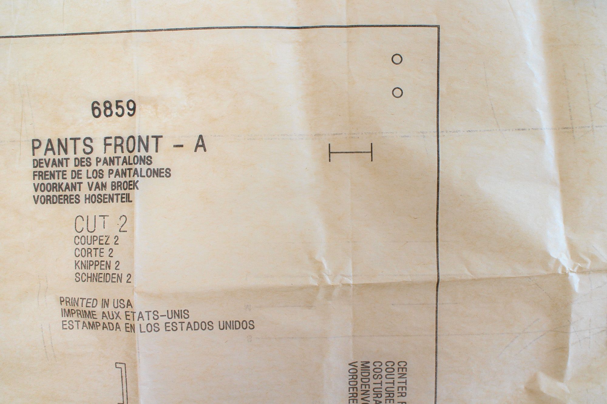

Step 4: Understanding the Pattern Itself

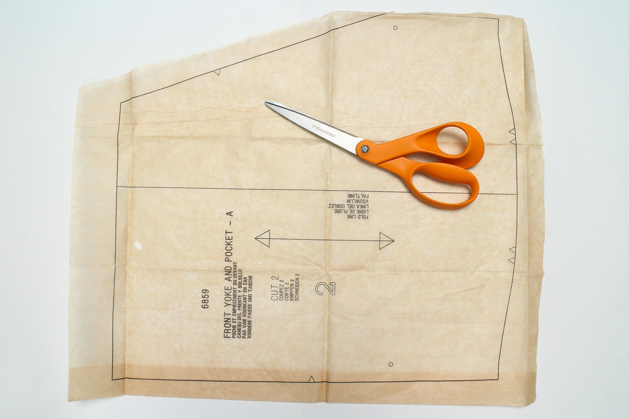

When you open up the folded pieces of tissue paper inside the pattern, you will find your pattern pieces arranged together with a lot of different markings and words printed on them. You need to decipher all this to know which pattern pieces to use and which lines to follow.
Cut Lines For Different Sizes: On a multi-size pattern, each pattern piece will have not one, but several outlines that correspond to different sizes. On this pattern each size outline is printed in a different pattern of dots and dashes to help you follow the right line all the way around the pattern. Once you have chosen a size, you will find the lines that correspond to it and cut each pattern piece out along this line.
Grainlines and Cut on Fold Lines: as we learned when we were working with the flying fox pattern, on each pattern piece you will find either a straight line with an arrow on each end, or a line with arrows at 90 degree angles on each end. The straight arrows are grain lines that show you how to orient the pattern pieces in relation to the grain. Lines with 90 degree angles are cut on fold lines
Notches: on most commercial patterns, you will find one of two types of marking that indicate where to make a notch. On this pattern notches are shown as little triangles pointing in from the cutting line. To mark the notches, you can either snip 1/4" into the seam allowance at each notch or cut a triangle past the edge of the pattern, pointing out away from the sewing line. Notches are there to help you align pieces properly with each other and and know which two piece go together. Some seams will be marked with single notches, and some with double notches. Match double notches to double notches and single notches to single notches.
Buttons and Buttonholes: on this pattern, there are 6 buttonholes that will be used to insert drawstring cords. These are marked like you marked the buttonholes you created in the last lesson, with a line with a T on each end. Mark these with a tracing wheel and transfer paper.

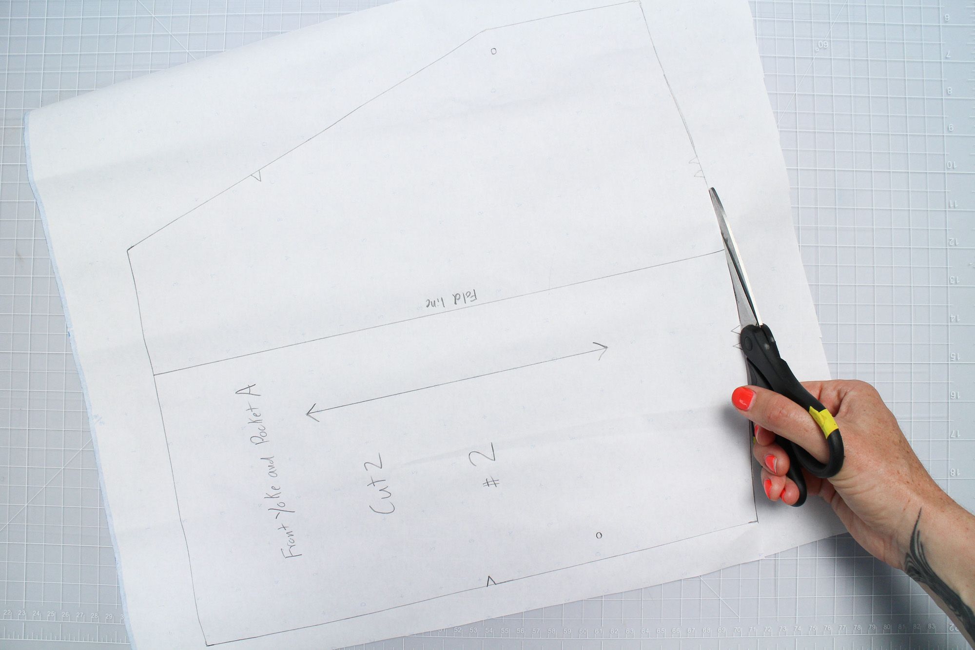

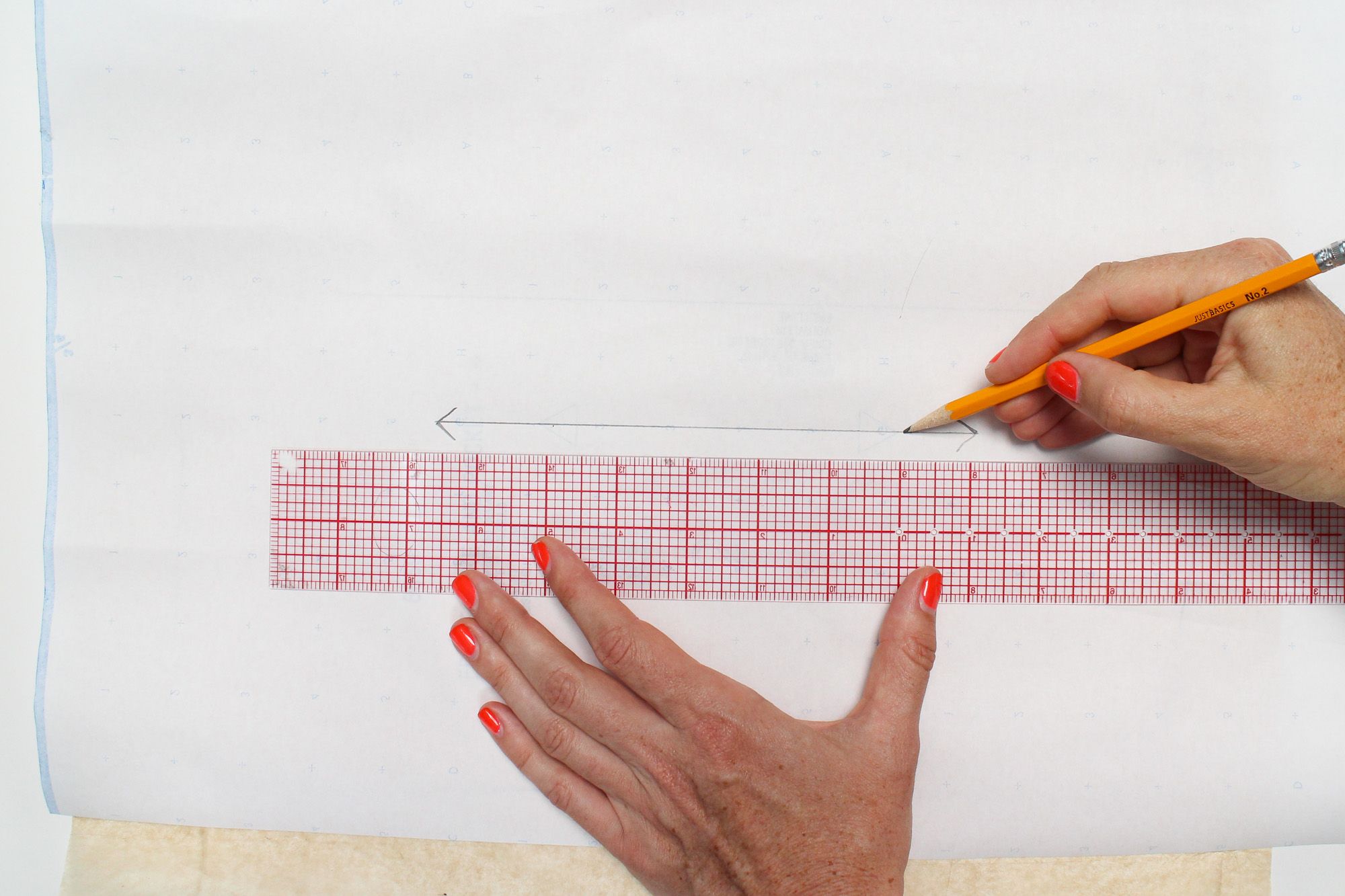

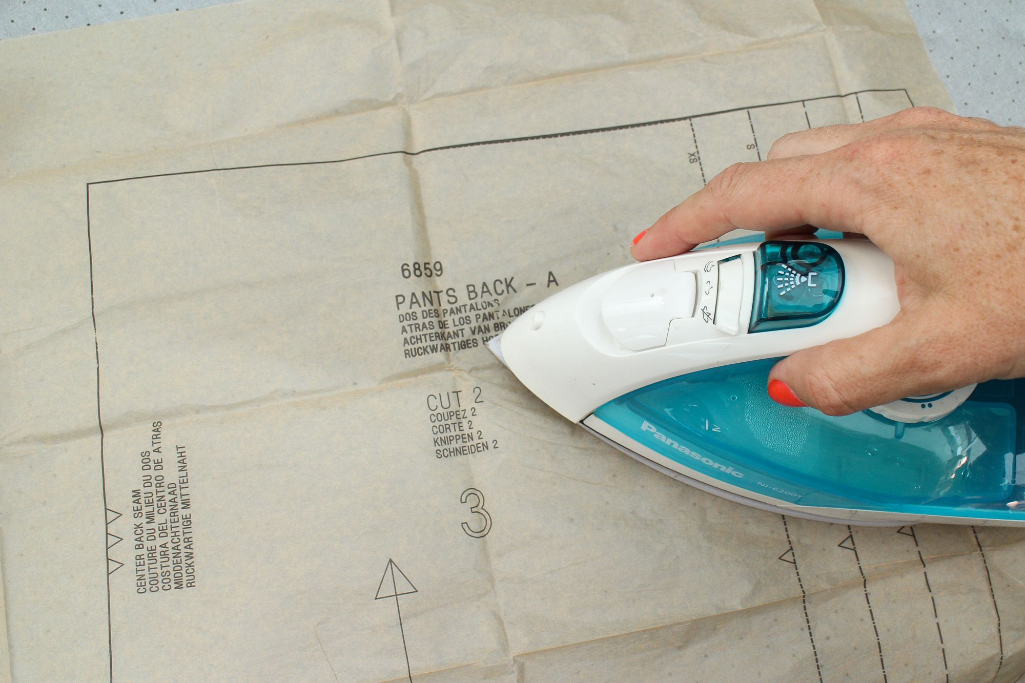

Step 5: Tracing the Pattern
The problem with patterns that are printed on tissue paper like this, is that it's hard to use them more than once. Also, if you wanted to make the same pattern in different sizes, cutting one size out of the tissue paper will prevent you from cutting another size. For this reason, it can be a good idea to trace the pattern onto sturdier paper.
Before you start tracing you can cut roughly around each pattern piece you need, to separate them from the rest of the tissue paper, or just keep the whole sheet intact. Iron the tissue patterns flat with your iron on a low, no steam setting.
There are a few different ways to trace patterns, but the method I prefer is to lay blank white pattern paper over the printed pattern and just trace the markings through with a pencil and a ruler. I think it also helps to have something white underneath the printed pattern because it makes the lines stand out more clearly.
If you aren't working on a white table, you can put sheets of white paper under the pattern. Put your pattern paper over the top, and pin it to the pattern in a few places, or weigh it down with a few weights or heavy objects. Pattern paper is a bit translucent for this exact purpose, so you should be able to see the lines of the pattern through the paper. If you find the lines too difficult to see, you can try using actual tracing paper, or tracing your pattern over a lightbox or even a window.
Choose the size you're going to make, and only trace off the lines that correspond to that pattern. I find it easier and more accurate to just mark important points, like corners and then use a ruler or a hip curve to fill in the lines between the marks.
In addition to the cut lines of the pattern, mark any other important information, like notches, buttonholes, grainlines and the pattern label and cutting instructions.
When you are done tracing, cut each of your pattern pieces out along the cutting lines.

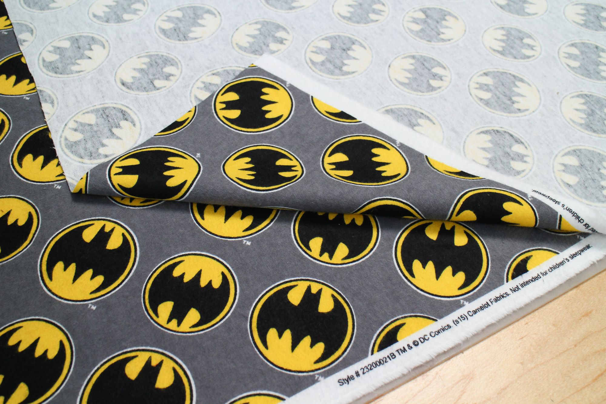

Step 6: Cut Your Fabric
Now, finally, you are ready to start making these pajama pants!

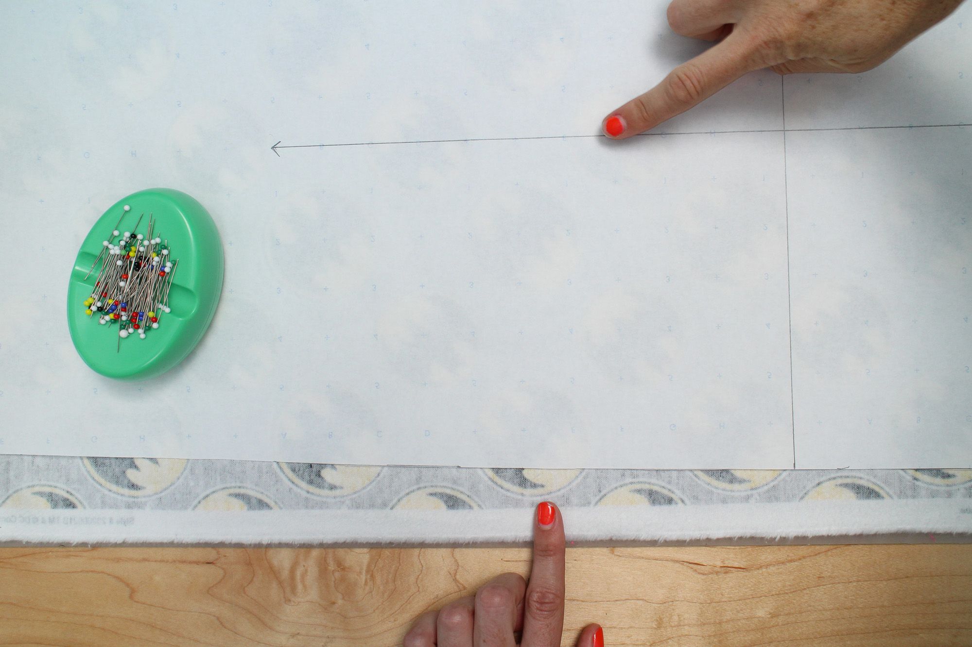

Lay your fabric out on your cutting table, refer to the pattern instructions to see suggested cutting layouts for different widths of fabric. I folded my fabric over on top of itself, right sides together, lining up the selvages, then arranged my three pattern pieces on the fabric.
To make sure the grainlines of the patterns are parallel to the grain of the fabric, use a ruler to measure in from the selvage to the grainline, making sure it is an even distance away all along the line.
Pin the pattern down in a few places, near the edges.

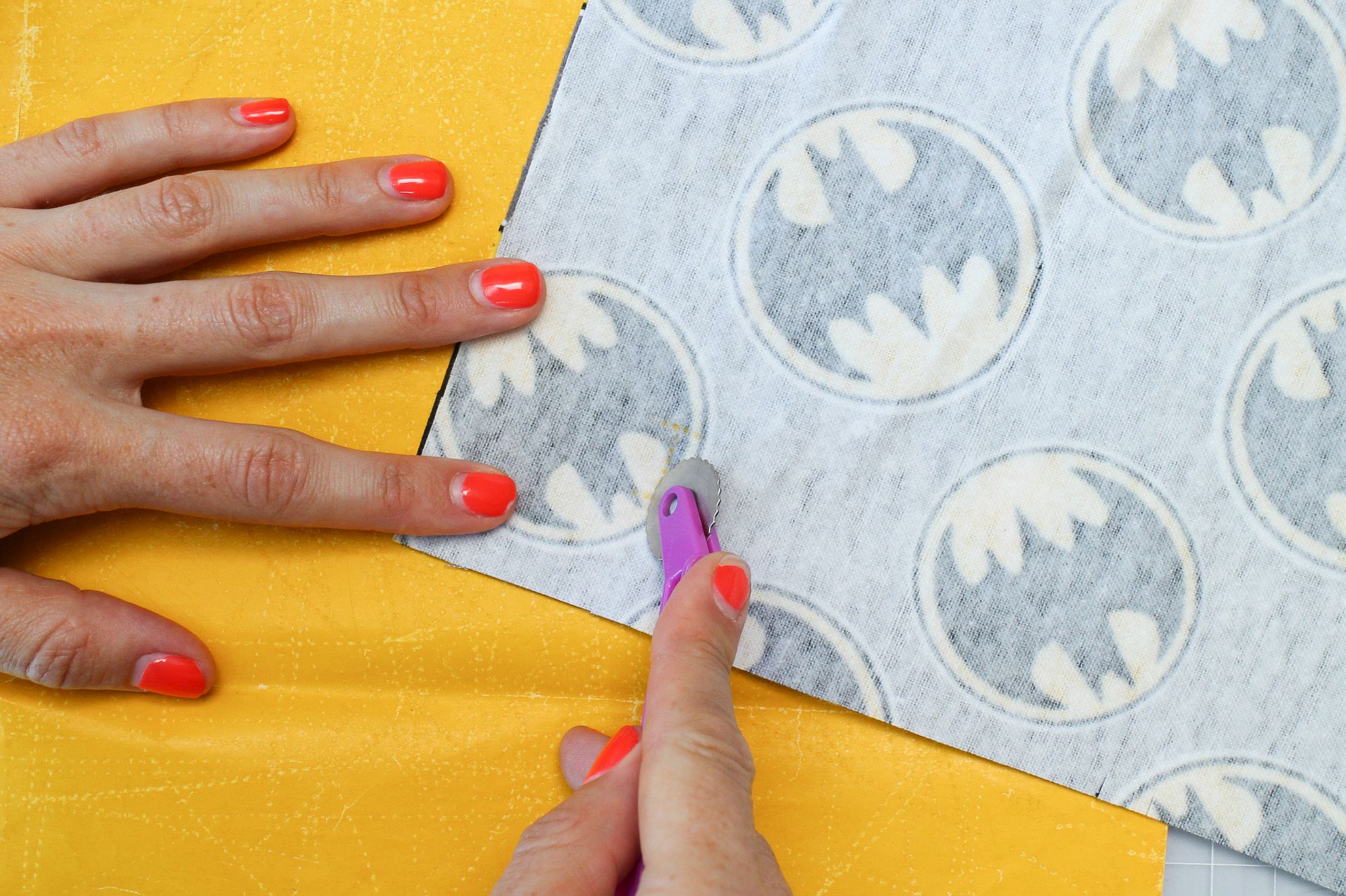

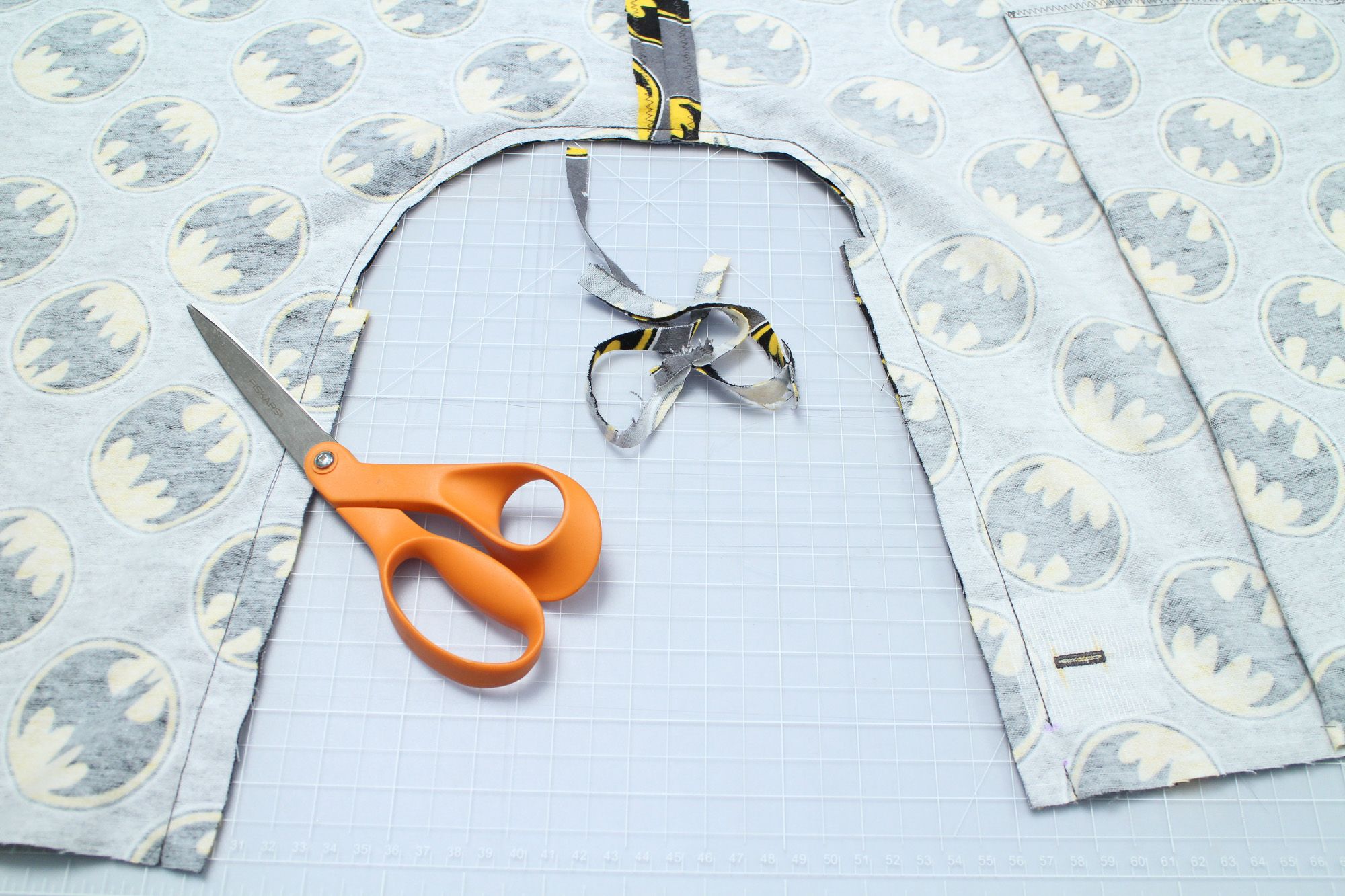

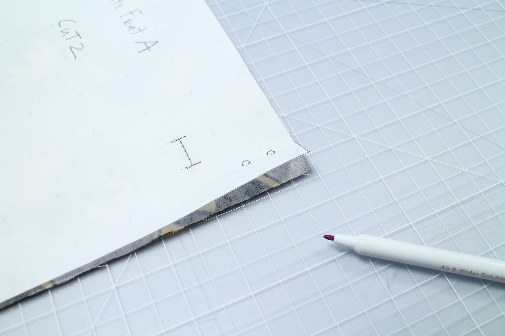

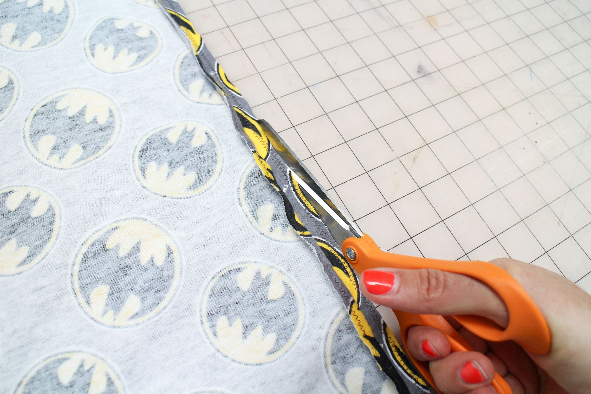

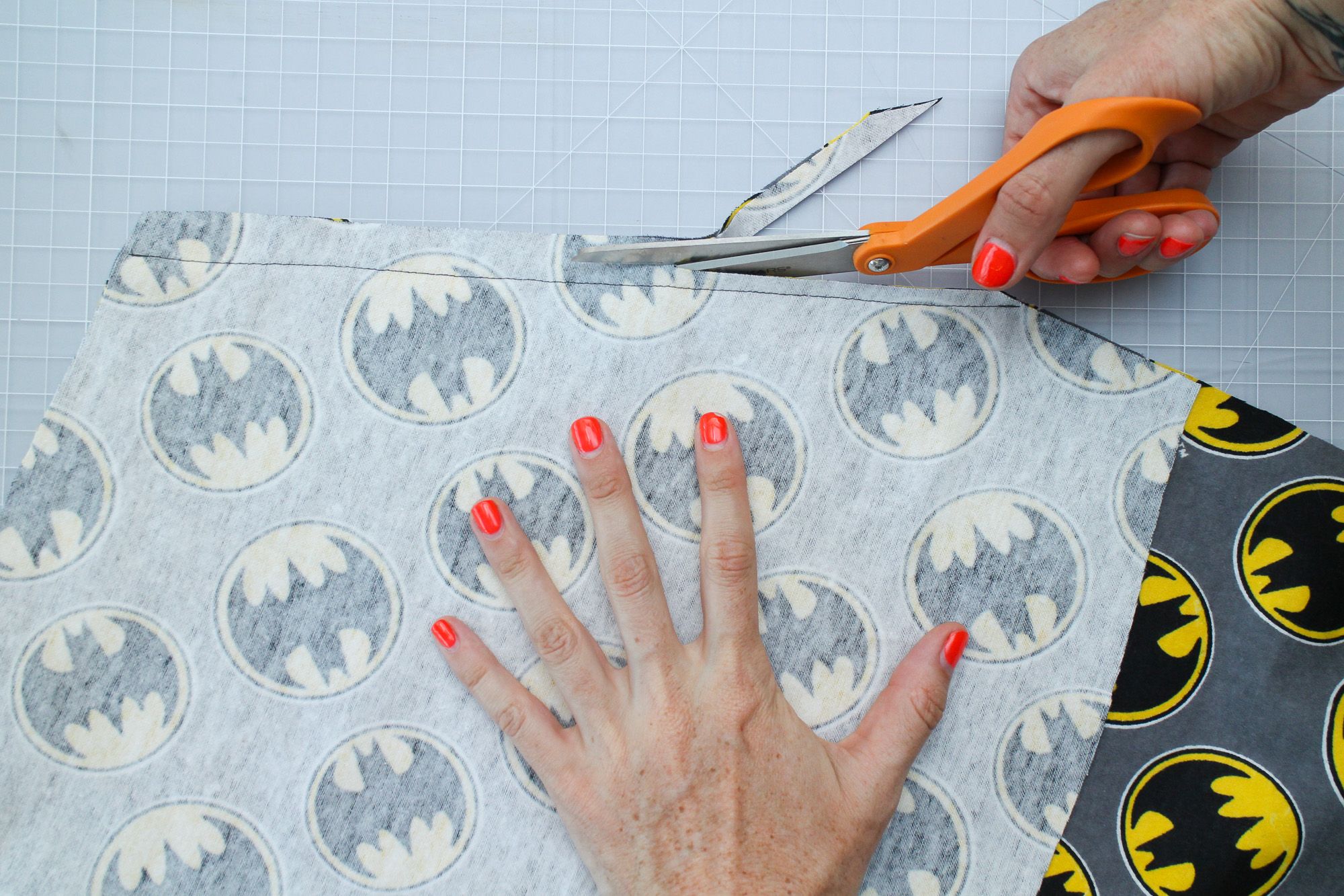

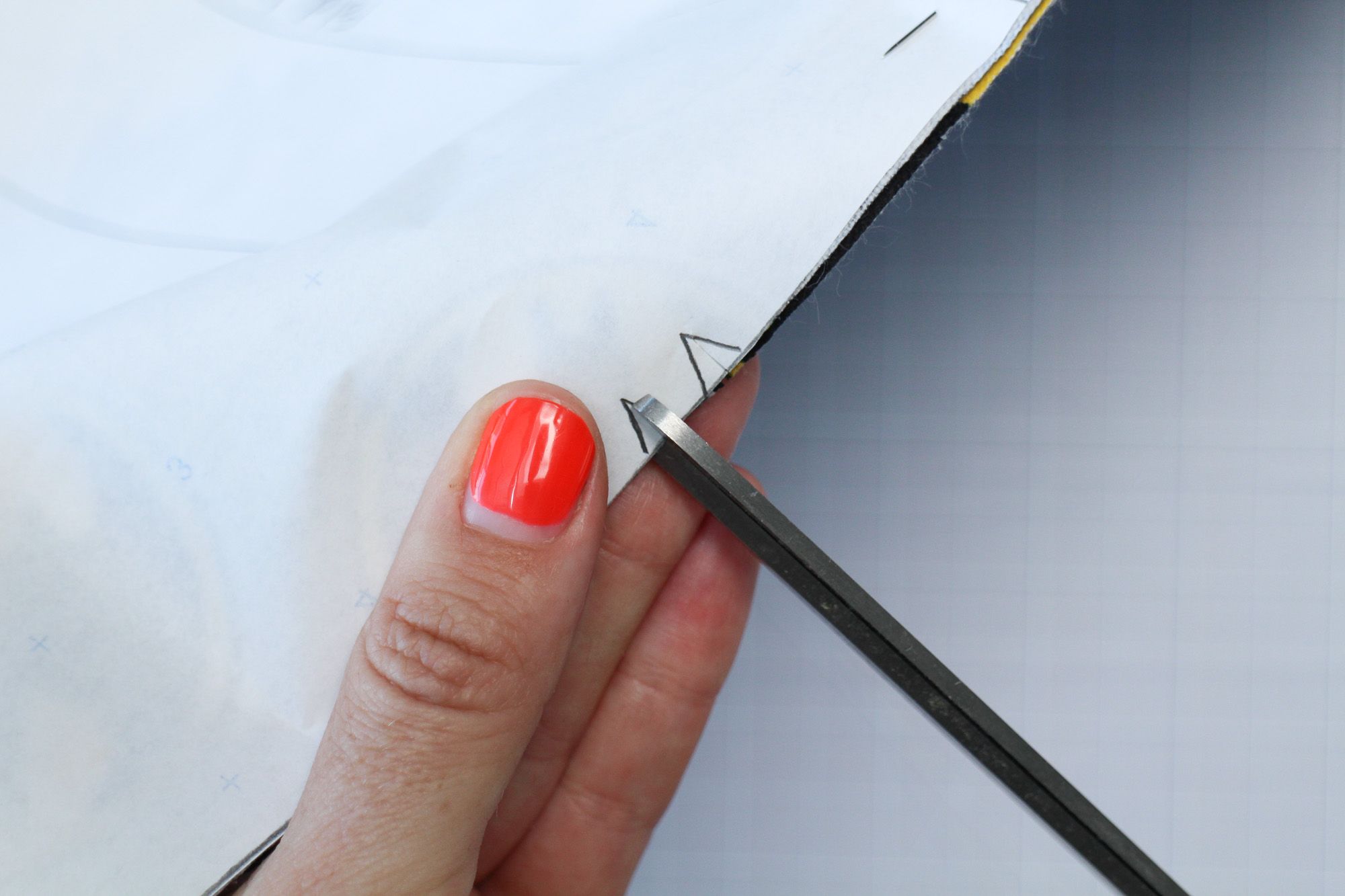

Then cut out each piece with your scissors, exactly along the edge of the paper. Keep your scissors resting on the table as you cut and use long even strokes. It can really help to move yourself around the table as you cut so you can get the right angle.

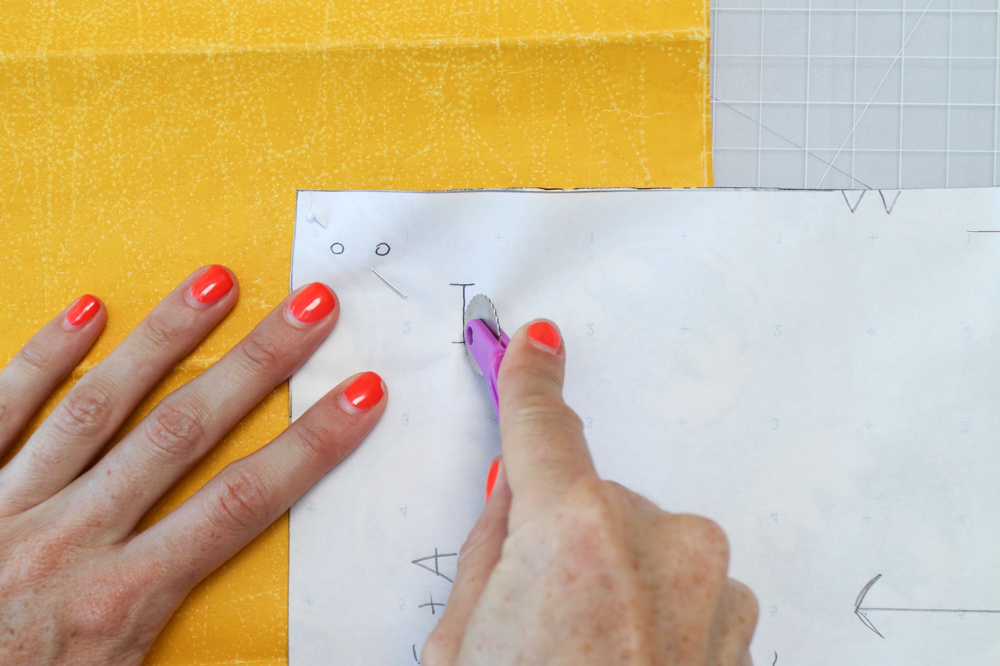

When you have the pattern cut out, snip the notches, and mark the buttonhole placement with a tracing wheel and transfer paper.

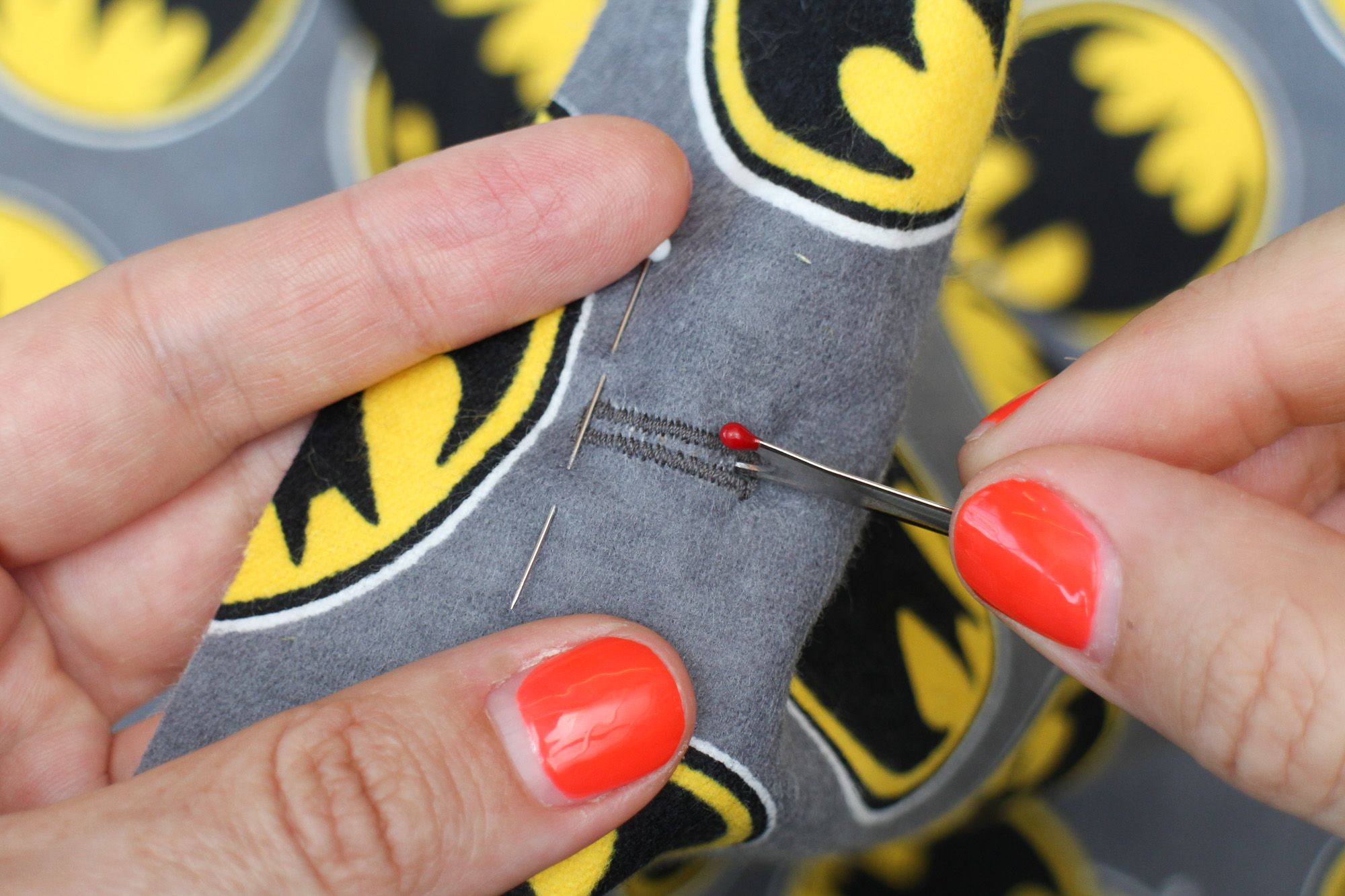

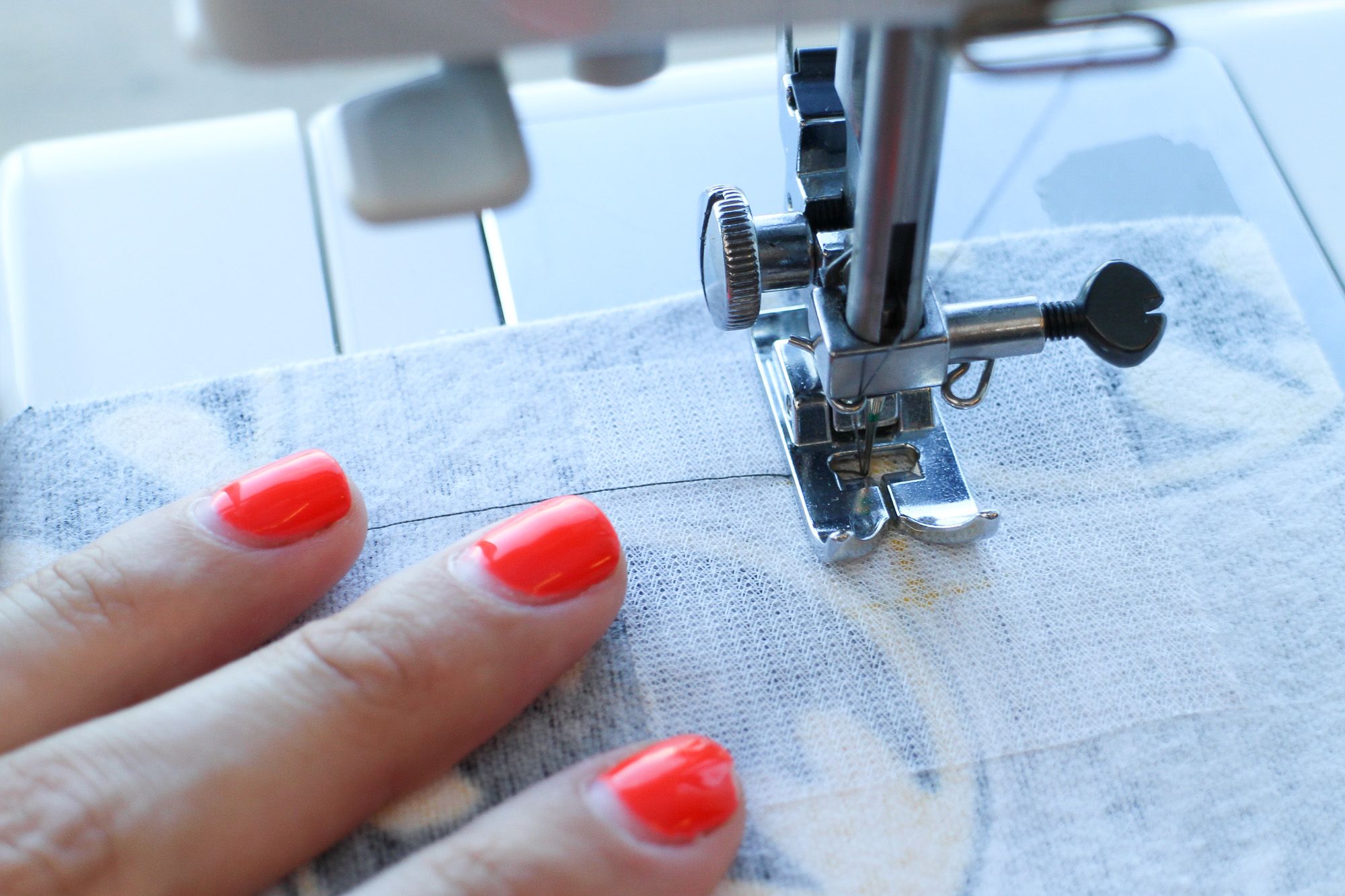

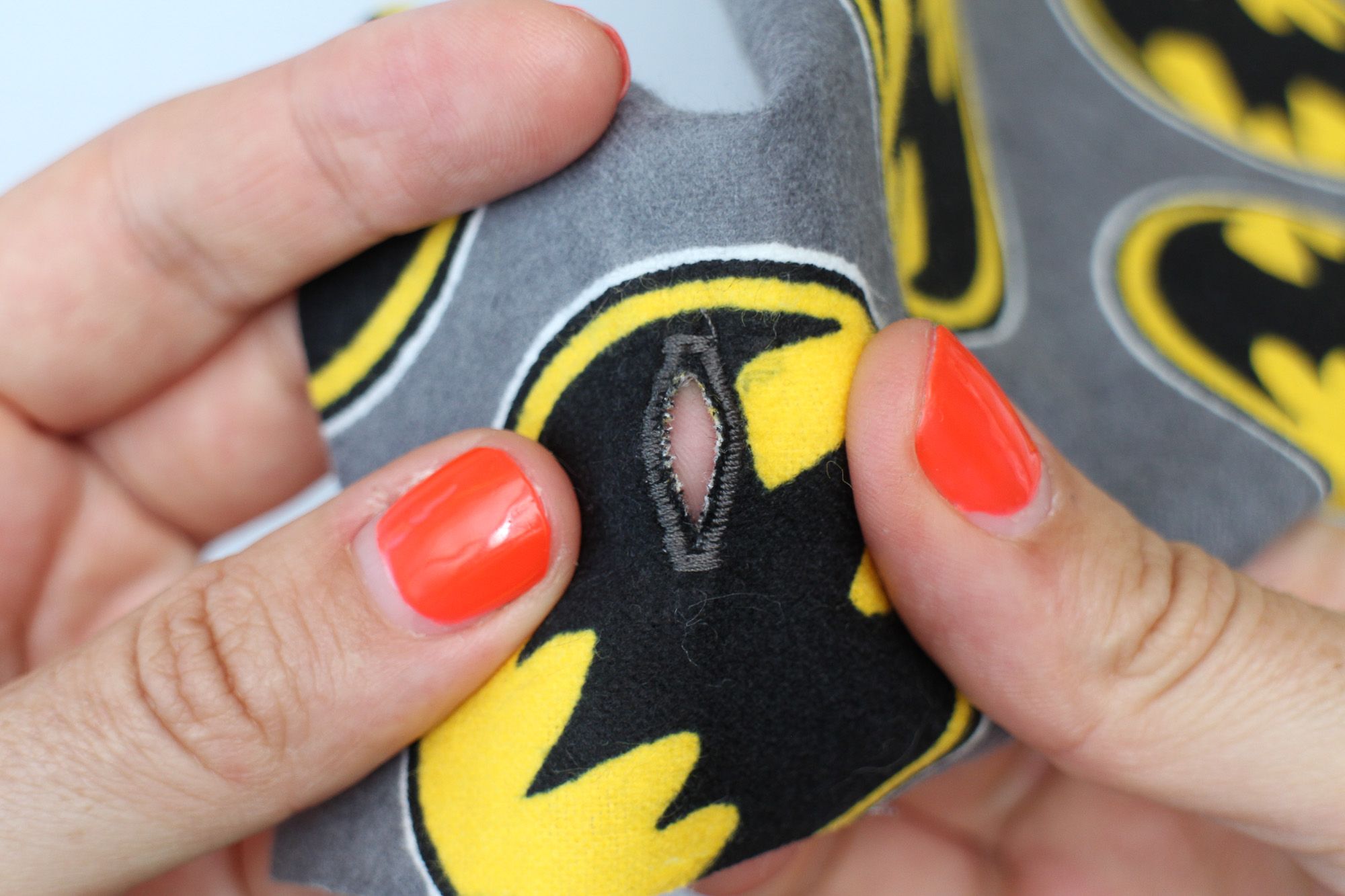

Step 7: Make Buttonholes

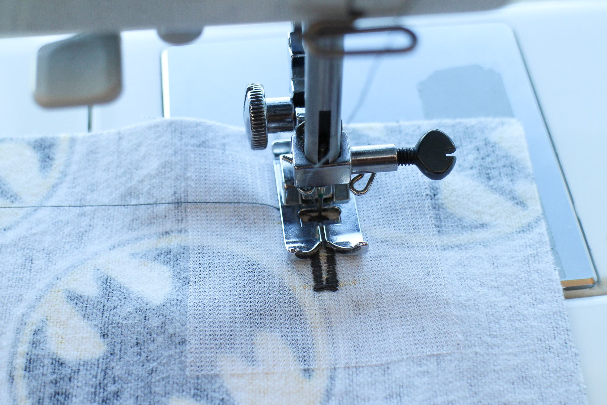

Before we start sewing our fabric together, we need to make the buttonholes on the ankles and waist of the pants.

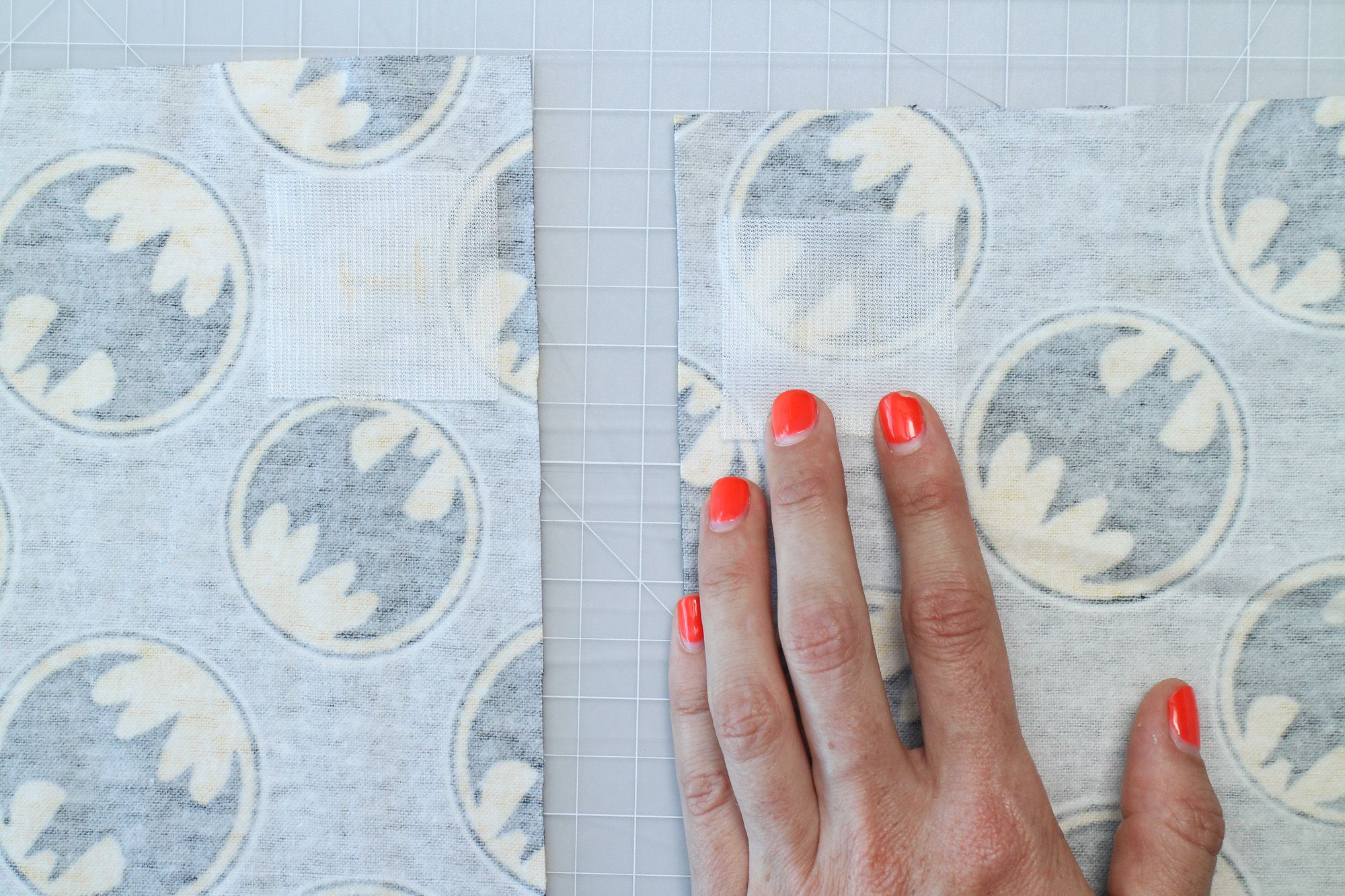

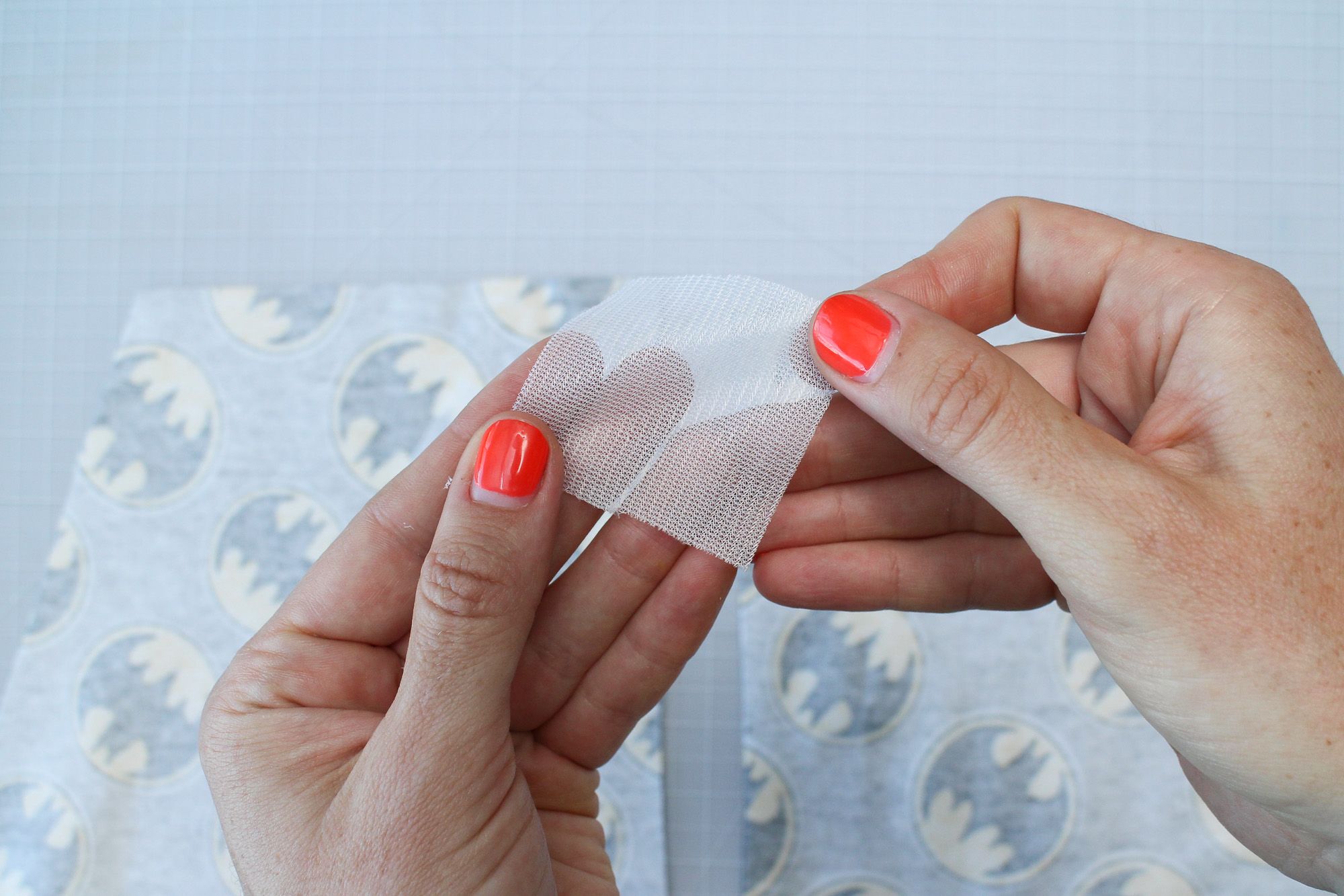

You marked the buttonholes onto one copy of each pattern piece with your tracing wheel, now remove the paper from the pattern and trace the mark through to the other layer of fabric.
Just like we did when we made out buttonhole, we are going to reenforce the fabric here with some fusible interfacing. Cut 6 squares of interfacing about 2" x 2" and fuse them over the buttonhole marks. If you use white fusible, you should still be able to see the mark through the fusible, or you can use the pattern to mark it again.

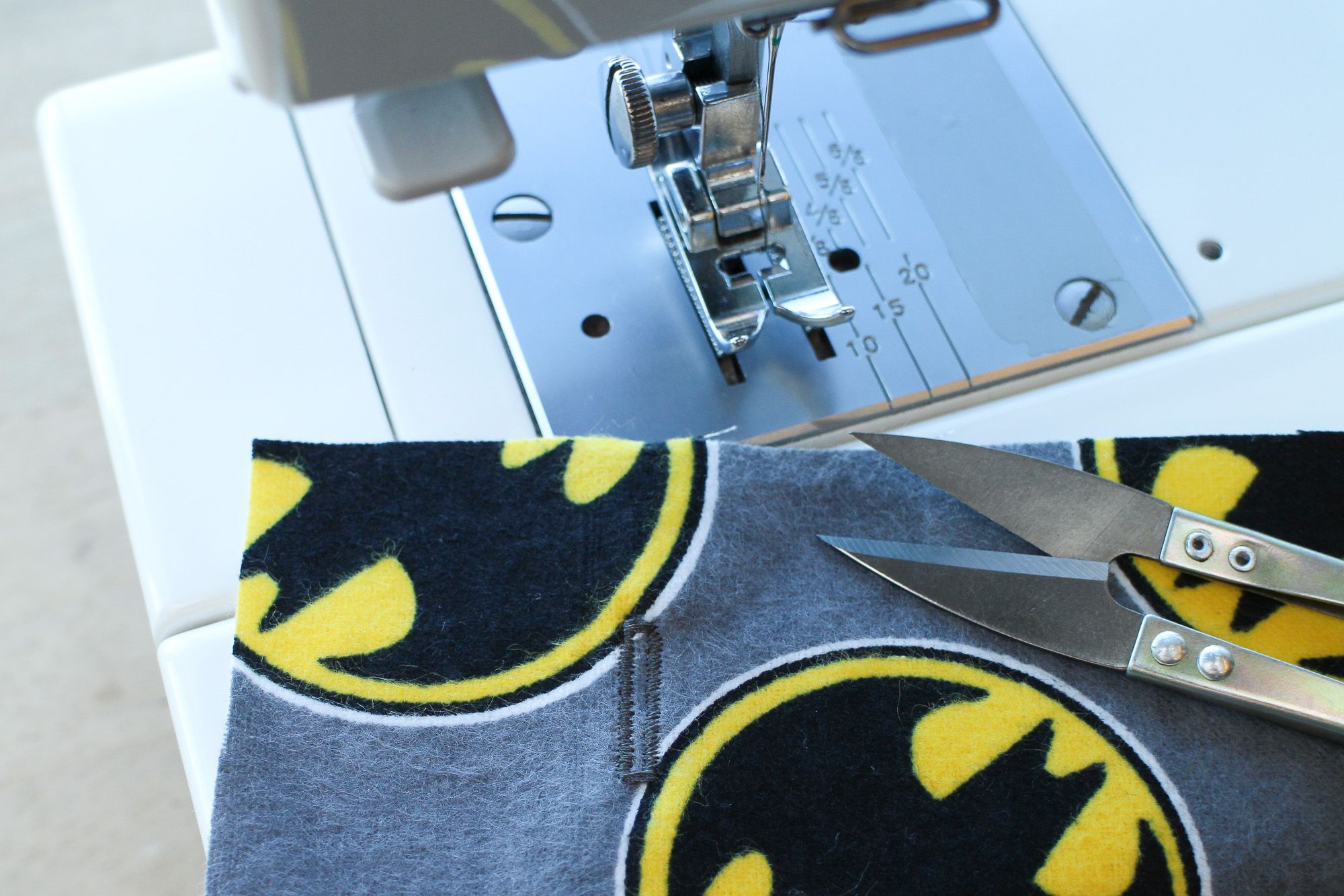

Use the buttonhole function on your machine to create buttonholes in all 6 locations on the pattern.
When you're done, use your seam ripper to cut open the buttonholes, making sure to put pins in each end first so you don't cut the stitches.

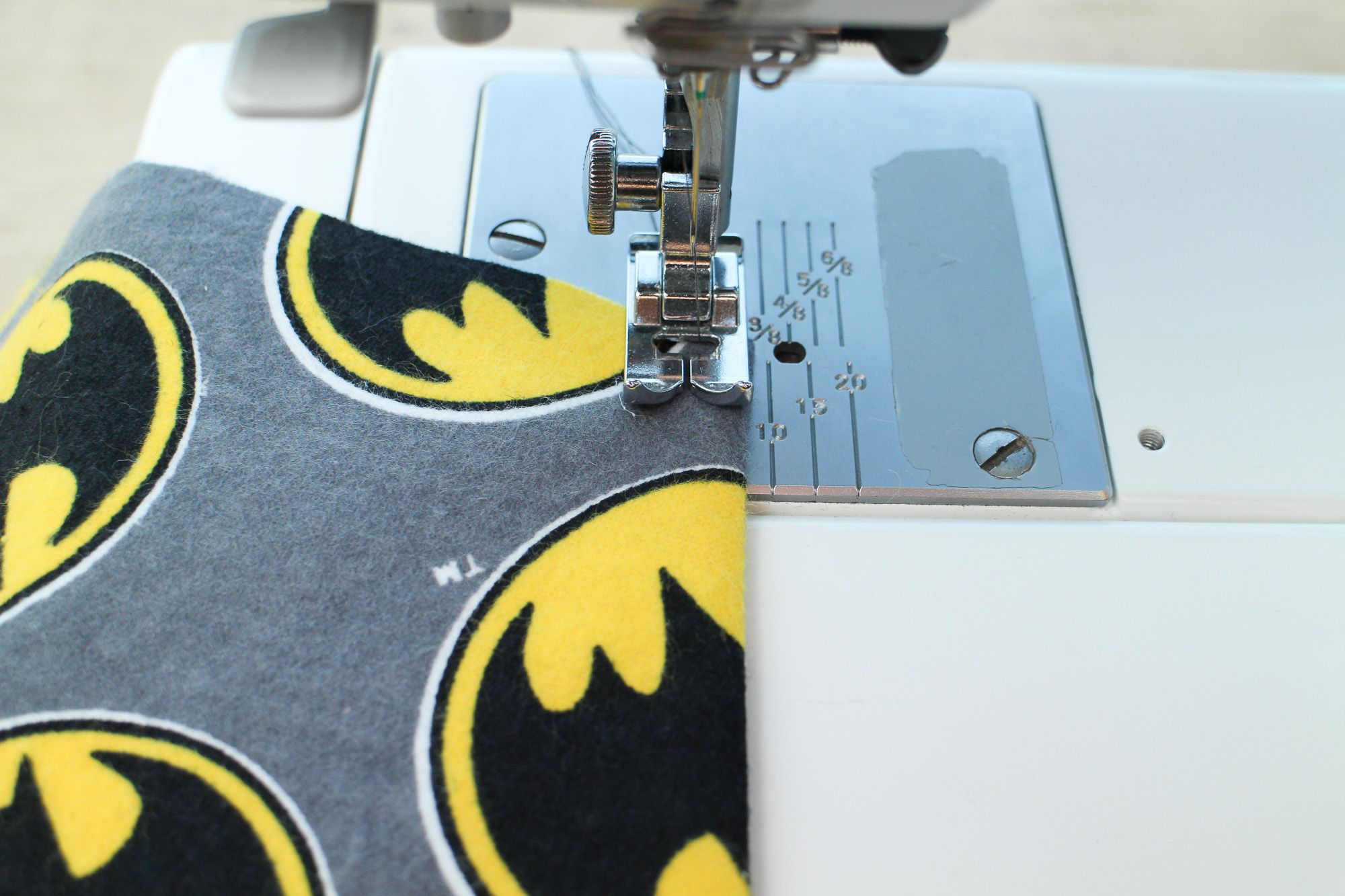

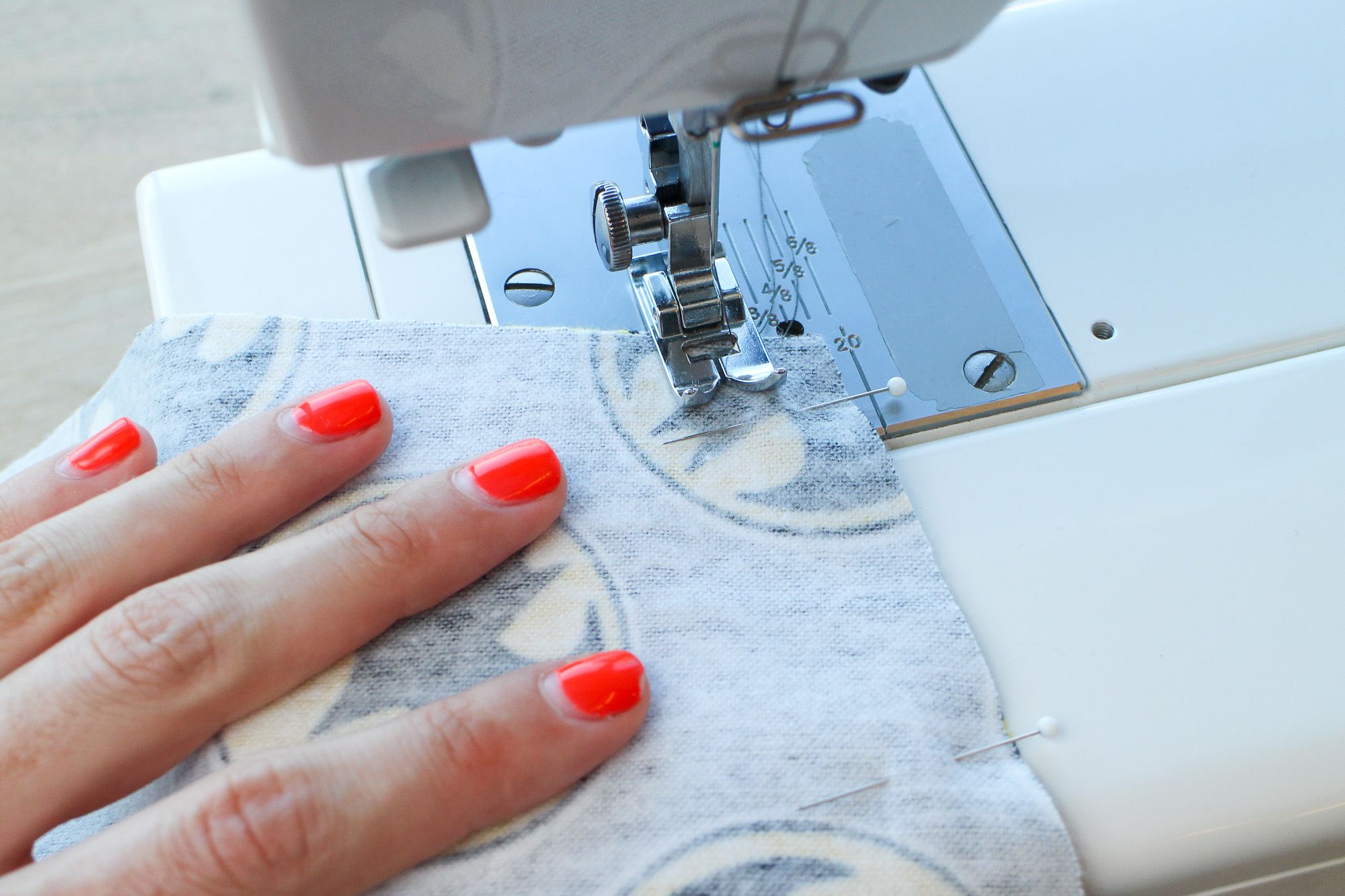

Step 8: Sew the Pockets to the Front Leg

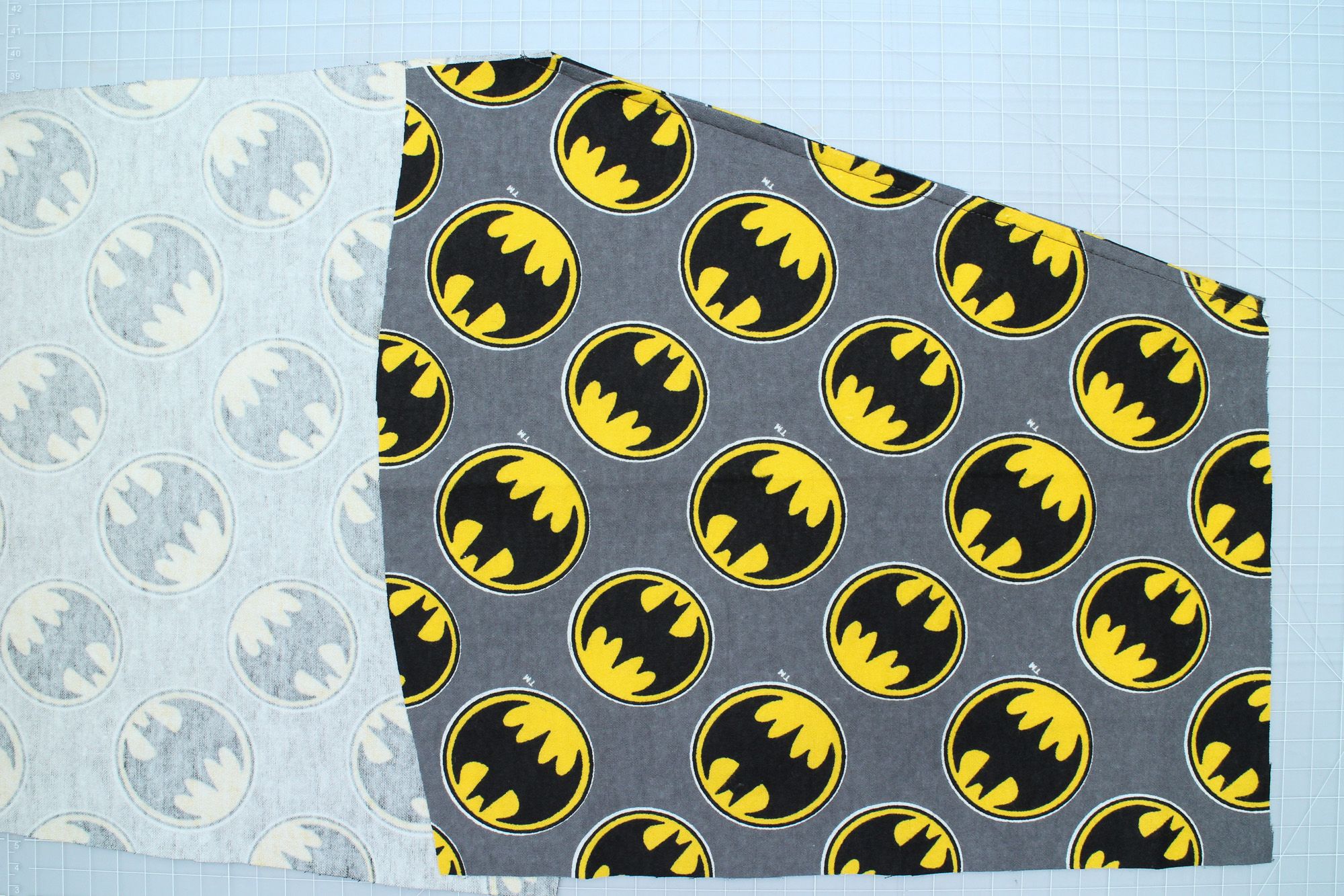

Now we are going to attach the pocket to the front leg, to do this, lay the pocket on top of the leg with the right sides together, match up the angled edges and pin them together.
With your machine set to a straight stitch and a length of about 2.5, sew these two pieces together with a 5/8" seam allowance.
Step 9: Press and Topstitch

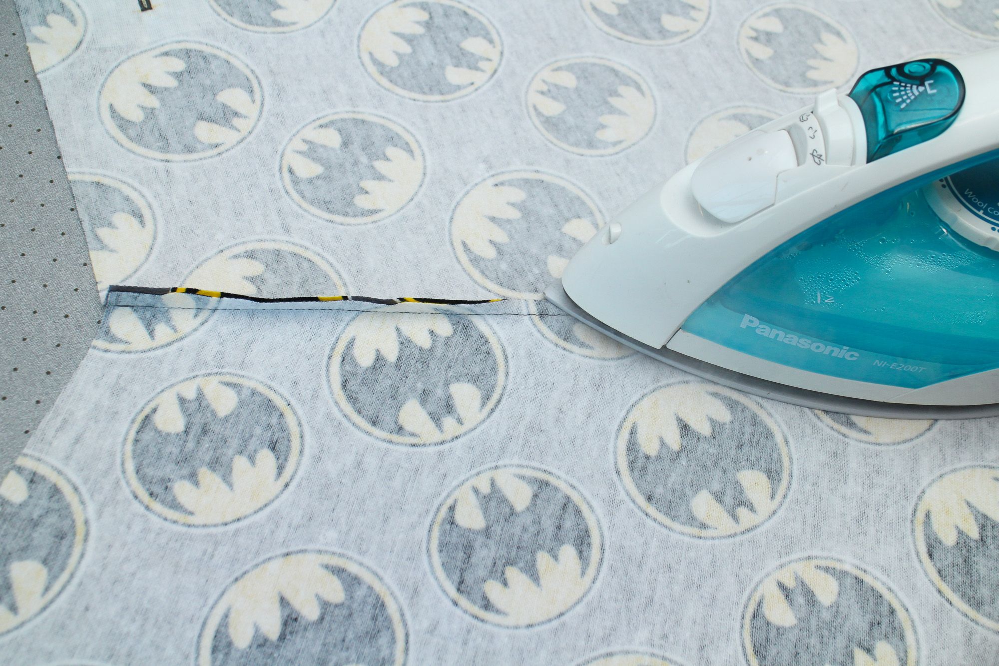

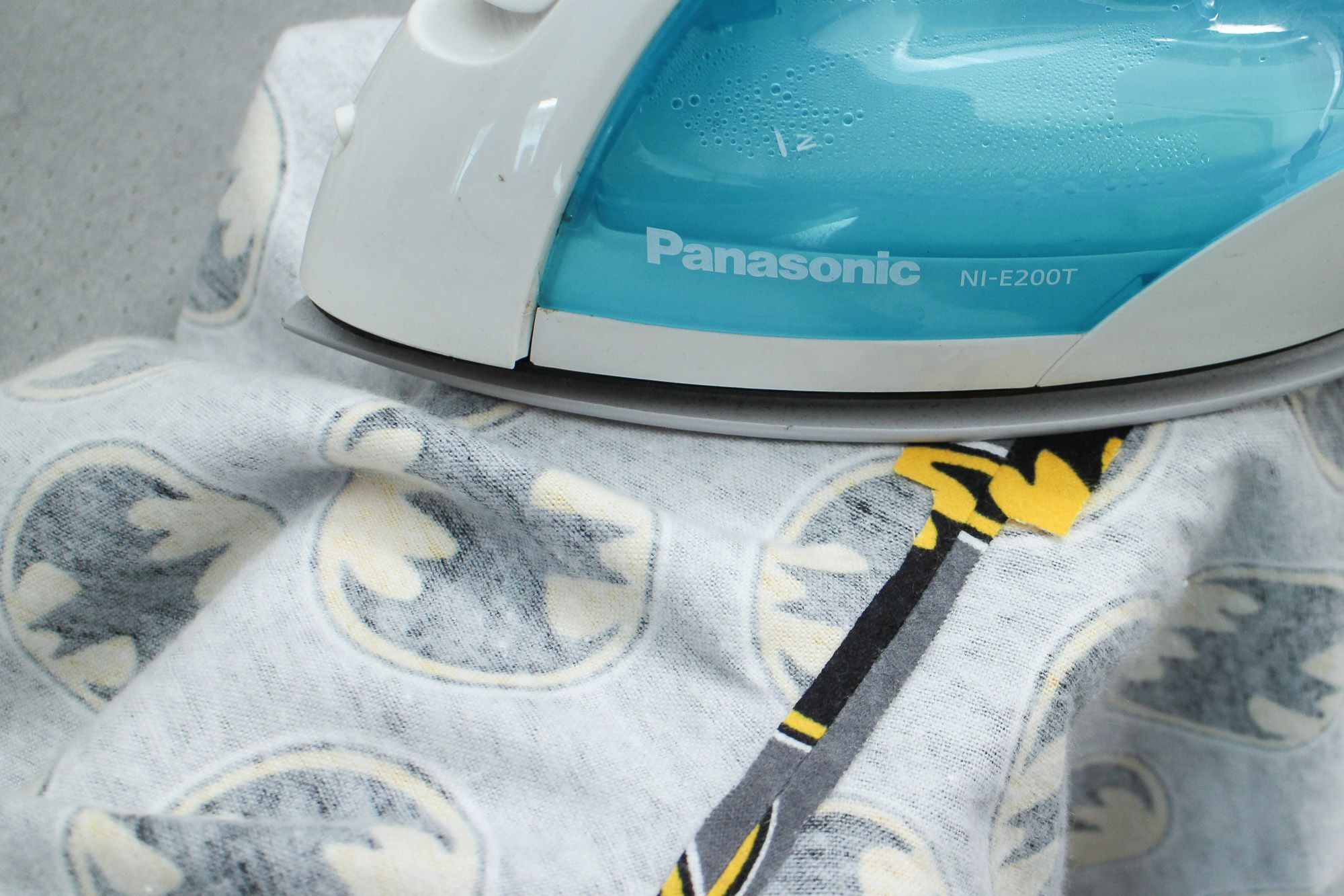

Now trim these seam allowances down to 1/4", open them up and press the seam allowance over toward the pants leg.
Fold the pocket portion over, so the right side is facing out, and then press the folded edge flat along the seam.
With your stitch length set to about 3, topstitch 1/4" in from the edge of the fold on each side.

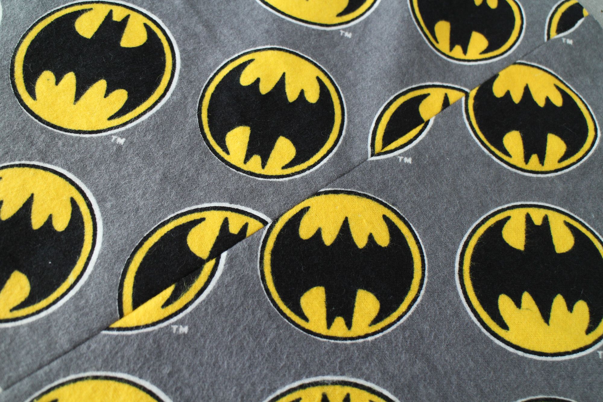

Step 10: Fold and Sew the Pockets

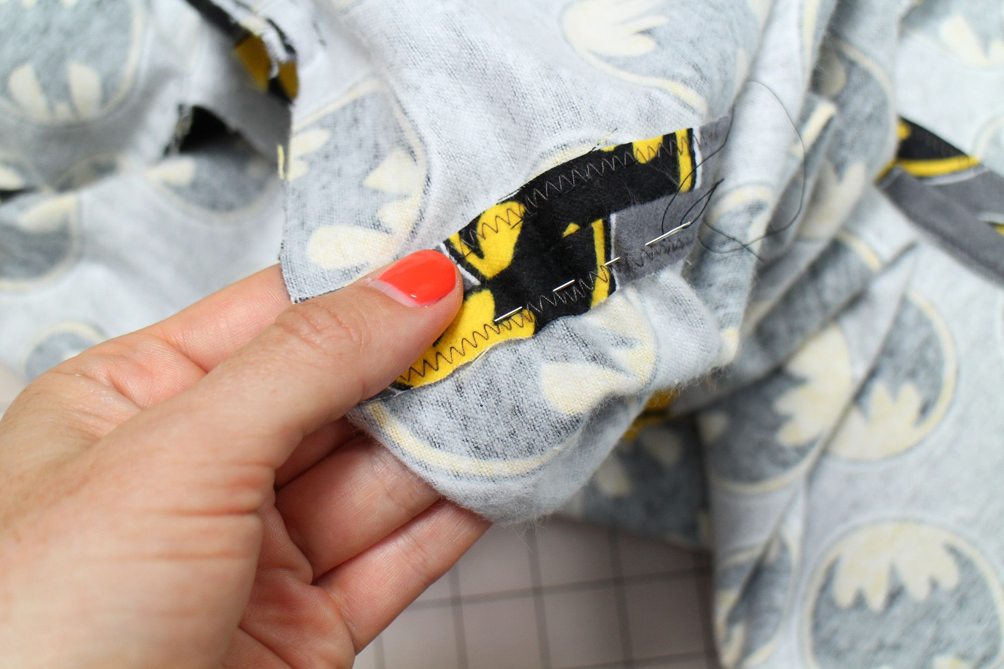

Now fold each pocket in half so that the folded half of the pocket fills in the triangle cut out of the top corner of the pant leg.
Match the two notches on the bottom of the pocket to know where to make the fold.
Pin the bottom edge.
Sew the bottom edge of each pocket seam on the machine with the same 5/8" seam allowance.
Finish the seam with zigzag and trim the seam allowance.

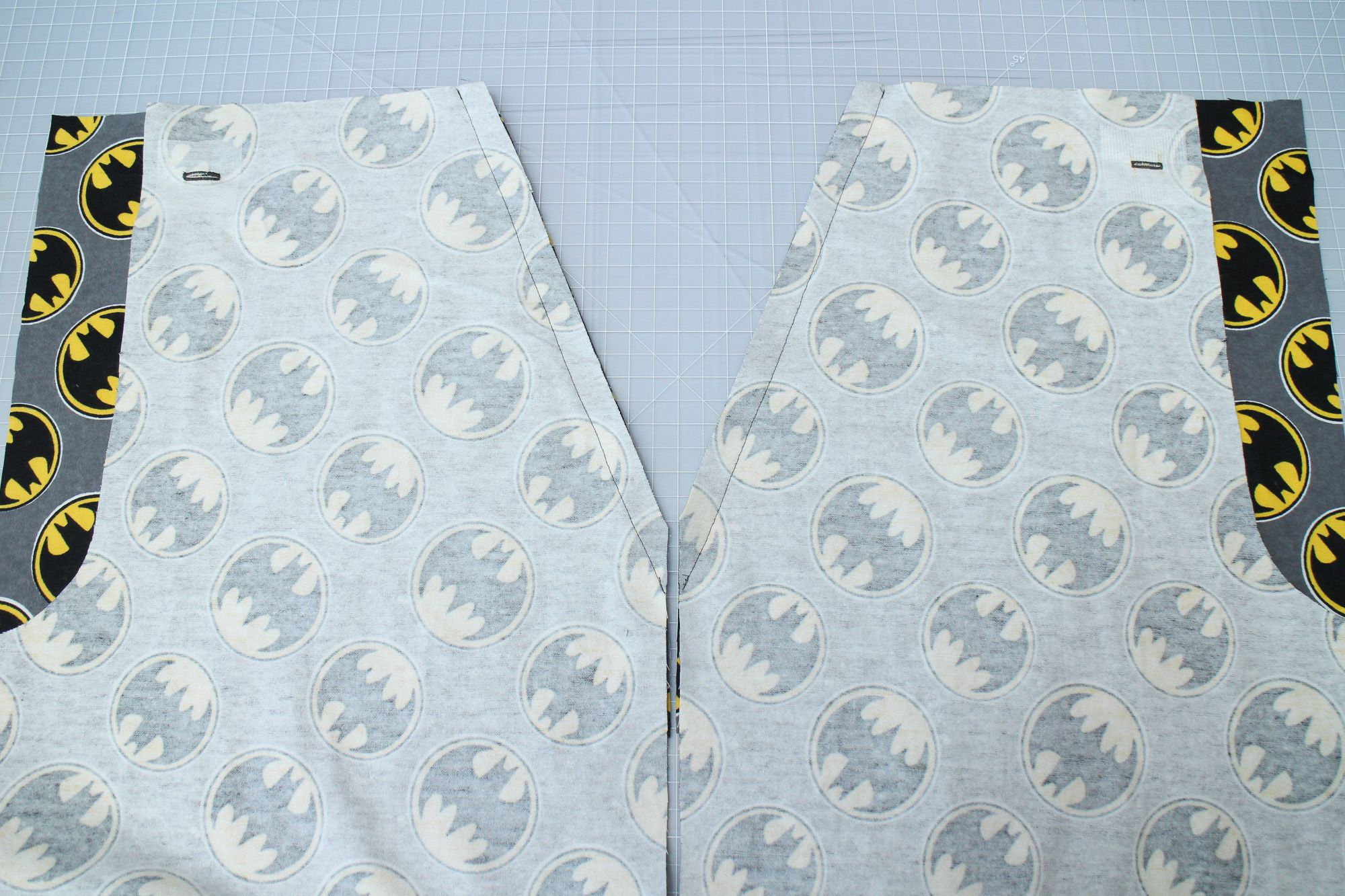

Step 11: Baste Pockets
Now baste the pockets to the pant legs at the base of the pocket opening and across the fold at the waistband.
This will hold the layers together as we sew the front leg to the back leg and create the waist casing.

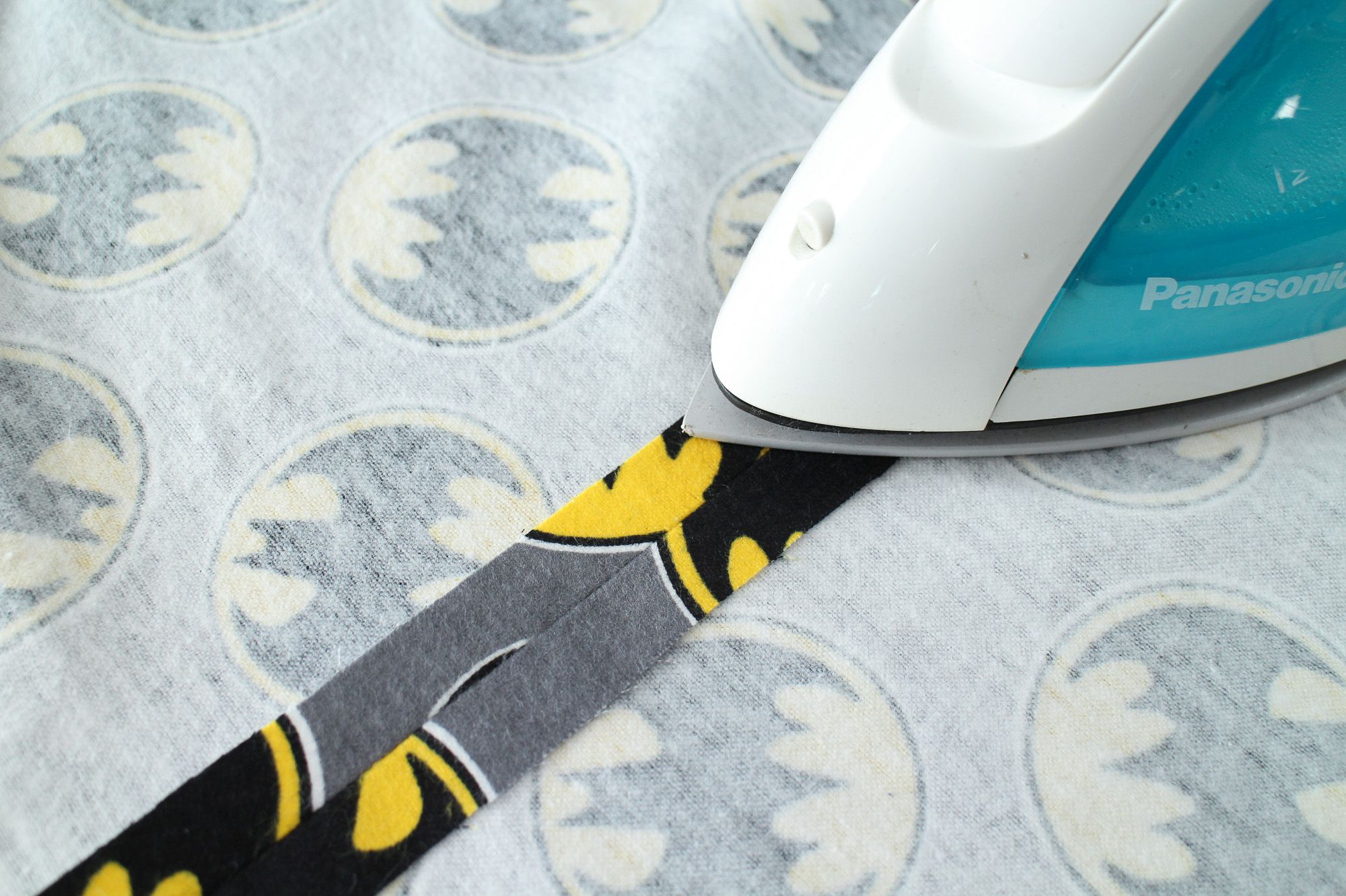

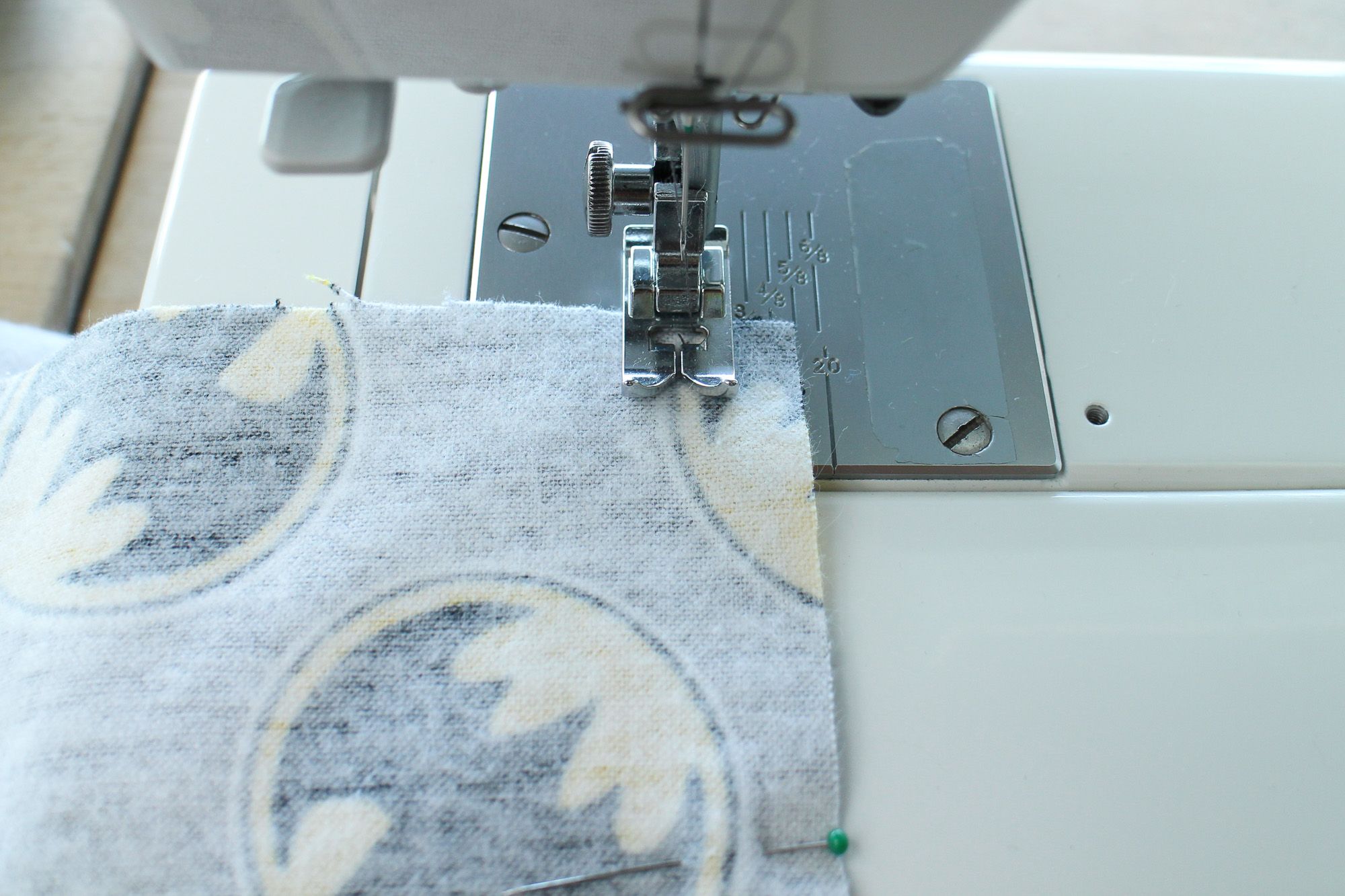

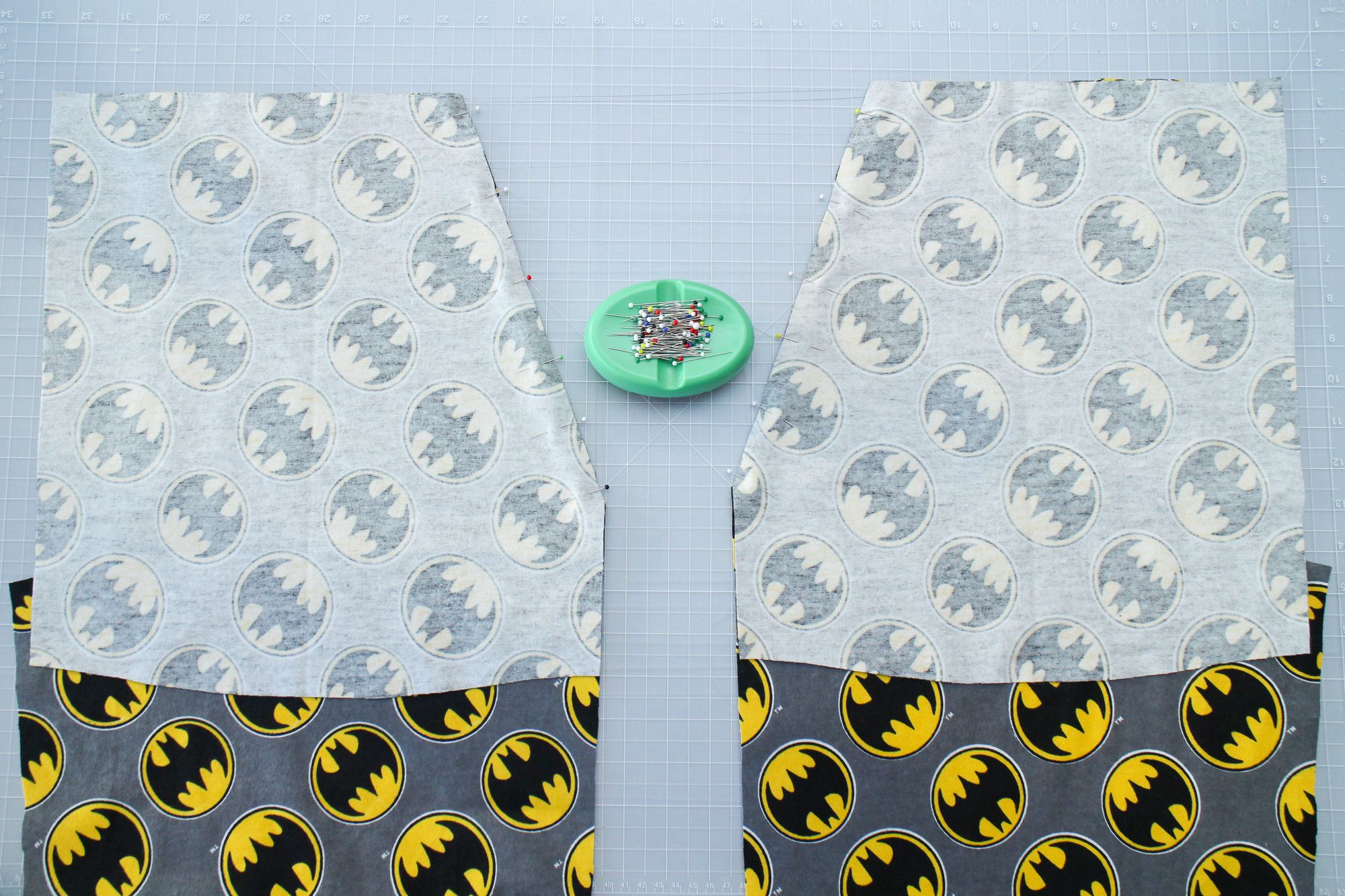

Step 12: Sew the Inseams

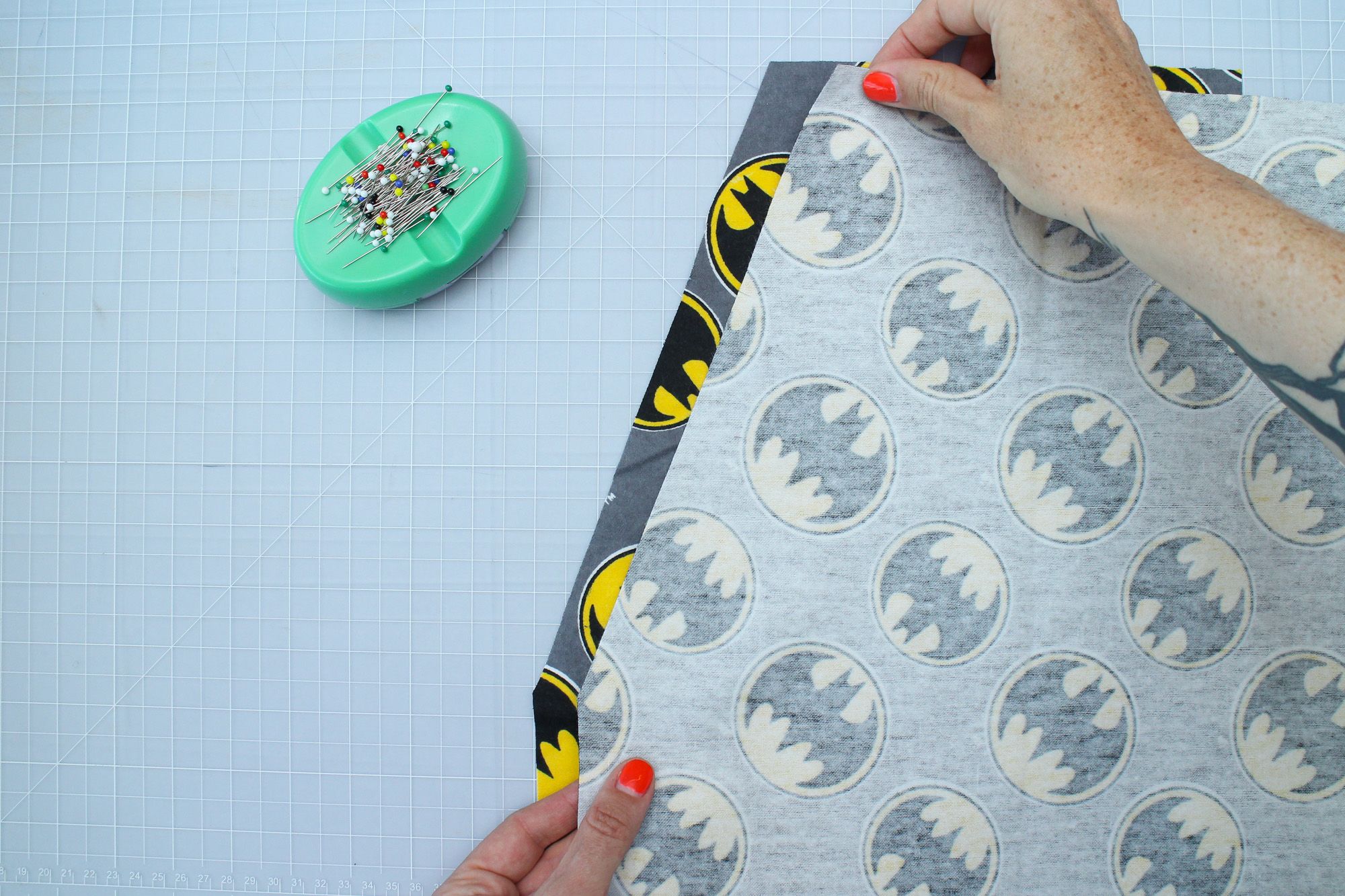

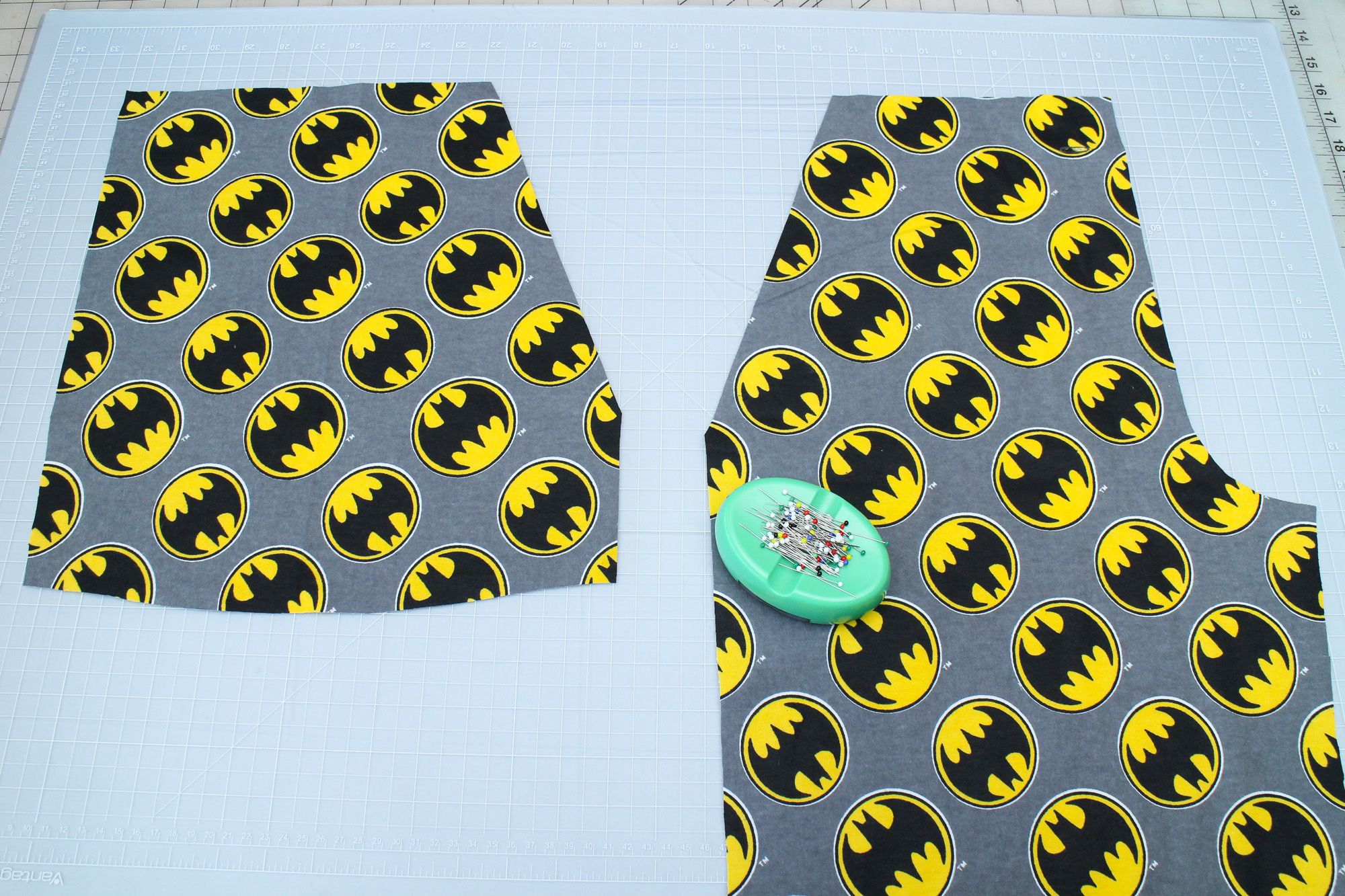

Now take the back pant legs and lay each one over a front leg, with right sides together.
Pin the two layers together along the inseam and sew them with a 5/8" seam allowance.
Press the seams open with your iron.
Finish the seams with a seam finishing technique of your choice. Your pattern may have something to say about this as well. Mine suggested either a zigzag finish or a single fold hem style seam finish. I sent with a zigzag.

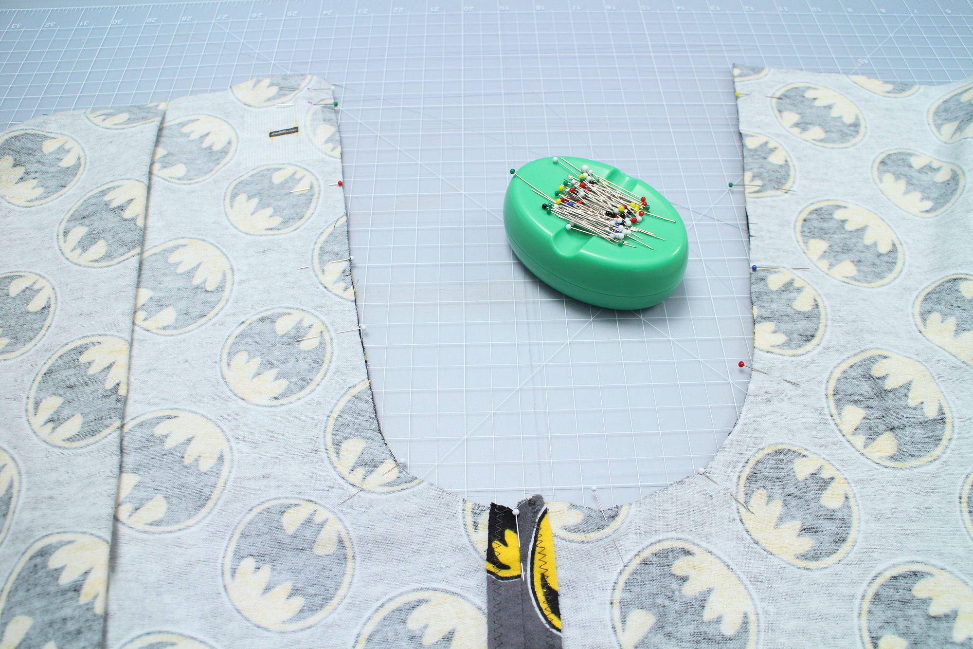

Step 13: Sew the Crotch Seam

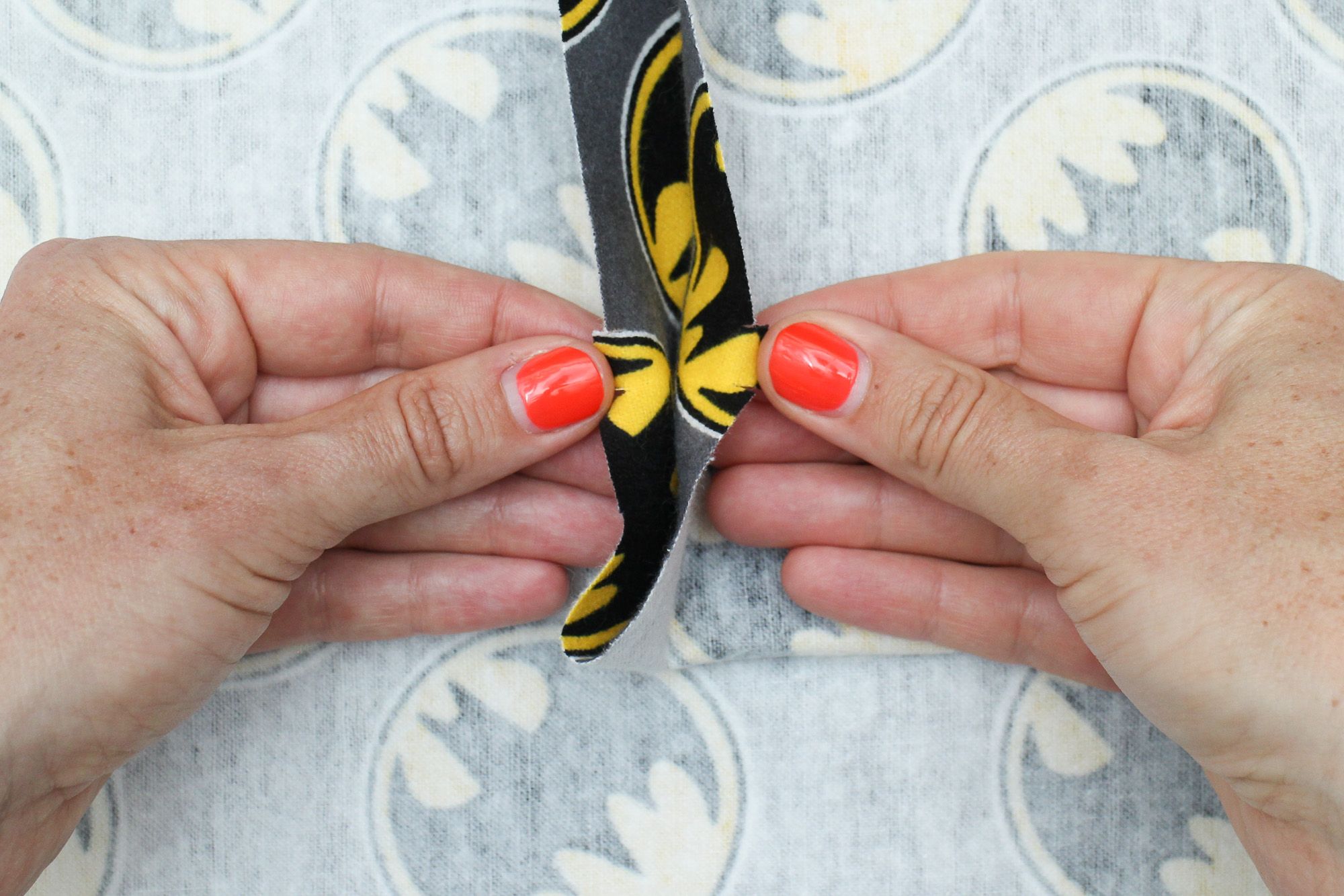

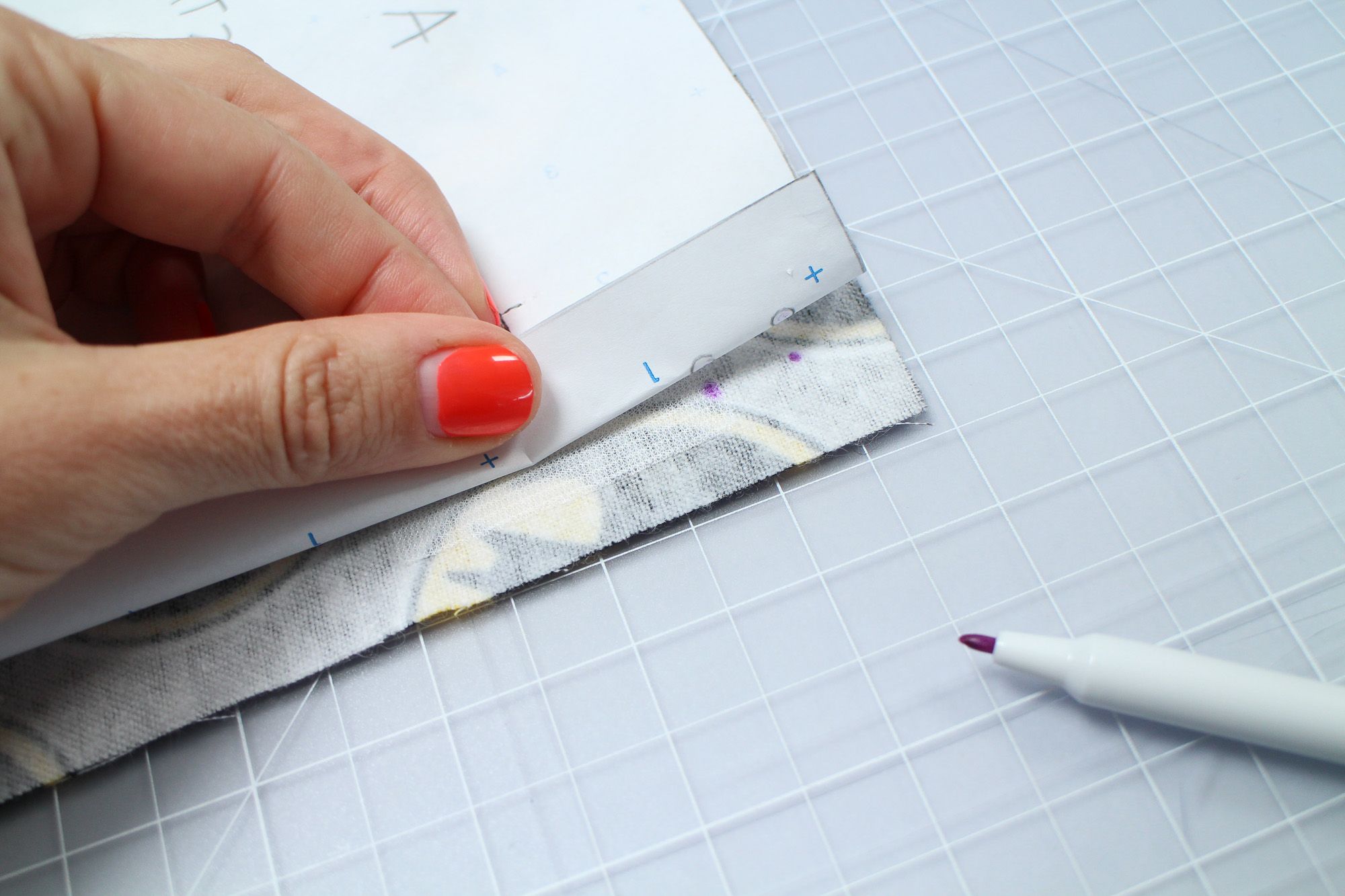

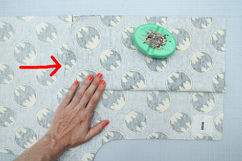

Before we sew the crotch seam, we need to mark one thing I forgot to mark onto the fabric from the pattern earlier. On the center front above the buttonhole, there are two circles marked. These show where you need to leave an opening in the seam that will let you feed the elastic into the waist casing. Mark these two dots on each piece with your disappearing pen.

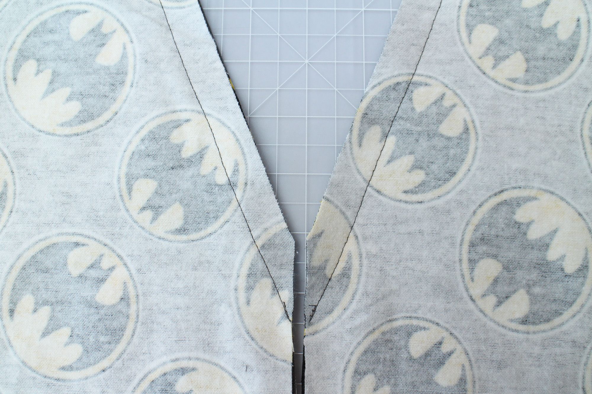

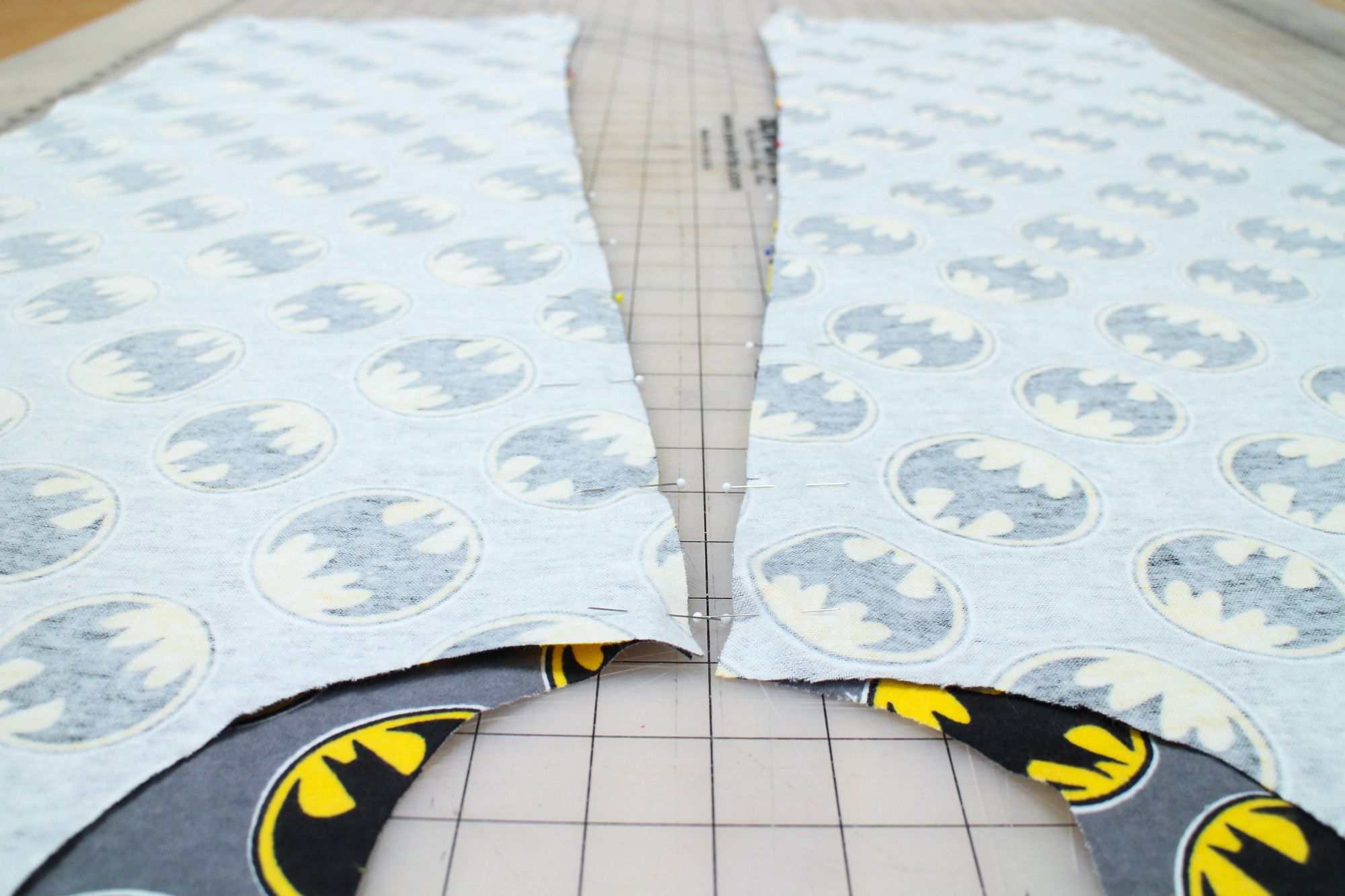

Then open up each front and back leg piece at the inseam, and lay them on top of each other, right sides together like this:
Match the inseams, and pin the crotch seam together.
Sew the crotch with a 5/8" seam allowance, then sew over the same seam again to re-enforce it. Leave the space between the dots un-sewn, sewing and re-enforcing on each side.
Trim the curved part of the seam down to 1/4" so you can press it flat.
Then press the seam open with your iron.

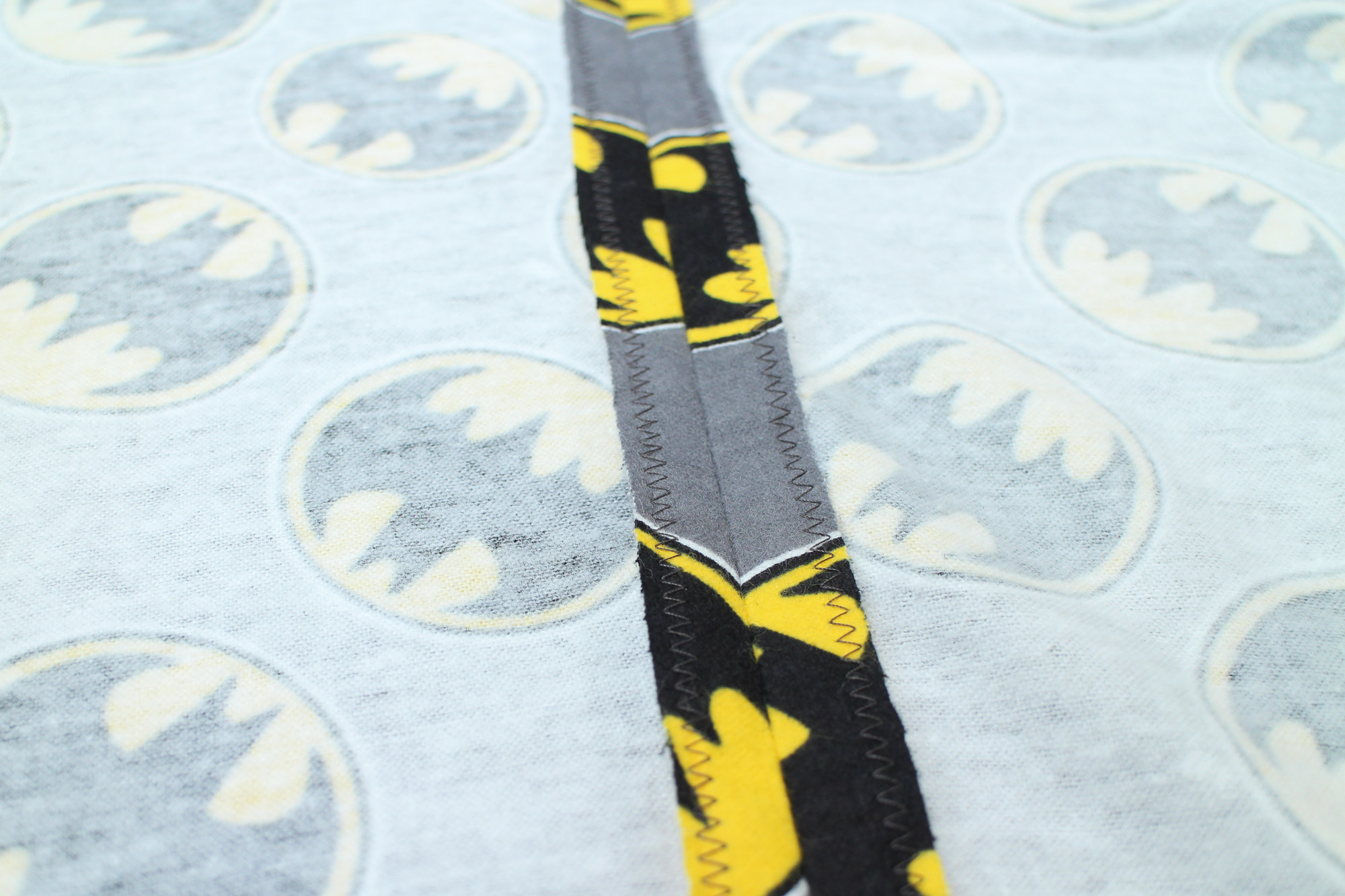

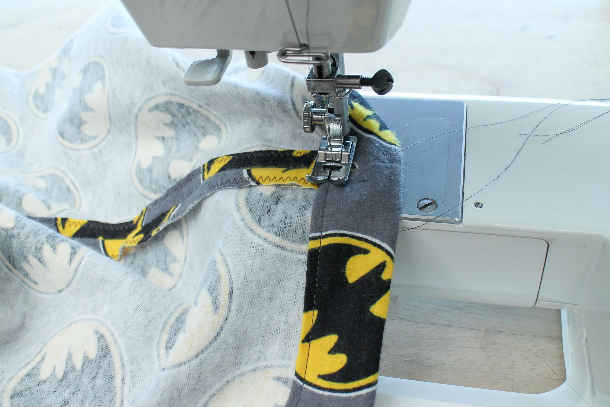

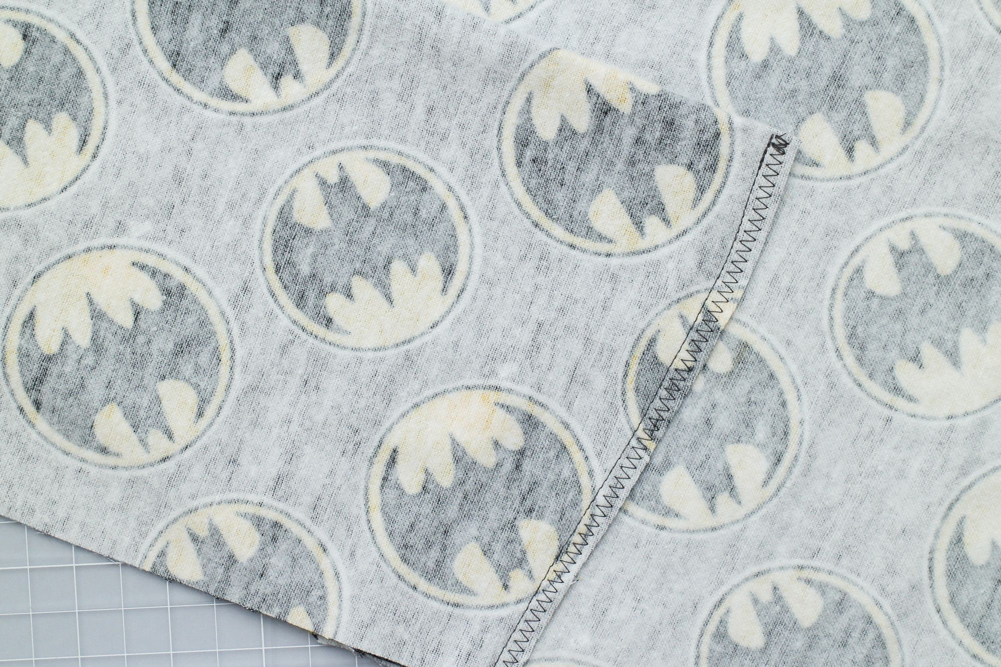

Step 14: Sew the Sideseams

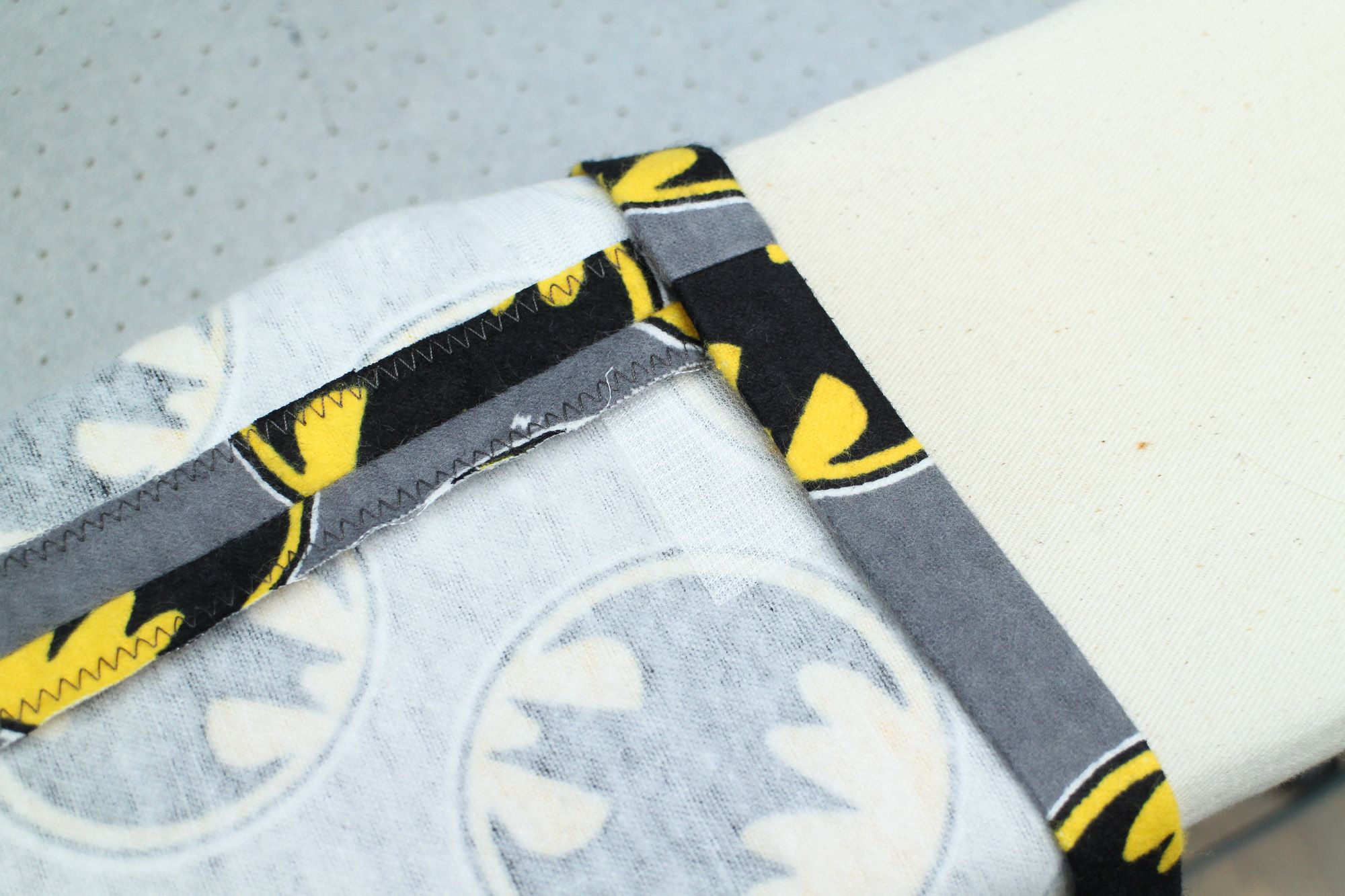

Now match up the seams on the outside of the legs, pin them together, sew them and press them open.
Then zigzag the seam allowances.

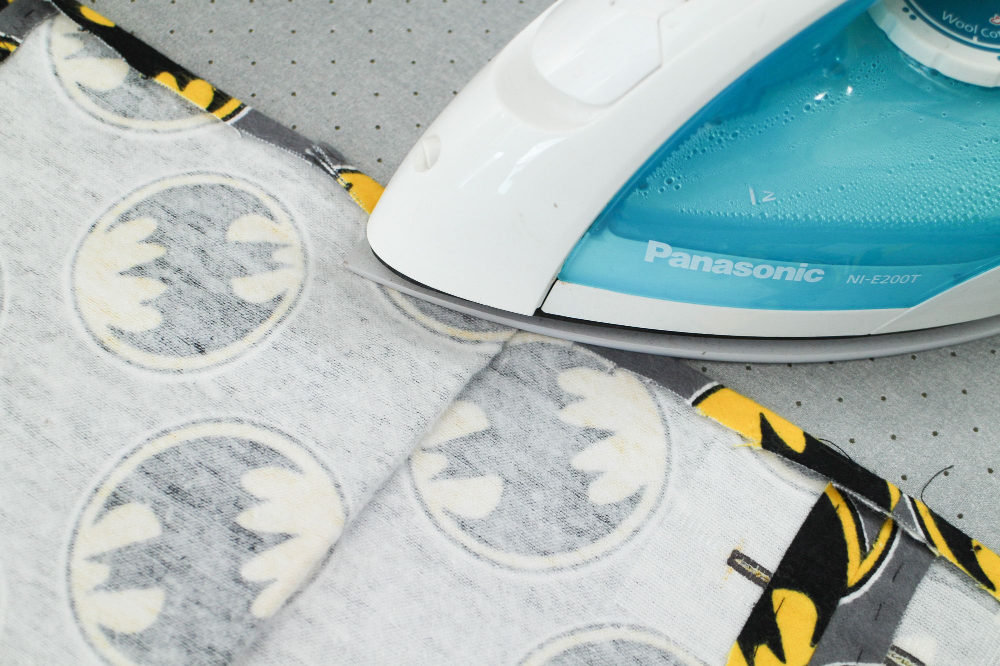

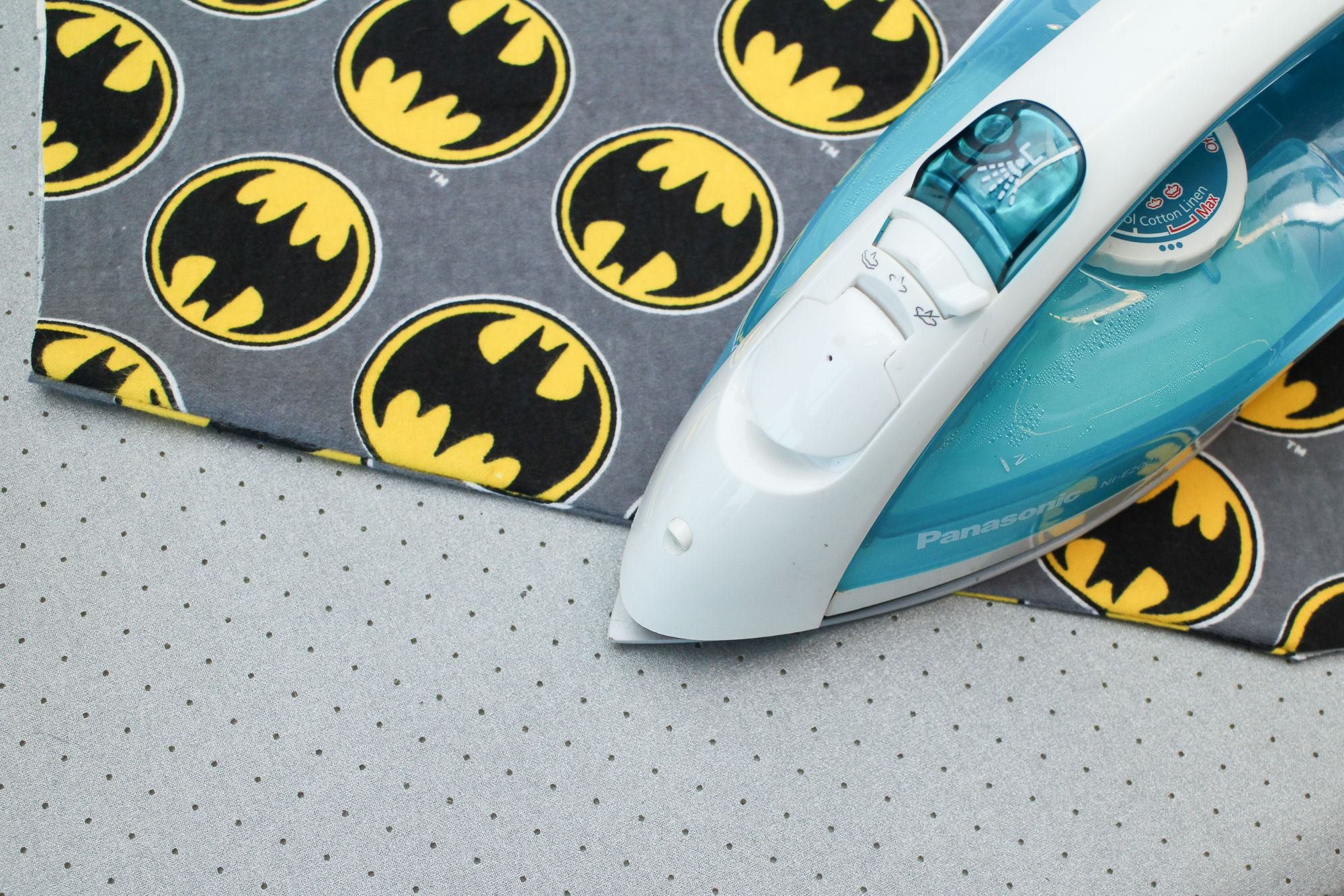

Step 15: Press and Sew the Elastic Channel

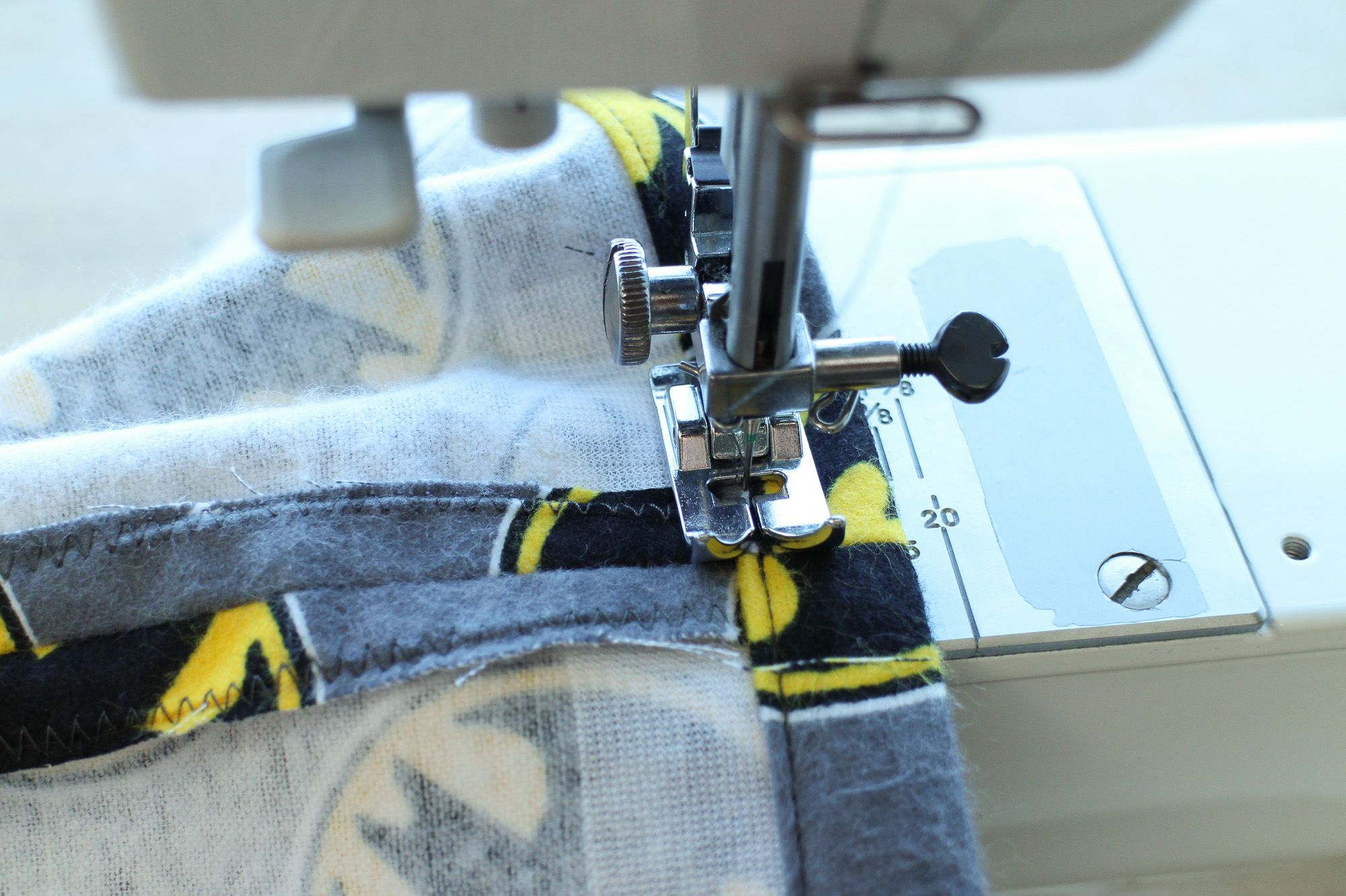

Now we're going to sew the channel on the waistband that will hold the elastic.

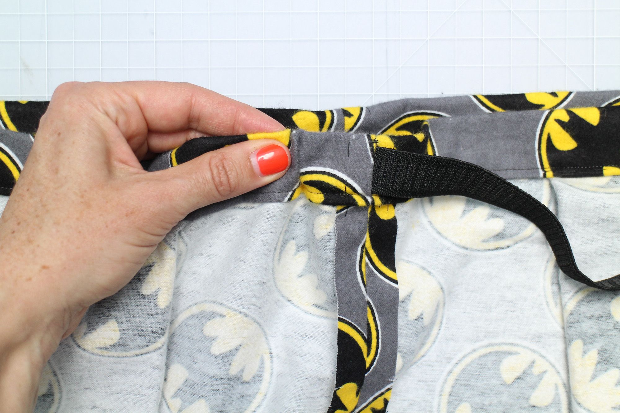

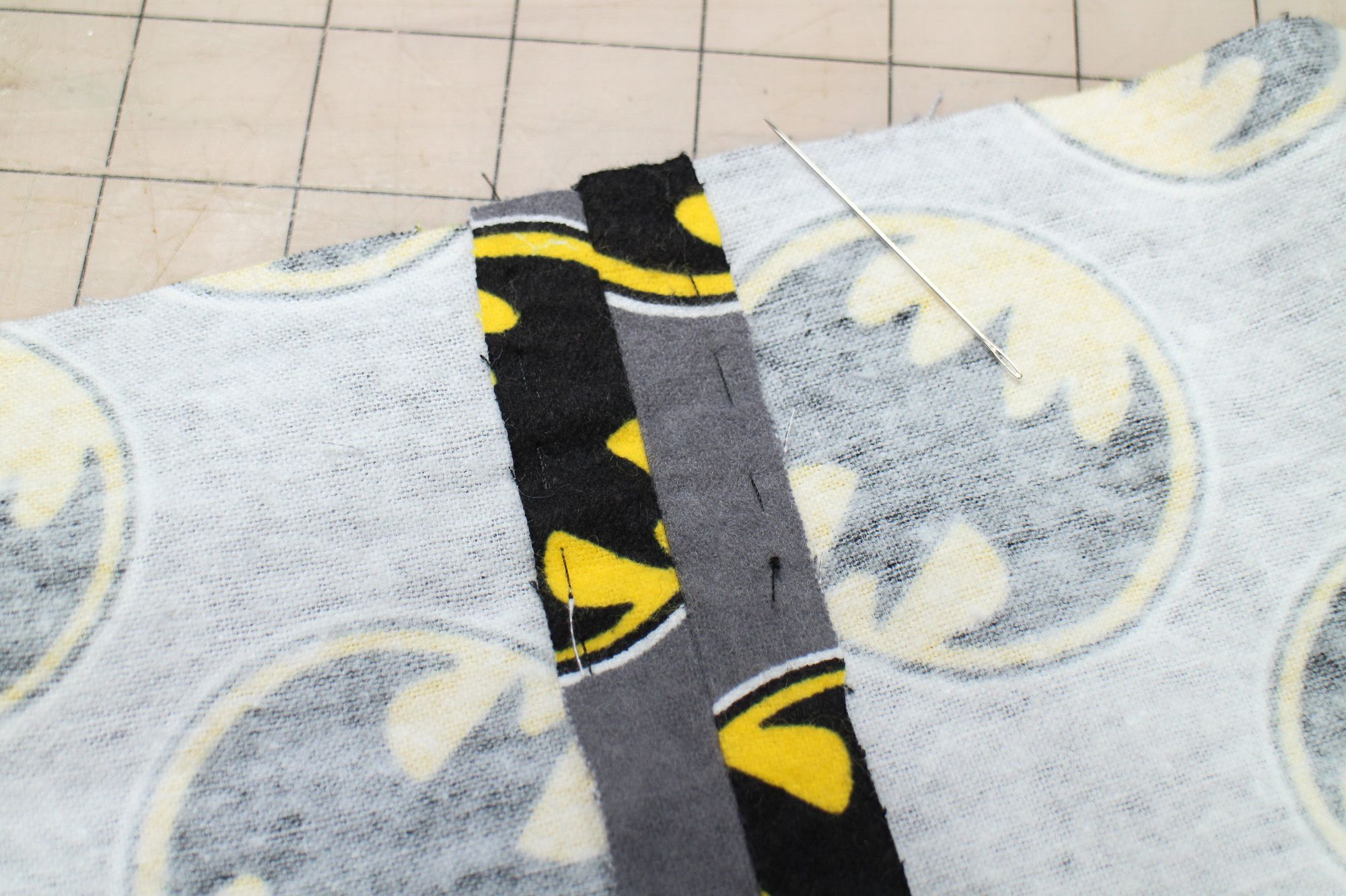

First baste down the tops of the seam allowances in the center front and back about 3" down. The reason you are dong this is so the elastic won't get caught on the seam allowances while you are threading it through the waist casing.
When this is done, take your pants to the ironing board and press the edge of the waist down by 1/4", then again by 1" to create the casing.
Sew the casing on your sewing machine about 1/8" up from the fold.

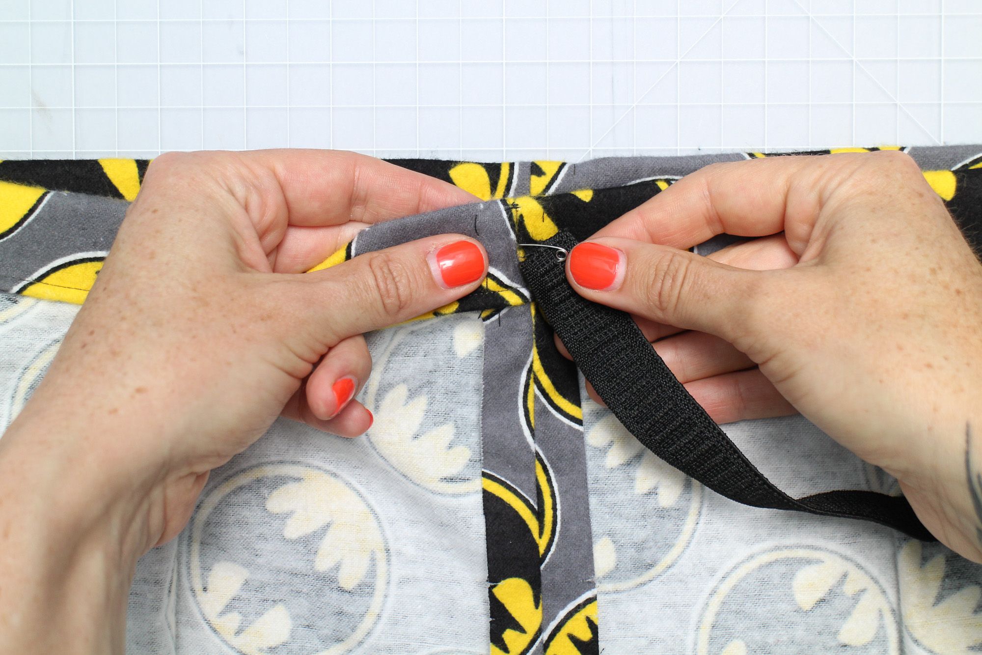

Step 16: Insert the Elastic

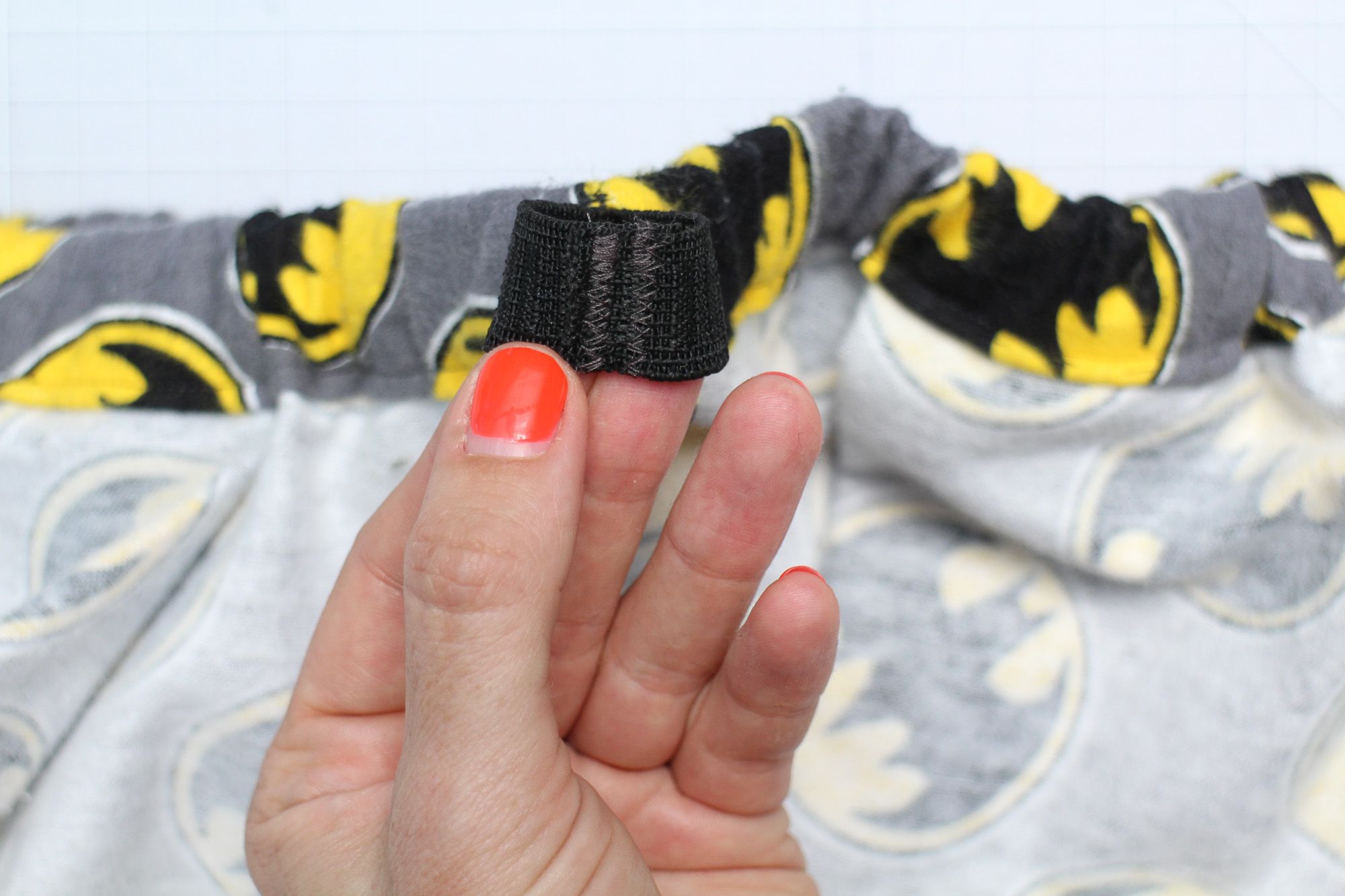

Cut a piece of elastic about 2-3 inches shorter than your waist.
Then use the safety pin trick to insert the elastic into the waist casing through the opening you left in the center front seam.
Overlap the ends of the elastic and sew them together. Then tuck them back into the channel.
Try the pants on to see if the waist is the right size, if it's way too loose, you can cut the elastic and make it shorter.

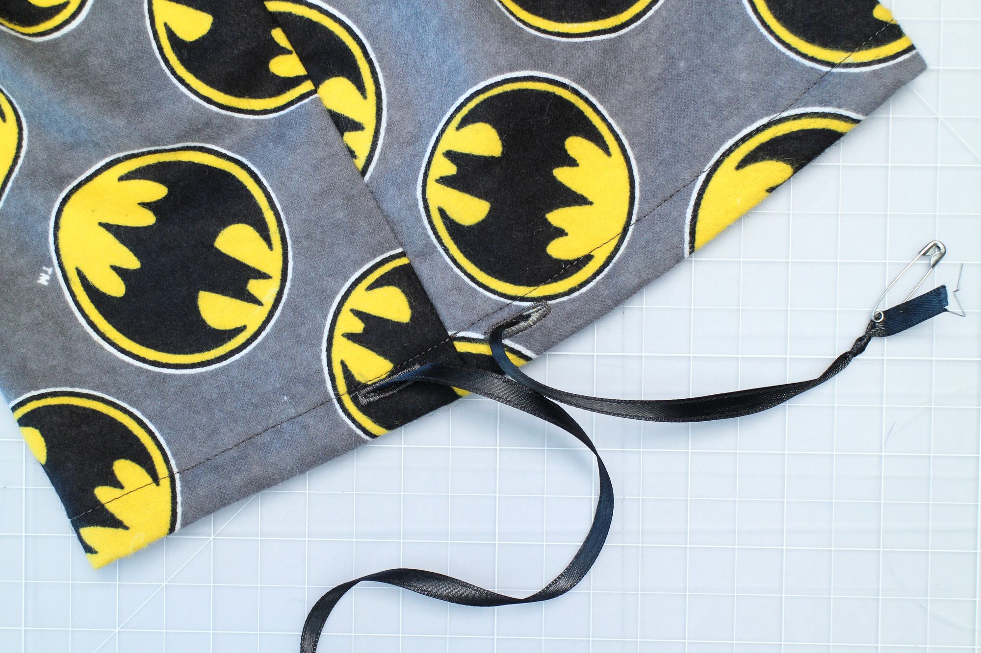

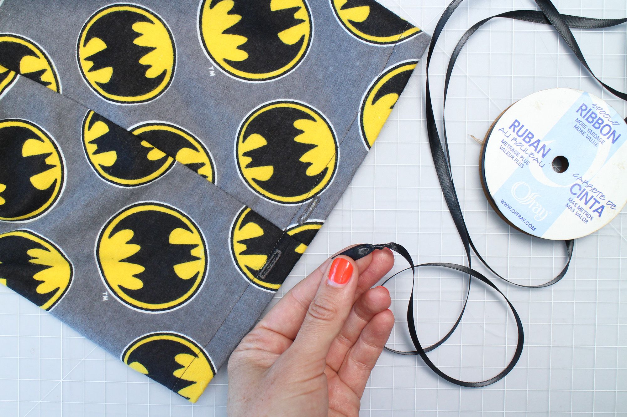

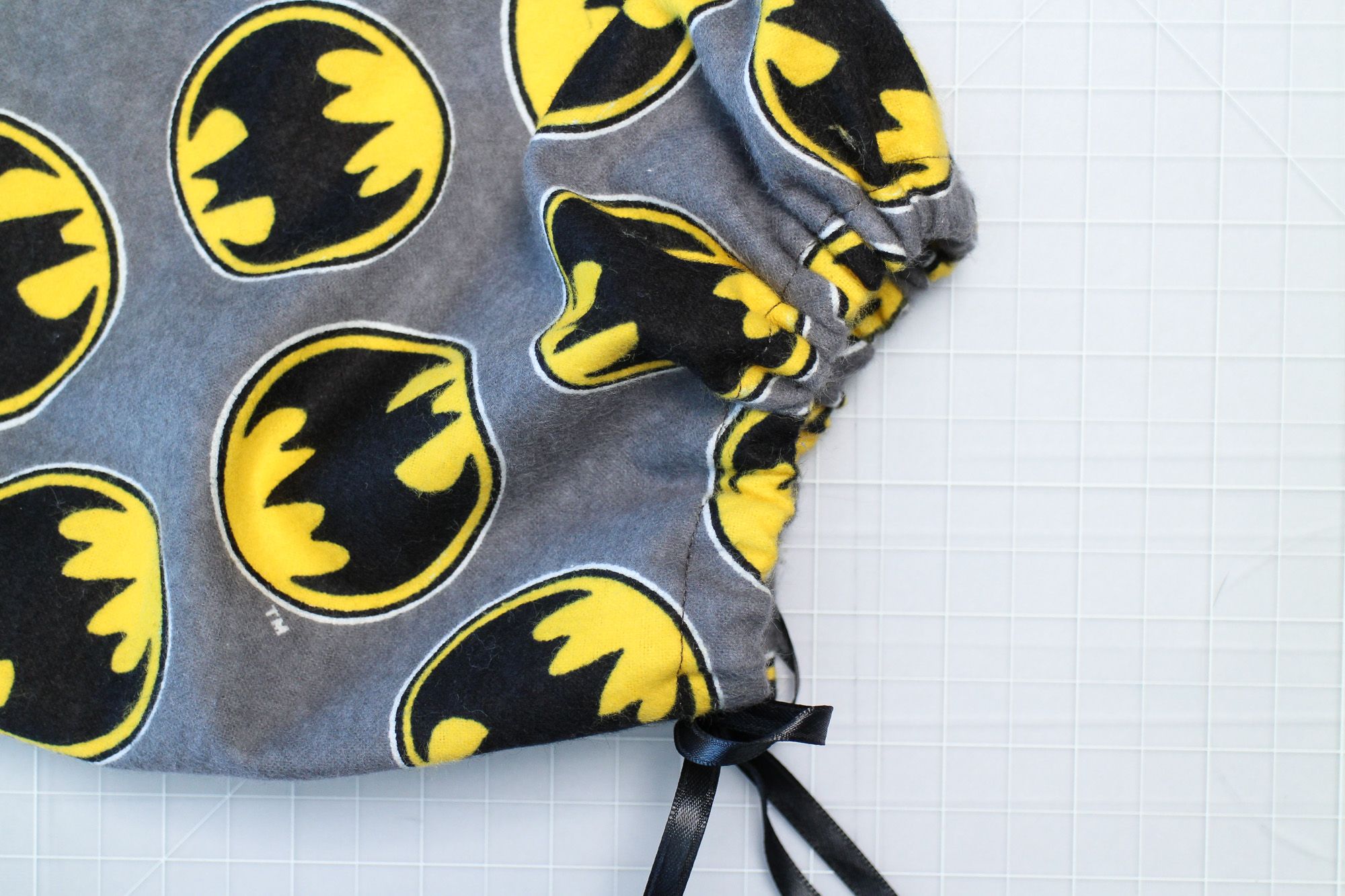

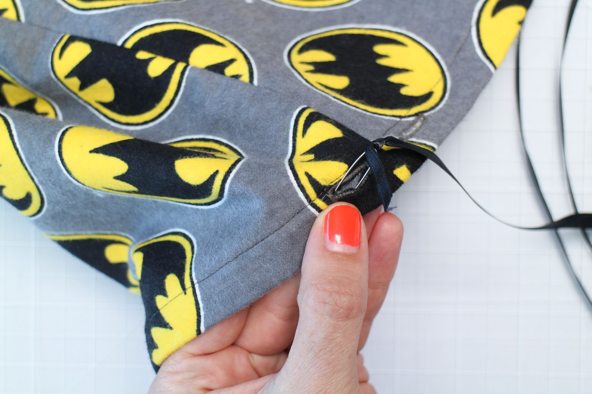

Step 17: Make the Ankle Channels and Insert the Ribbons
Now make similar casings on each ankle by pressing the hem up 1/2" and then another 1/2".
Then sewing next to the fold.
Instead of inserting elastic here, we are just going to insert a ribbon that you can tie and untie to cinch the ankles. Use the same safety pin technique you used with the elastic, and insert the ribbon through the buttonholes you created earlier.
Leave a few inches extra on each end of the ribbon with a knot to keep the ends from fraying.
Now do the same thing around the waist inserting the ribbon over the elastic, and tying a bow in the front.
