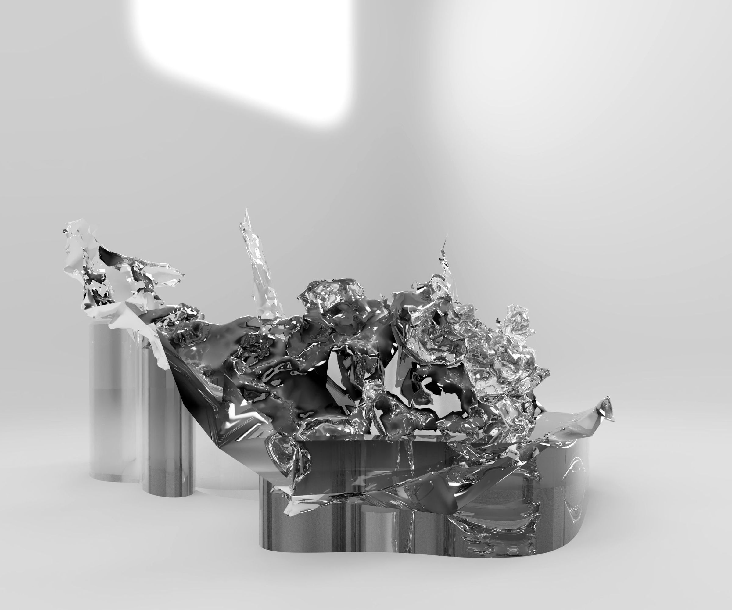

Step 3: Take Out the Unnecessary Part Based on the New Mesh
I was trying to use curves to draw the difference between the generated models and the original ones, took out the extra parts -

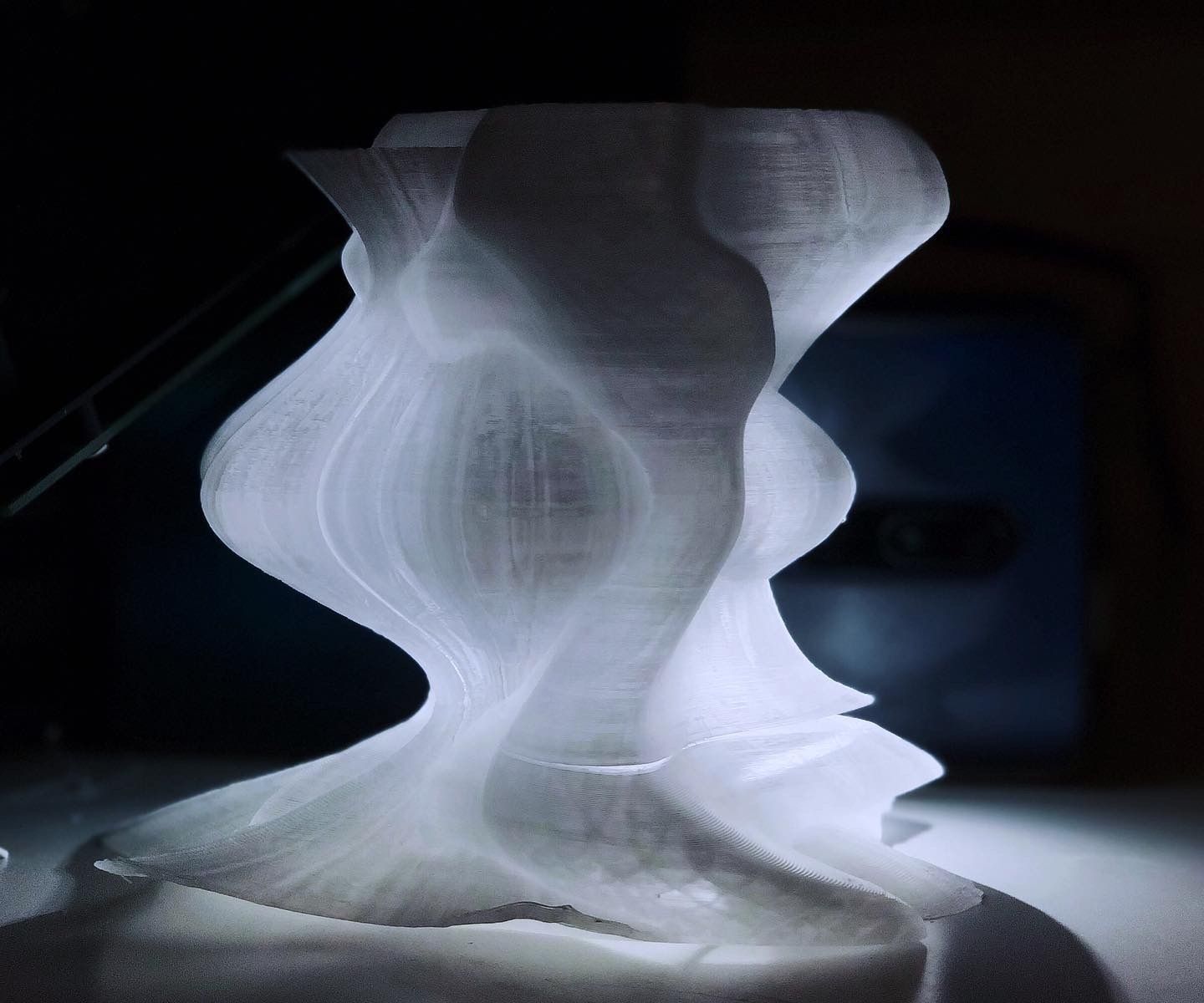

Step 4: Render! and 3d Print
when I print I add tree support - thanks to our fellow Philip to share the tree support trick - which helps me to successfully print this model
