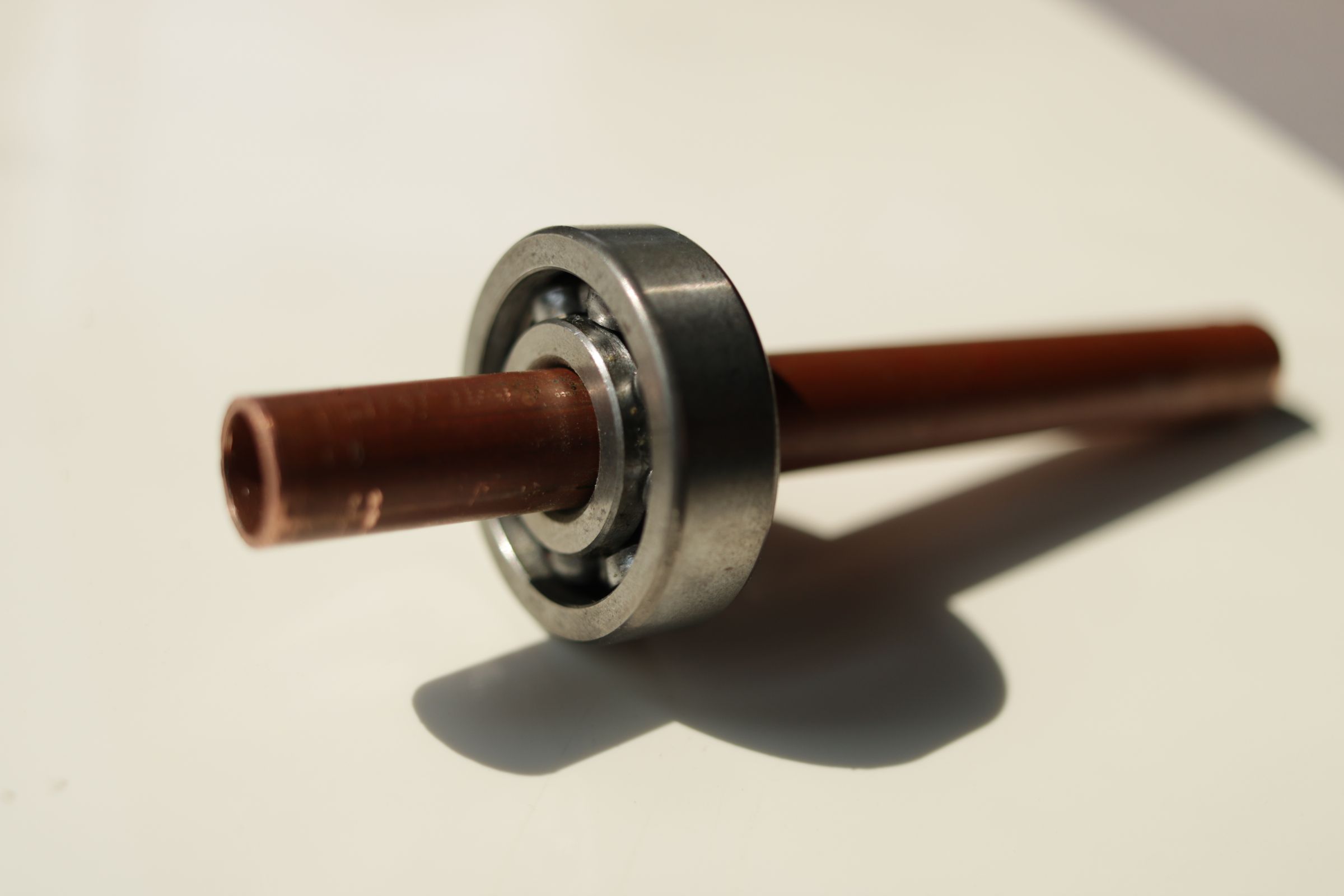

The main shaft is made from a copper tube the material is not very important but it must be a tube, you will understand why later. It has a diameter of 10mm because I had some 10-30-9 bearings (those may be oversized but it results in a very reliable revolute joint)

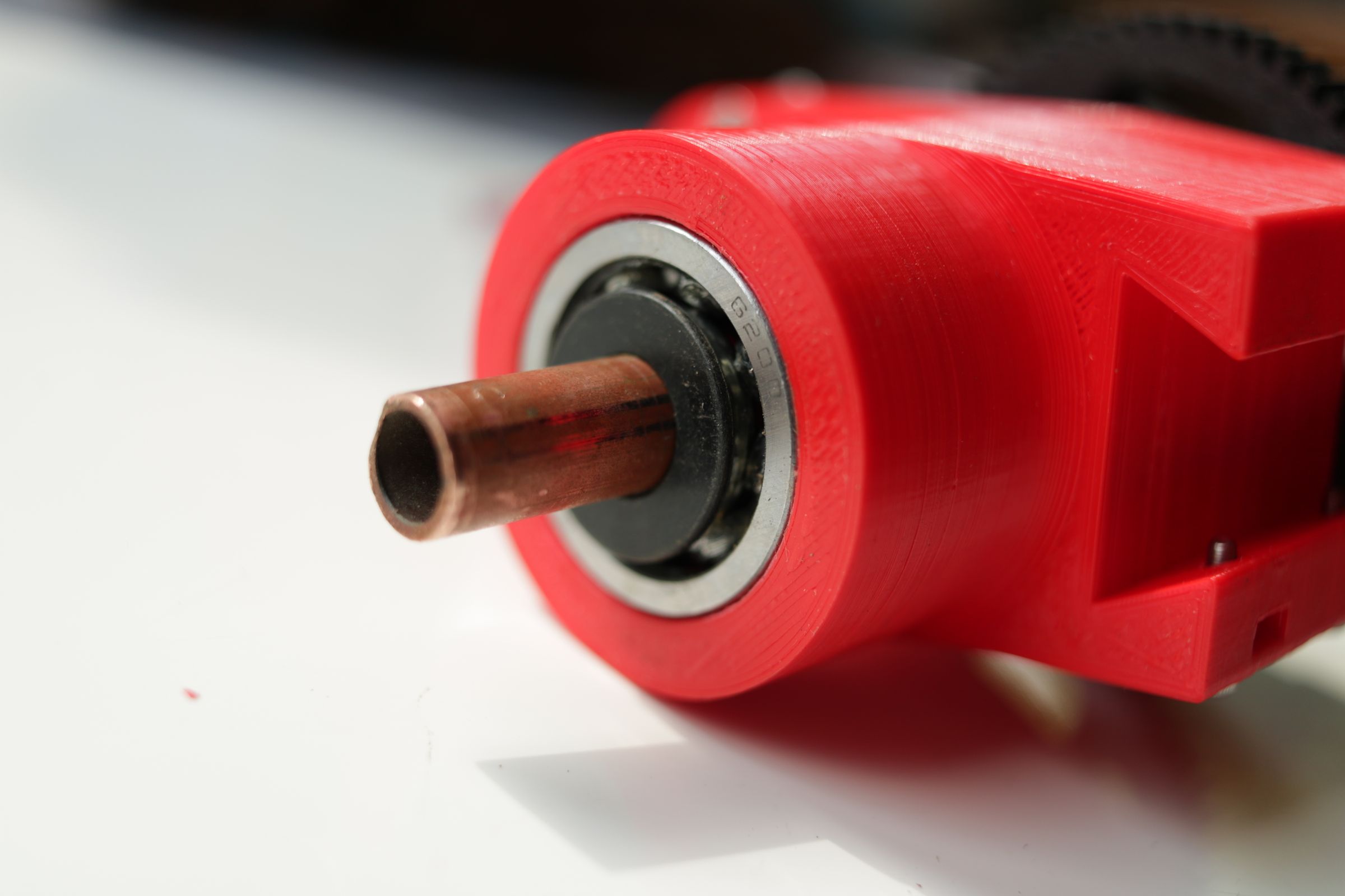

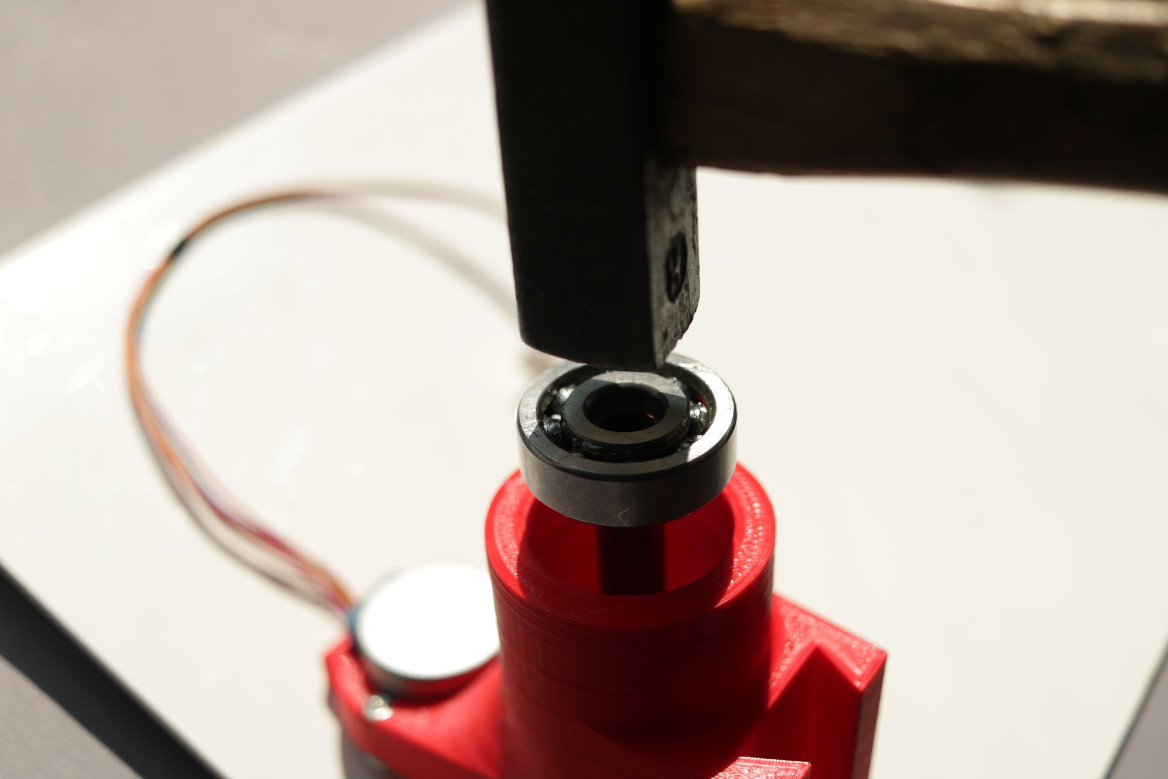

- Screw the motor in place with 2x M2.5 screws + nuts

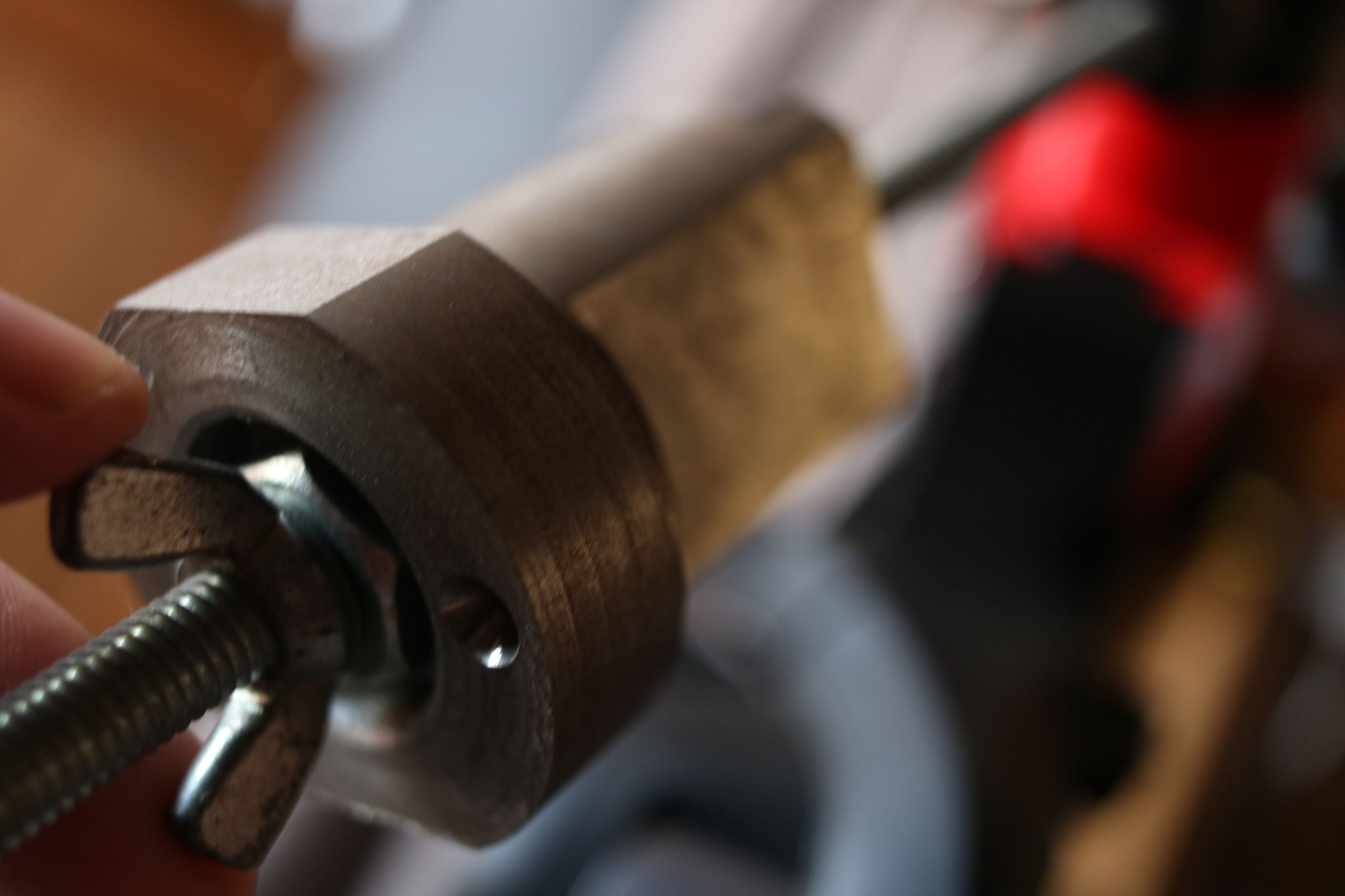

- Hammer the bearing on the tube, 20mm from the end
- Place those in the corresponding hole of the main body (red piece)
- Hammer the second bearing on the top
- Place a washer or anything that can be a spacer here

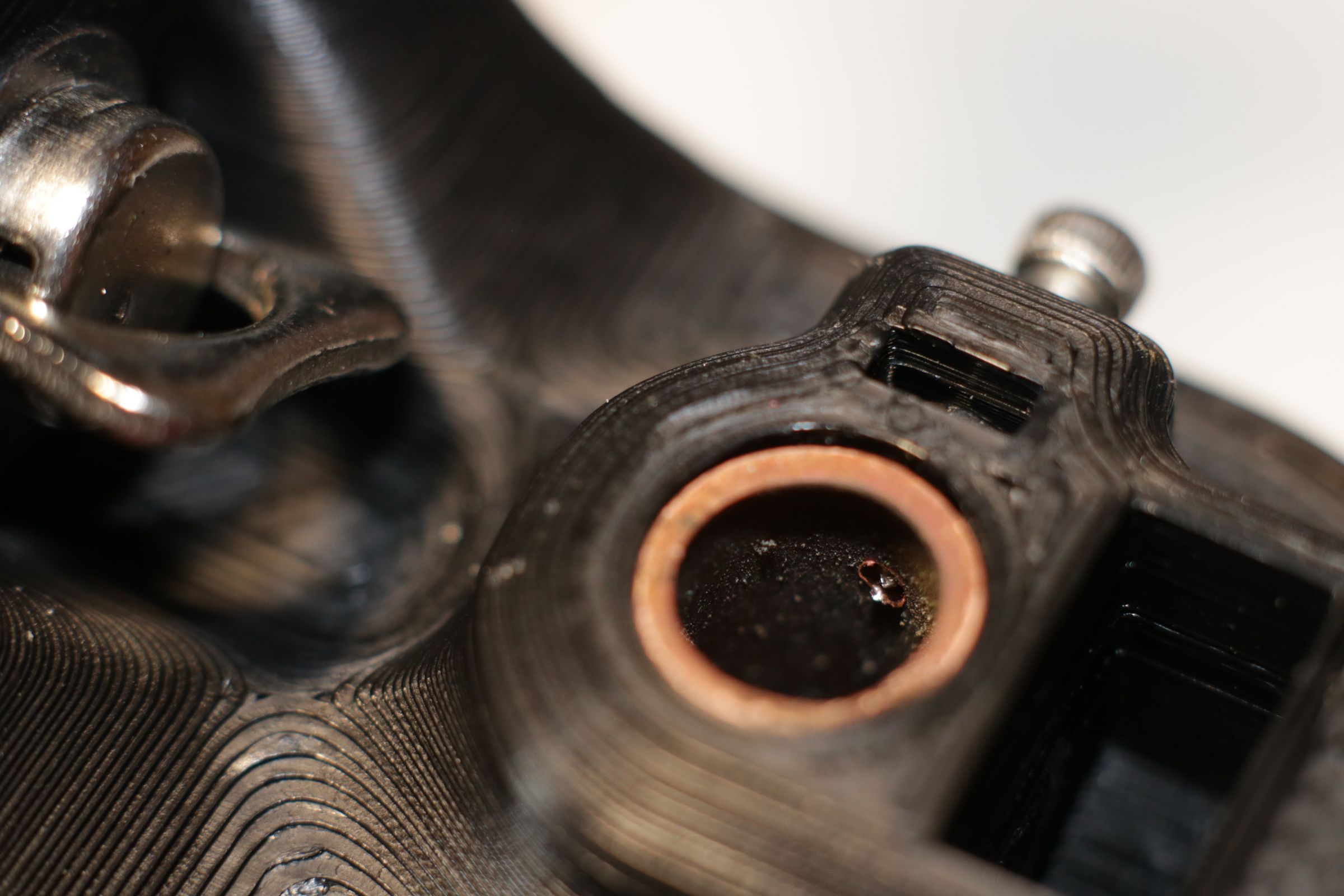

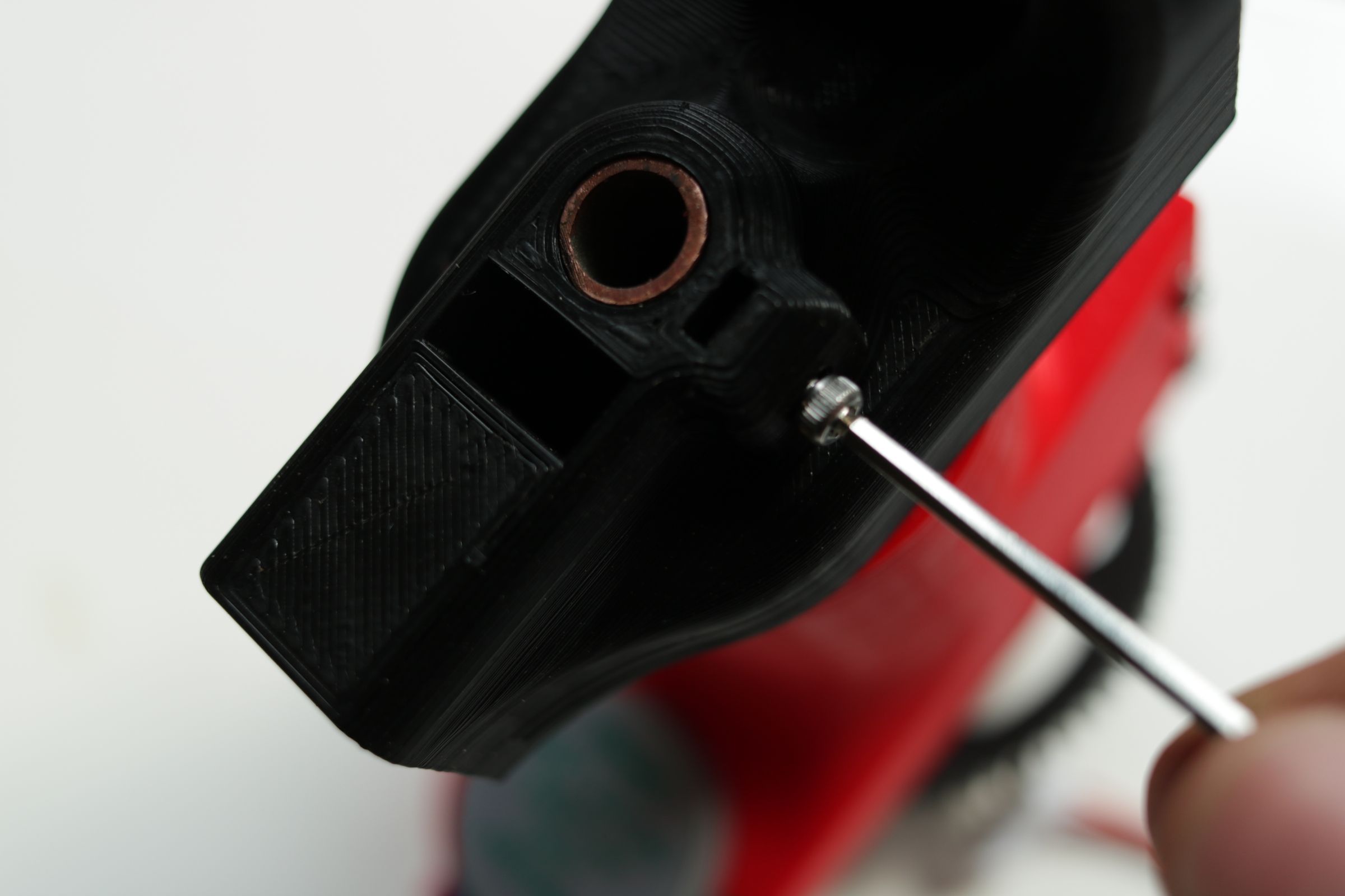

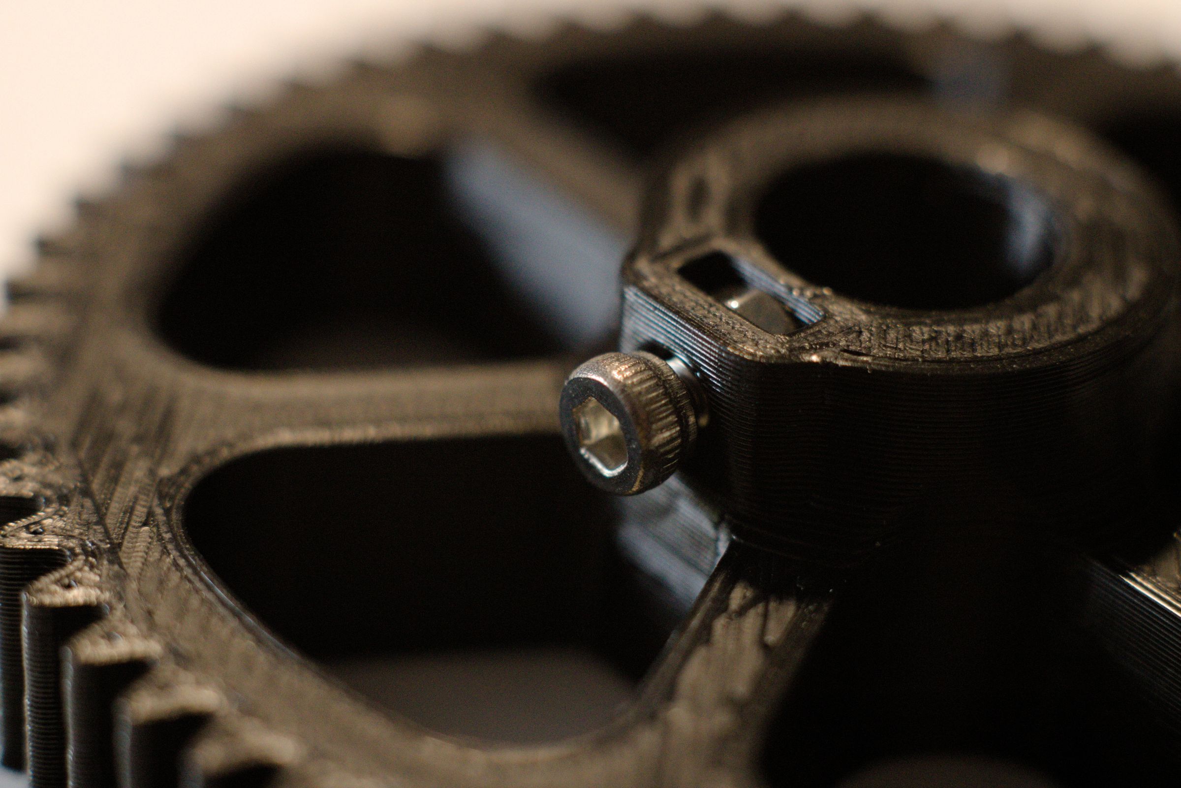

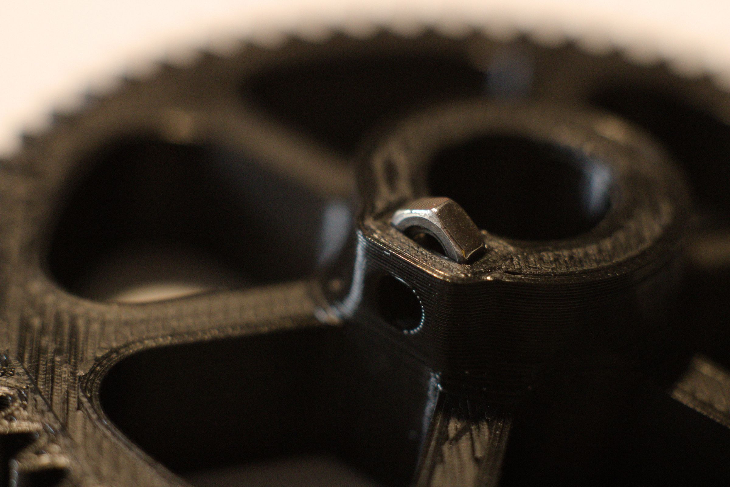

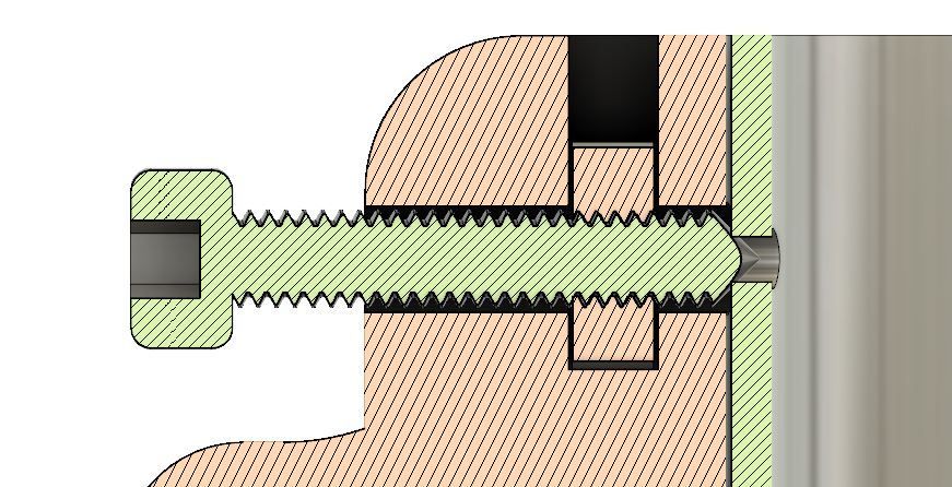

- Insert 4x M2.5 nuts where it is needed (here is the example on the big gear wheel)

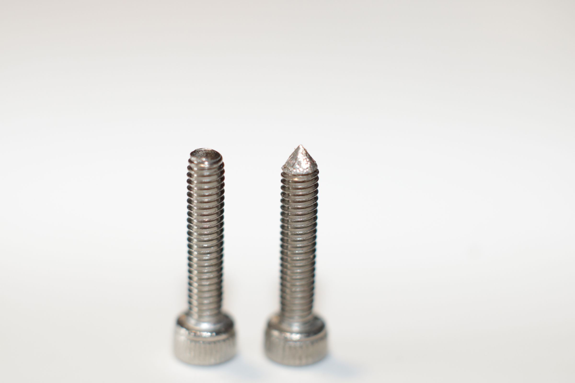

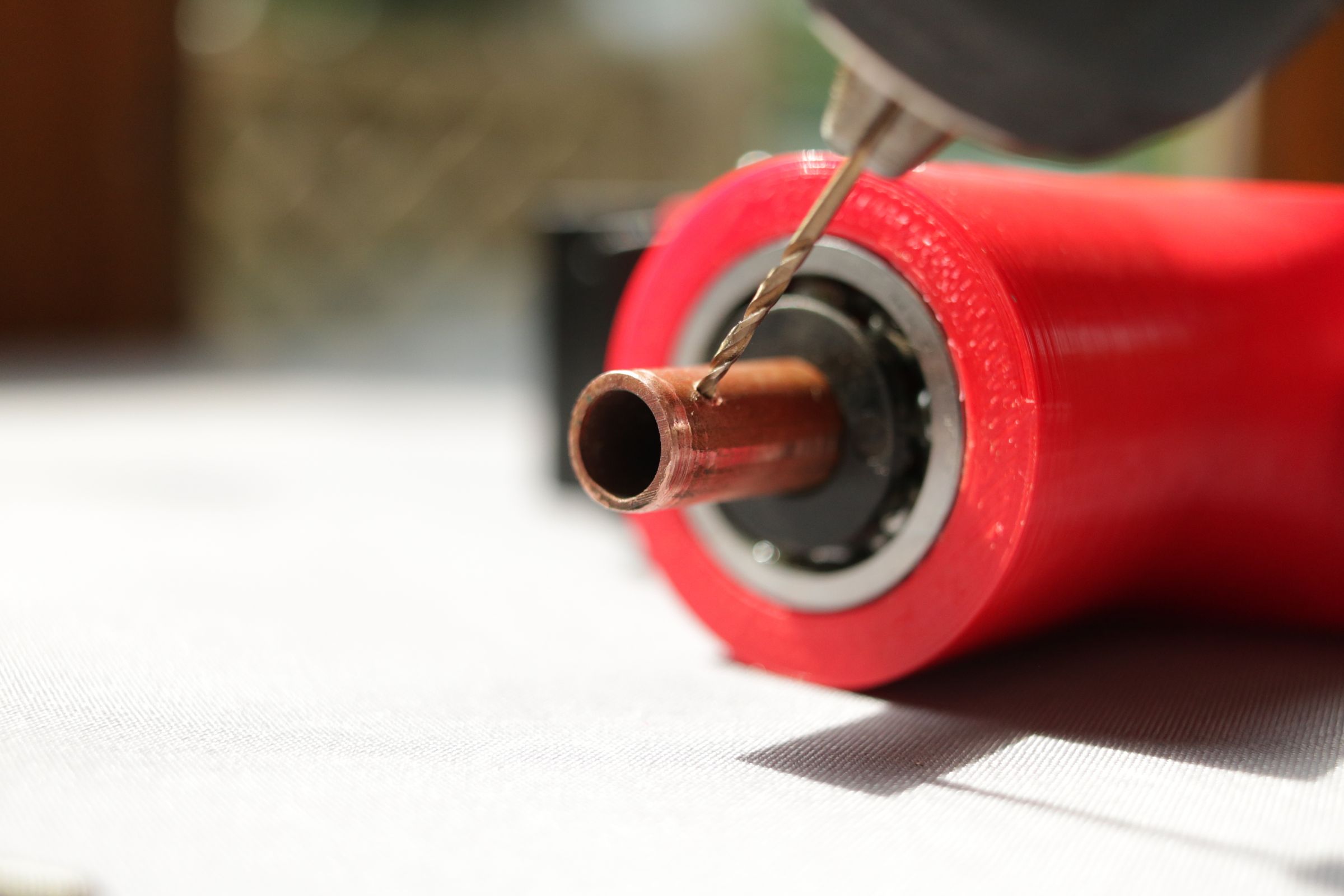

- Screw the big wheel and the support on the tube, tight them enough to make a mark on the tube
- Remove those 2 pieces and drill 2 holes at the marks
- Sharpen the end of 2 screws

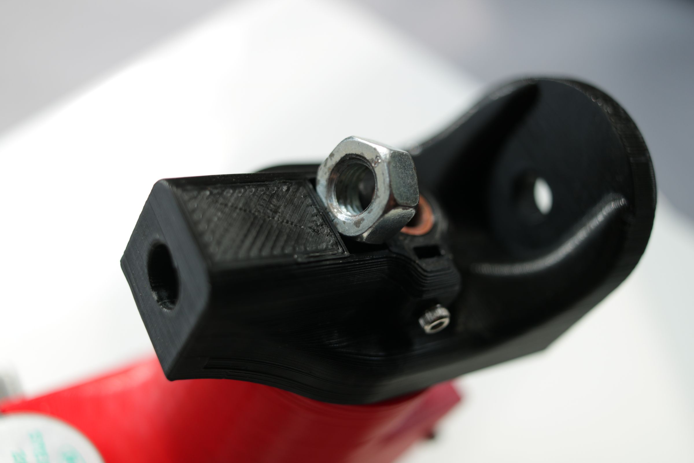

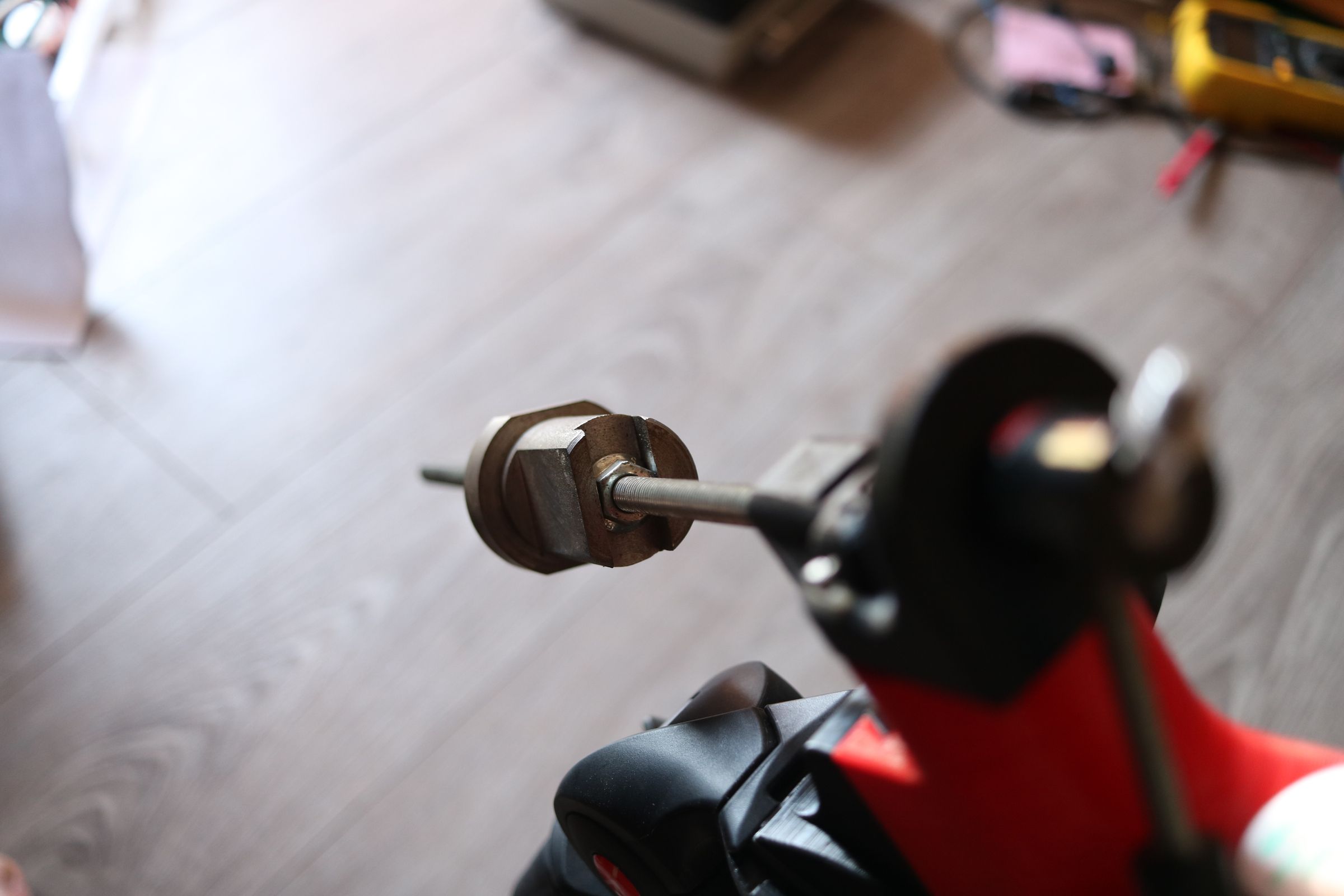

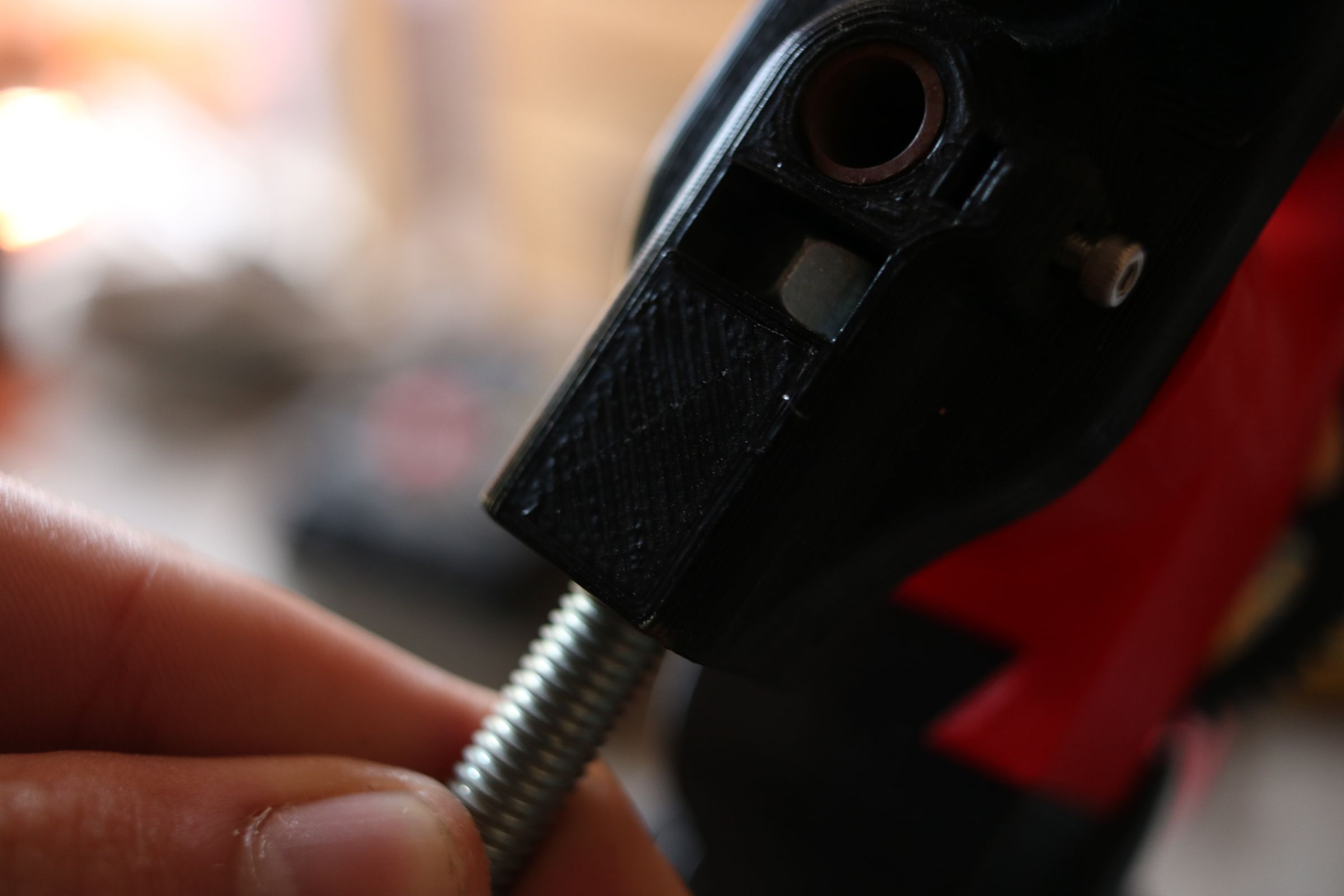

- Insert the M8 nut into the support piece
- Screw the M8 threaded rod

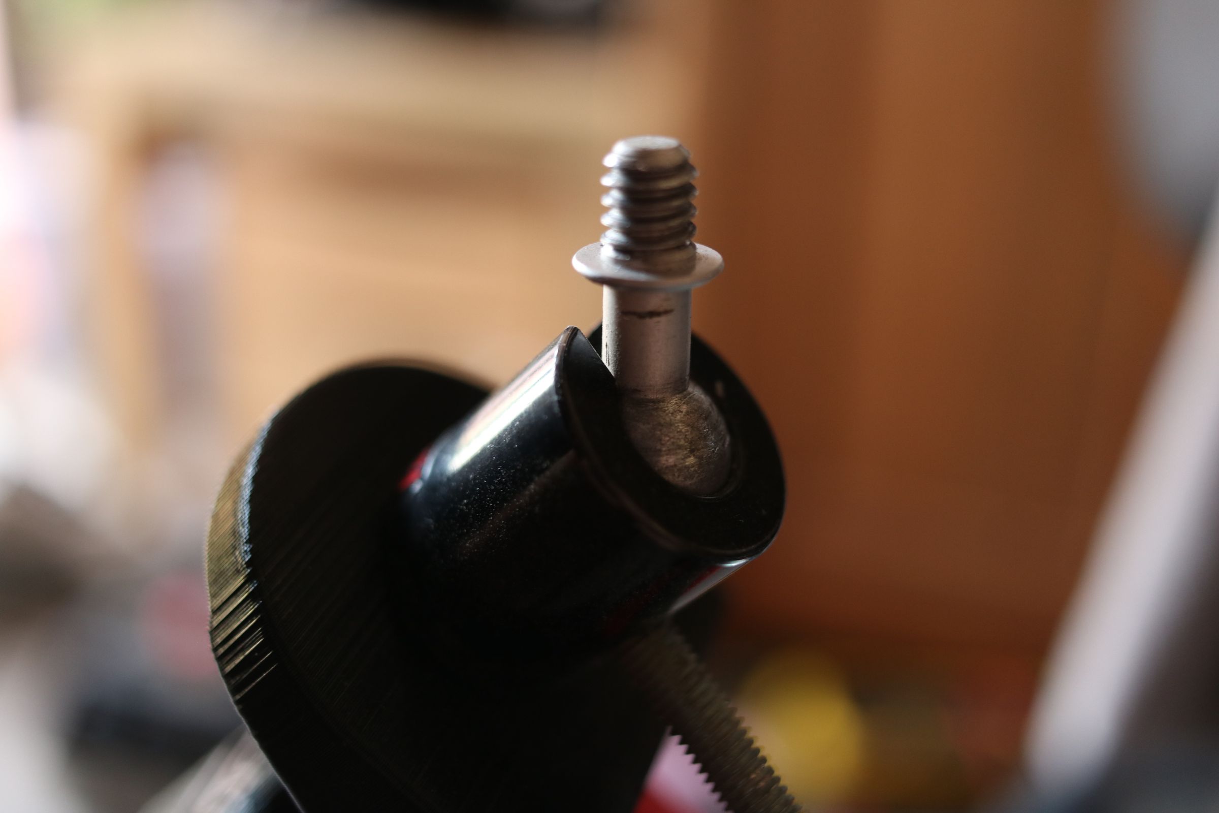

- Screw a camera ball joint with a Kodak screw
- Add counterweight on the threaded rod to balance the mass of the DSLR

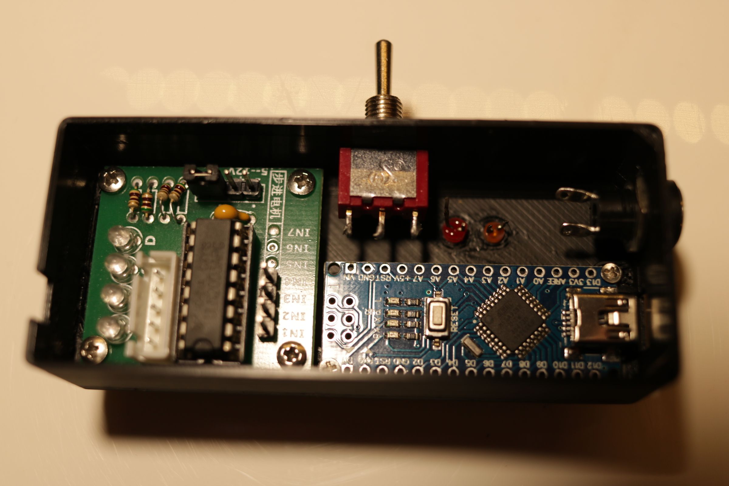

Step 6: The Controller

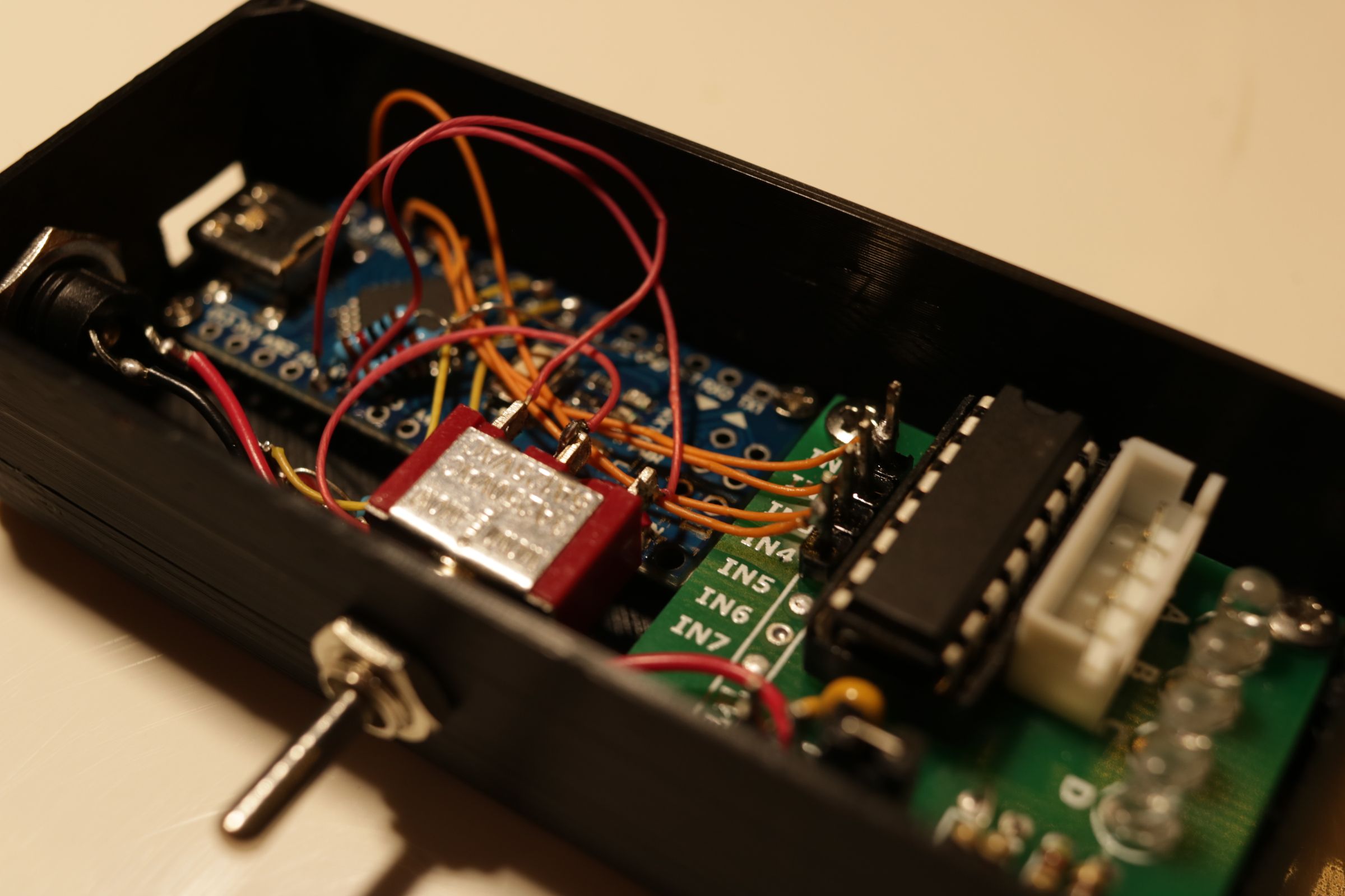

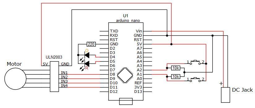

Once printed, screw in place the two PCB (Arduino + ULN2003 driver) and place the components in the box.
Solder wires according to this schematic:
Then plug the motor and clip the lid on the box

- Place the star tracker on the tripod (tube pointing to the north).
- Screw the DSLR on the ball joint, and add the counterweights on the other side.
- Remove the small gear wheel from the motor to release the axis.
- Then adjust the counterweight to balance the rotating part, and put back the small gear wheel.
- Look into the tube and adjust the head of the tripod the see the North Star into it (you can also use a laser through the tube).

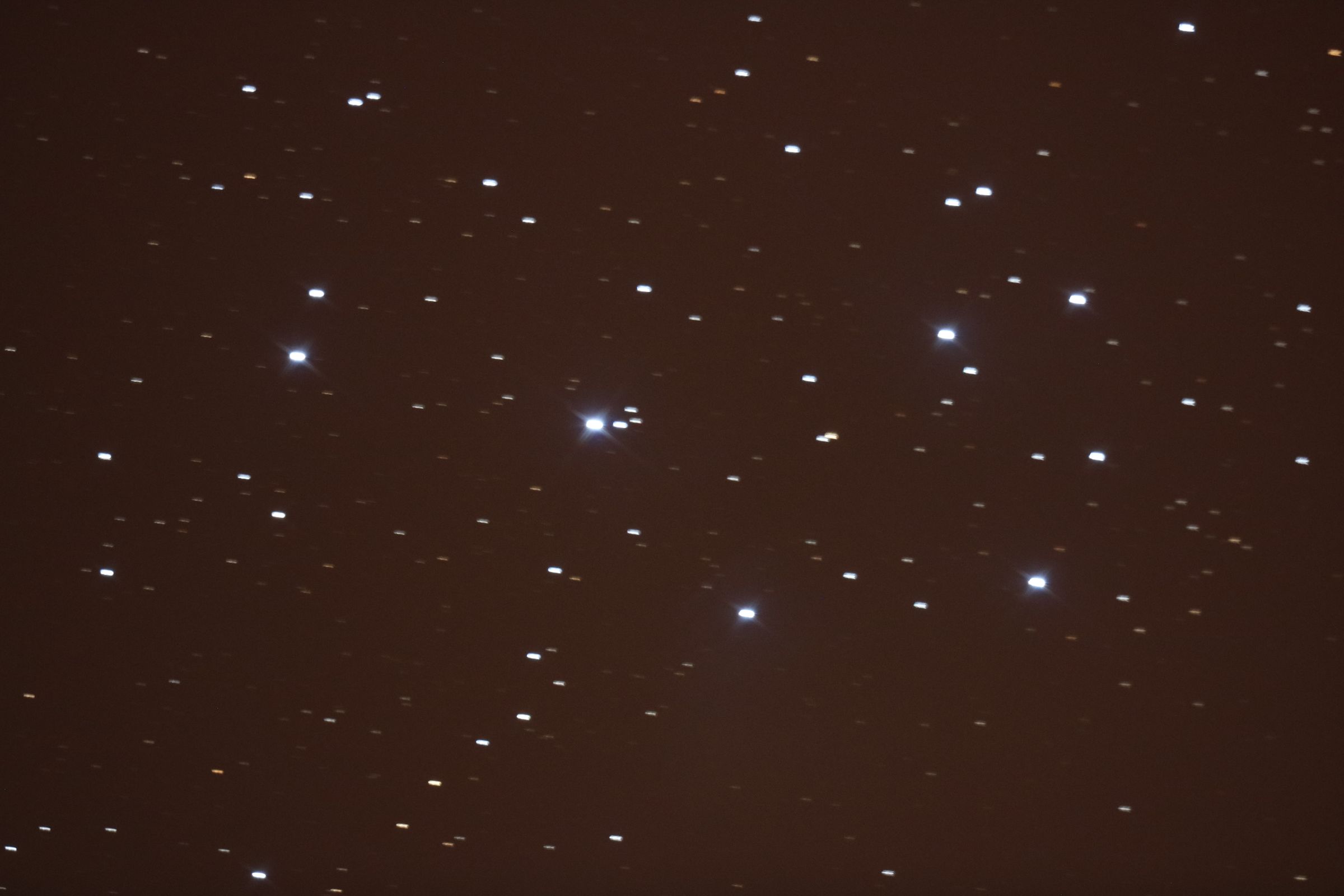

Here is my first photography with the mount :
Here is a picture of th milky way,
Canon 750D, Equatorial mount, Canon 18-55mm stm (at 27mm), f/4, iso1600, 196s
You can see that even at 196s exposure, stars stays dots (except in the corners due to chromatic aberations) however there is a motion blur on the trees. If you want them sharp too, you will have to add a motionless picture of your foreground and mix those into Photoshop or Gimp.
on the picture we can easely notice some deep sky objects:
